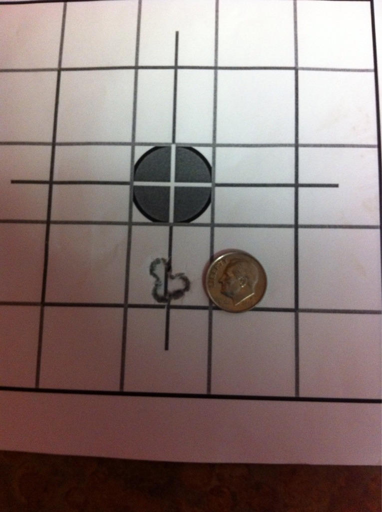

How many rounds will I get out of this factory tube? I was going to send this thing to be rebarreled with something fancy, and have the action trued, but I don't really see any use at this point. Have any fellow Hiders had similar results with factory barrels and how long can I run this thing before accuracy starts to fade?
I'd say yes I've had similar results with my rem 700 BDL 7mm RM.
This is a 5-shot group at 100yds with my 7mm RM. I love this gun.
Sent from my iPhone using Tapatalk
That is awesome. Im glad to see this kind of accuracy without spending a fortune or a 20 lb rifle.
