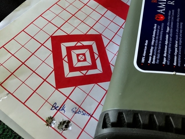

I know Beck has several 308 loads but the 208gr A-Max resulted in .5 or so. Shot some AWC subsonic 175 gr today and it's consistently around 1". Also tried some Tubb 200gr but results were unfavorable.
Thanks for the info. I bought a few boxes of Becks not sure if I have the 208s or not. I need to test them.

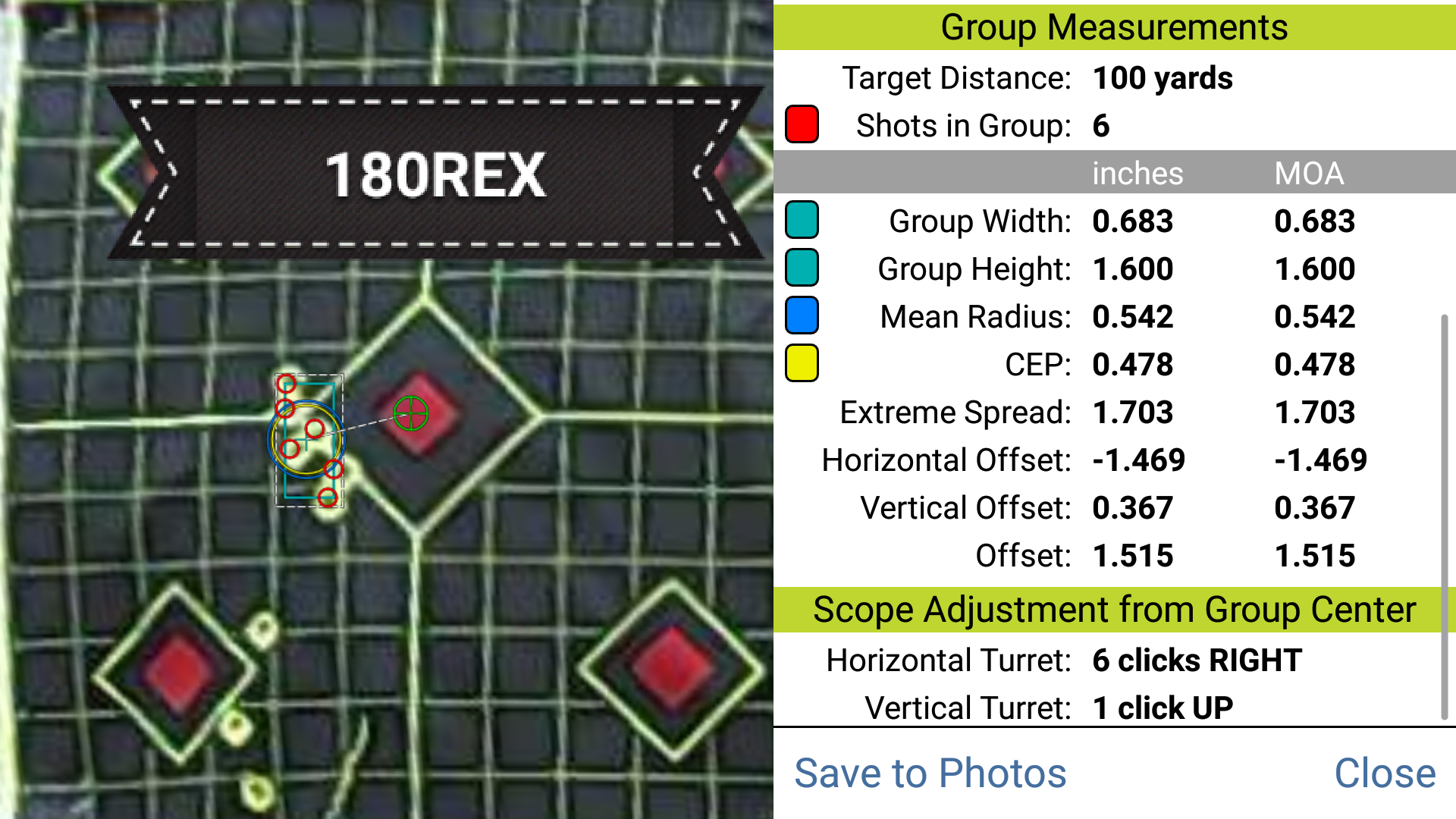

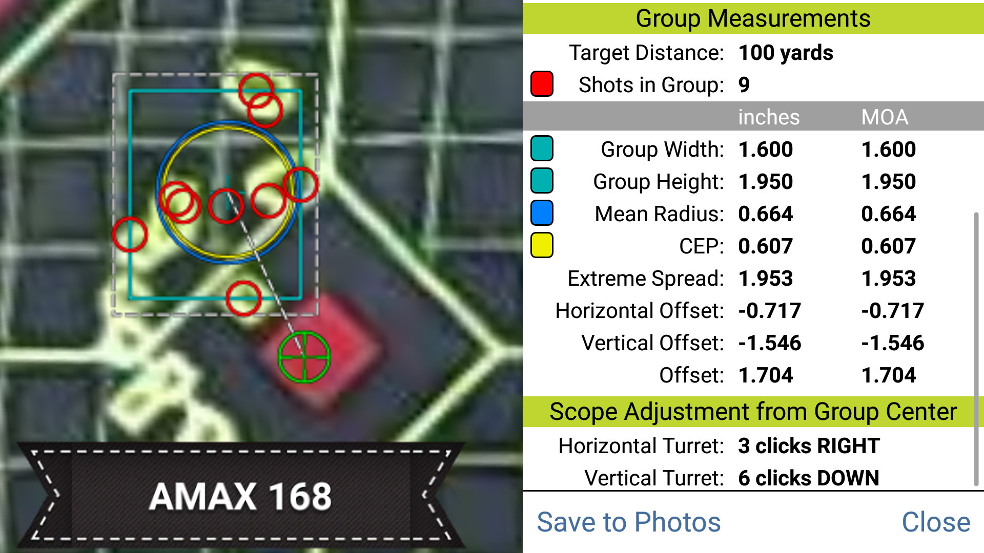

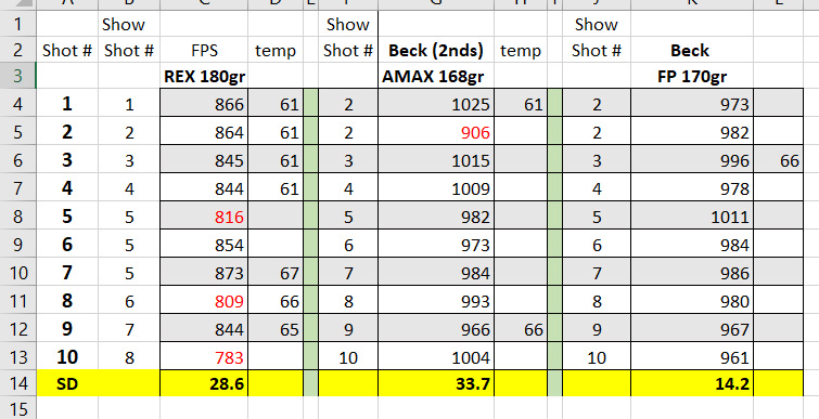

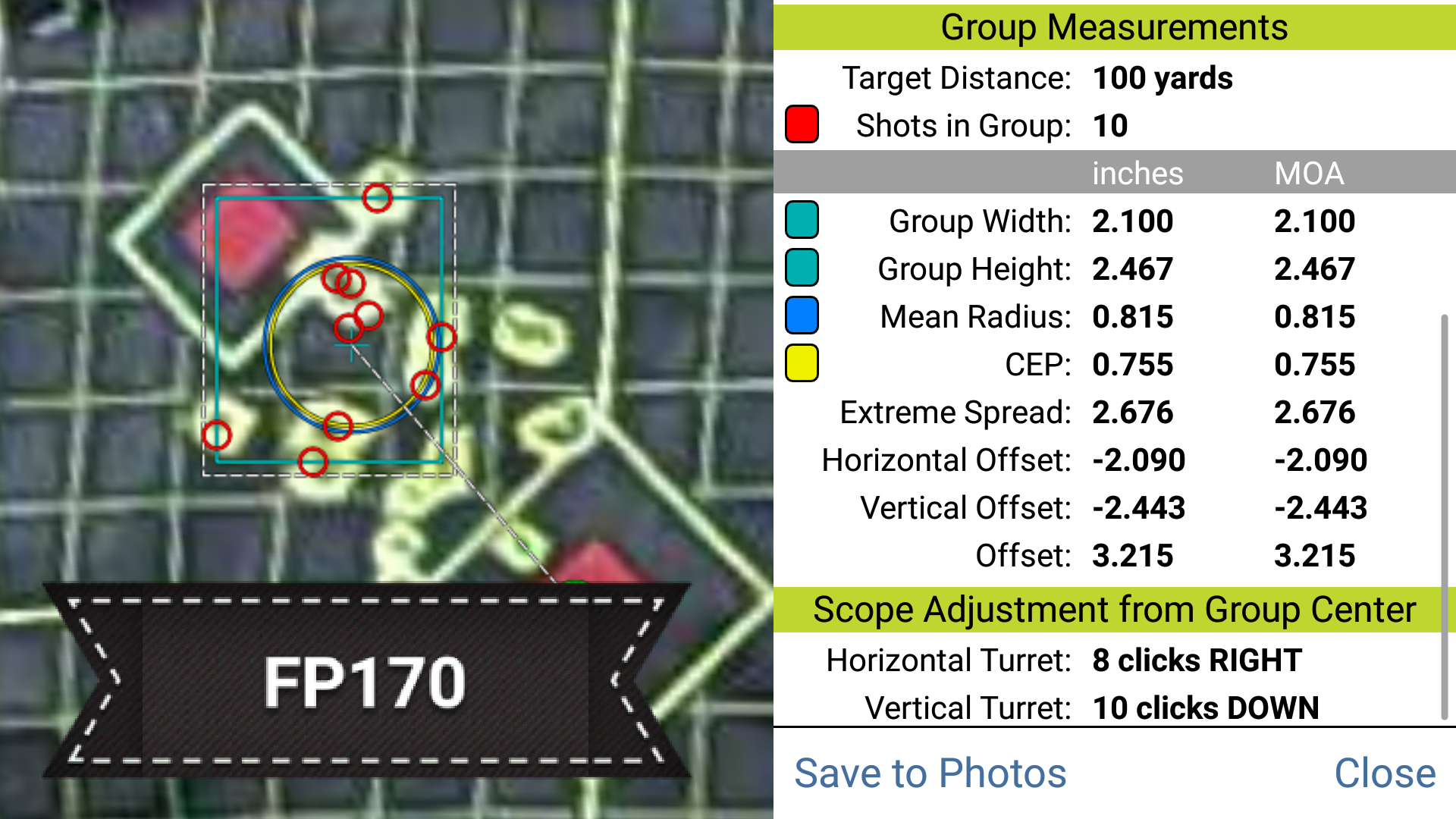

BECK loads an amazing subsonic round, Ive tried nearly all of there .308 loads and the 170gr flat point gives me a standard deviation of about 14 out of the box. Everything else Ive tried, including some developed loads I worked on with copper creek have a SD of 25 or more. These 170 FPs are just amazing right out of the box. Ive tried BECK maker rex, BECK amax, different weights and only one solid winner as I explained above. The 170fp is an amazing accurate subsonic round.
Ive done so much reading on subsonics and there is one thing I have read many times, flat top and flat bottom bullets are the best bullets for shootings subs. After seeing what these FPs can do, I can honestly say that these are the most forgiving bullets you can load for subsonic performance. To date, I can 100% agree that flat points and bases, for some unknown reason, are much better at slow speeds than any other bullet design.
How good?? I can shoot BECK loaded 170 FPs out to 350 yards. YES 350. I am shooting 1000fps from a DTS 16" barrel. (1:8 twist)

DEVELOPING the Maker REX.
My PRS buddy is using a "Lee universal neck expanding dye" (recomended by Paul) to open up the brass in an attempt to eliminate that excessive neck tension. Thankfully my PRS buddy is challenged by this project and he is going all-out balls to the wall to help me figure this out. He is a precision shooter and we are analysing every aspect of this load to get it done to the best of our ability. I can say a few things here so far. Paul's bullets are exteremely concentric because we tested them, all of the necks have been turned so we will have consistent neck tension, we are opening the necks so they are not too tight, primer holes are also being opens and cleaned for a nearly perfect ignition. We plan on doing a tightly controlled ladder test in the next few weeks. Weve been working on this for about 2 months.
FACTORY BOX AMMO ~ PAST RESULTS and DATA SHEETS ATTACHED USING ~BECK SUBSONIC AMMO
You can see on attached pictures, some of the slower shots on the BECK loaded REX bullets resulted in low hits. I am pretty sure that we can improve on these results. 6 of 10 shots were perfectly grouped, but 4 has dismal velocity and fell 4 inches low. (excessive neck tension?)
Keep one thing in mind when looking at the attached data, the target spreads that do not show all 10 shots have skewed results because we omiited the really slow velocity shots. For example, the BECK maker REX data only measured the poi spread of 6 shots because 4 were extremely slow and low. The more you look at this data, the more will jump out at you.
Overall, if you want a good shooting .308 subsonic load for target practice, you need to TRY the BECK 170 FPs. They are also great killers, have had MAJOR luck on game and as the BECK ad says, they hit like a freight train... but you must hit bone to transfer energy into the game if you want to see devestating results.
My ambition is to shoot the REX bullets in the end because they are much more lethal and therefore shot placement much more forgiving and humane.
