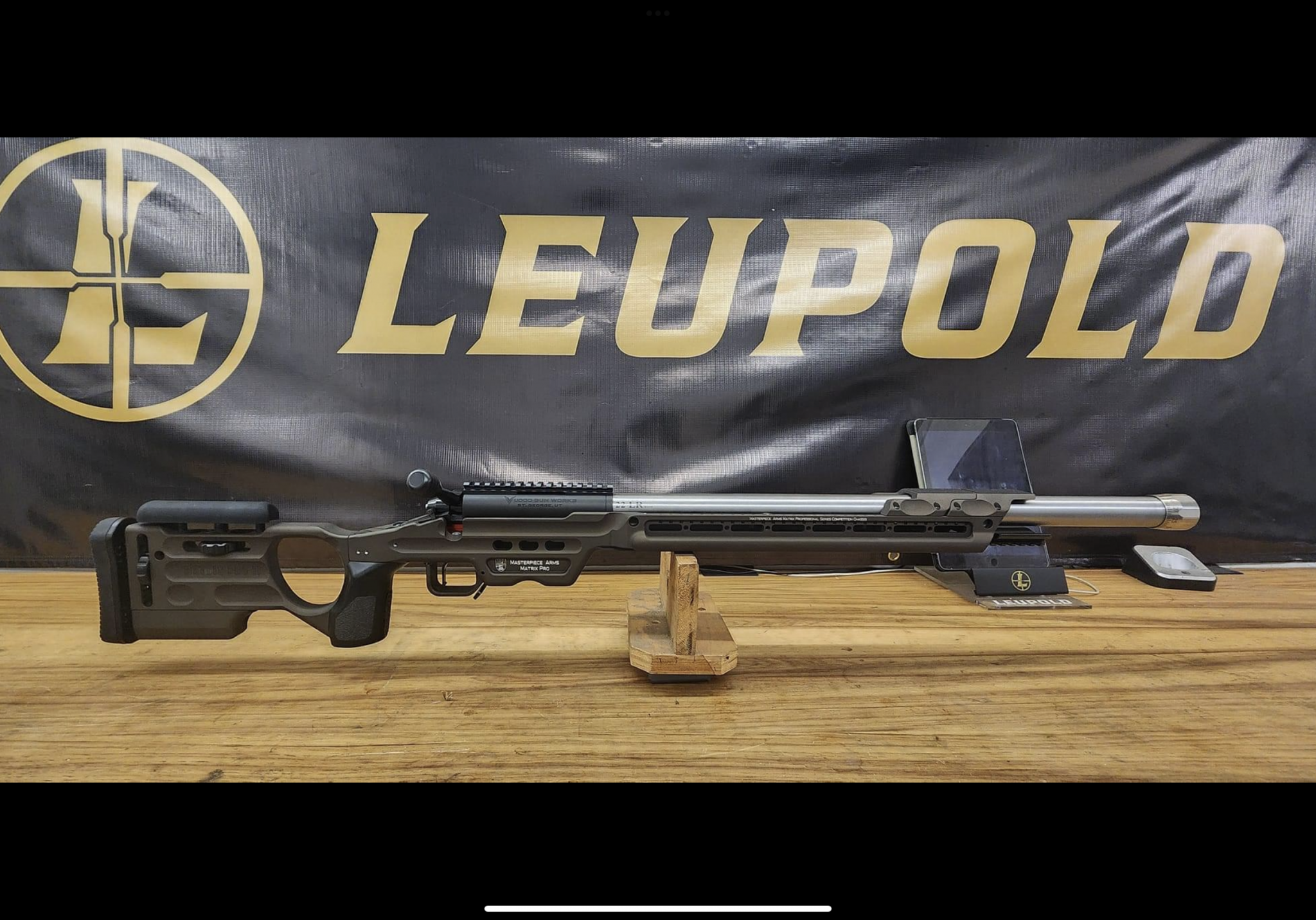

Target crown - no threads. I’m the OP - I think there is a picture somewhere above of my rifle.
