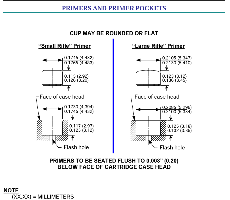

Read this, it might help:

Yes. measure your primer height including the protruding anvil (a) and measure the primer pocket depth (b) of your cases. Subtract a from b. This tells you the distance below the casehead to seat the primer for no crush. You can experiment with the level of crush that work best for your loads. I usually use about 0.004“ crush. Excessive crush or an excessive gap between the anvil and the bottom of case primer pocket may give erratic ignition.

Primers should not sit exactly flush, especially for an AR. The primer pocket depth and primer height advice above is good. Check the dimensions and determine how far below flush the dimensions would stack, then press in a few thousandths more, then inspect.
So many good replies. I'll start with this one.....
I measured 10pcs of new virgin brass from this lot, and they averaged a pocket depth of 0.1189". My CCI 450s measure an average thickness of 0.1195". So flush is about half-a-thousandth of crush.
I measured 10 pieces of brass that I had loaded, and they averaged less than 0.0005" (half-a-thou) below the surface. So basically flush. I then tried to reseat them all on my RCBS bench-top seater, which has a lot of leverage. I honestly probably used a bit too much force. And I was able to get them to average over 0.004" below the surface, but I really felt like all I did was crush the primers - that they were already fully seated. The primers now appear to have a LOT more crush (flatness to the top surface). And the measurements of the primer and primer pocket depth seem to concur with that. The proof will be in shooting them (hopefully this weekend).
