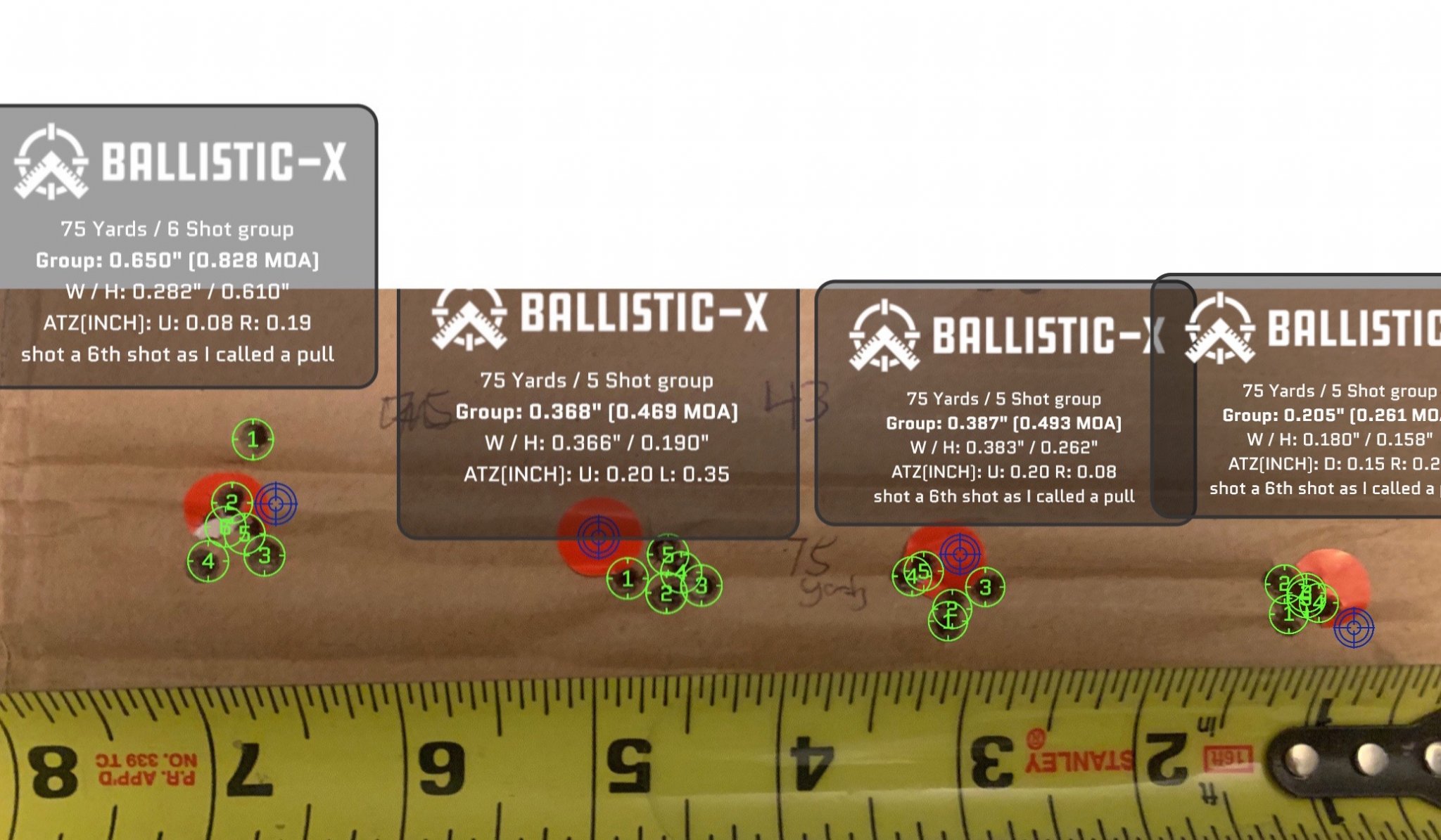

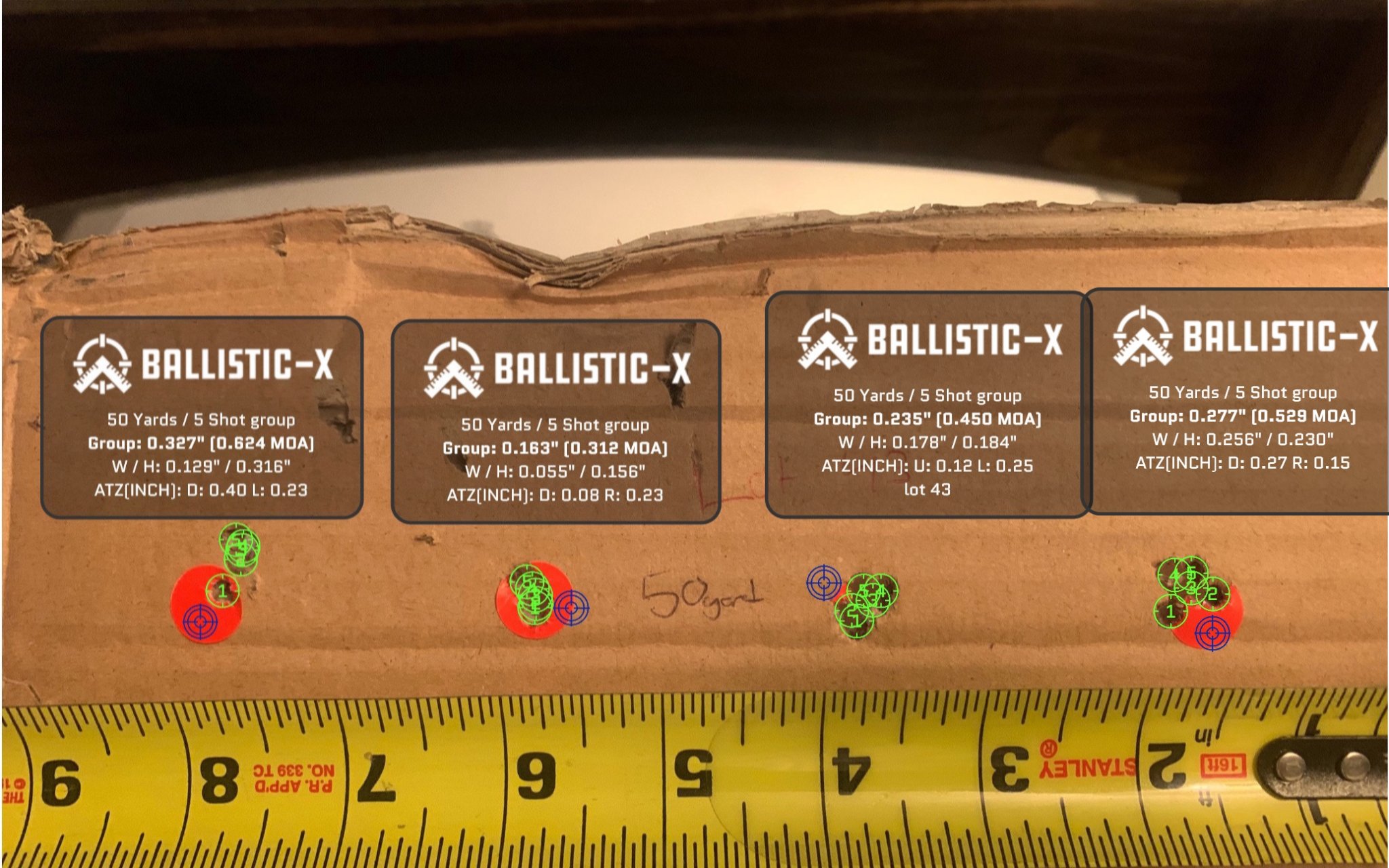

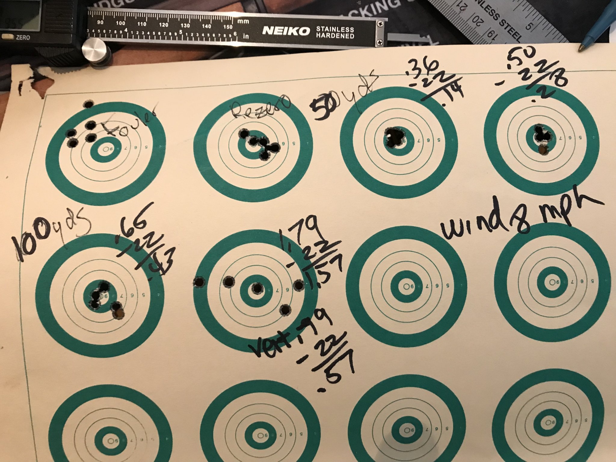

I love to tinker and have a 1:9, a 1:12, and soon a 1:16 twist barrel. The 1:9 is a Bartlein chambered by Lee Gardner. The 1:12 is a Lothar Walther. The 1:16 will be a Krieger chambered by Modacam. I do see differences between the 1:12 and the 1:9.
The 1:9 gave me some of the best groups I have had at 200 yards. It also has been my best grouping barrel when things are going right. The reasons I rarely shoot it anymore is that I saw a lot of horizontal change at various distances and fliers, when they occurred, seemed to be more extreme. I would be zeroed at 57 yards, but have to go .2 left at 25 yards and .4 right at 200 yards. I think this is from spin drift as it shows up in my ballistic calculator as well and was consistent across multiple days and conditions.
I shoot my 1:12 out to 500 and can pretty regularly connect on a small plate at 400 when the weather is calm. It does seem to have some spin drift but it's minimal especially when compared to the 1:9.
I am trying a slower twist since I have been going to a lot more positional matches where we are roughly 200 yards and in. It's also just to scratch the itch of trying something new. I also wanted something that was chambered for Eley due to the shipping changes from UPS and FedEx making it harder to ship to Lapua. Depending on how it does, I may end up switching back to my 1:12 or building a second rifle with it.
Hope this helps.
Hope this helps.

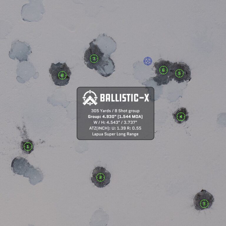

After shooting at 600 yards a number of times last summer with 16tw barrels, I am not sure a better summary could be made. I know from a handful of outings just what winds I may have decent success in, and in winds there is no use setting up.

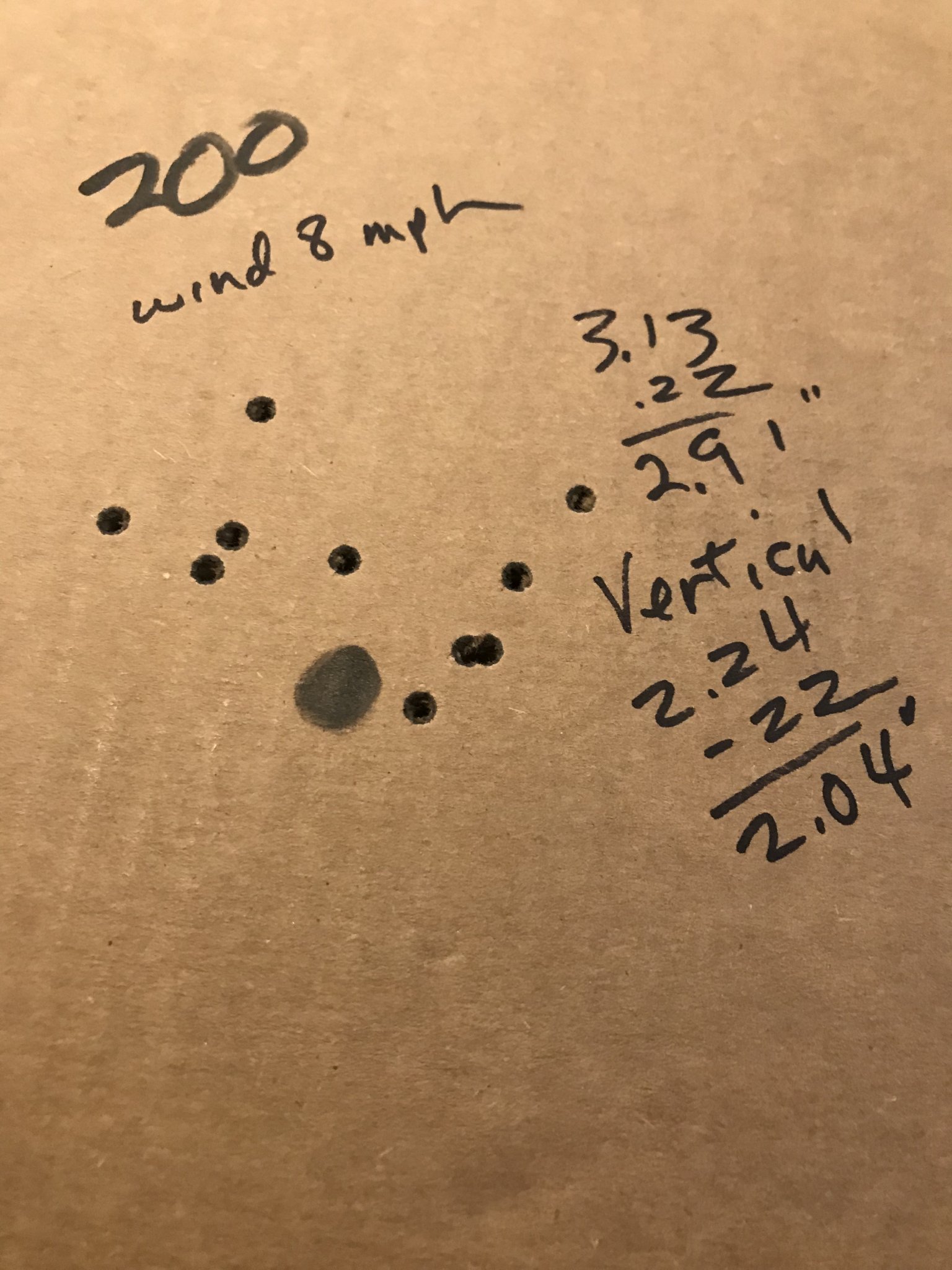

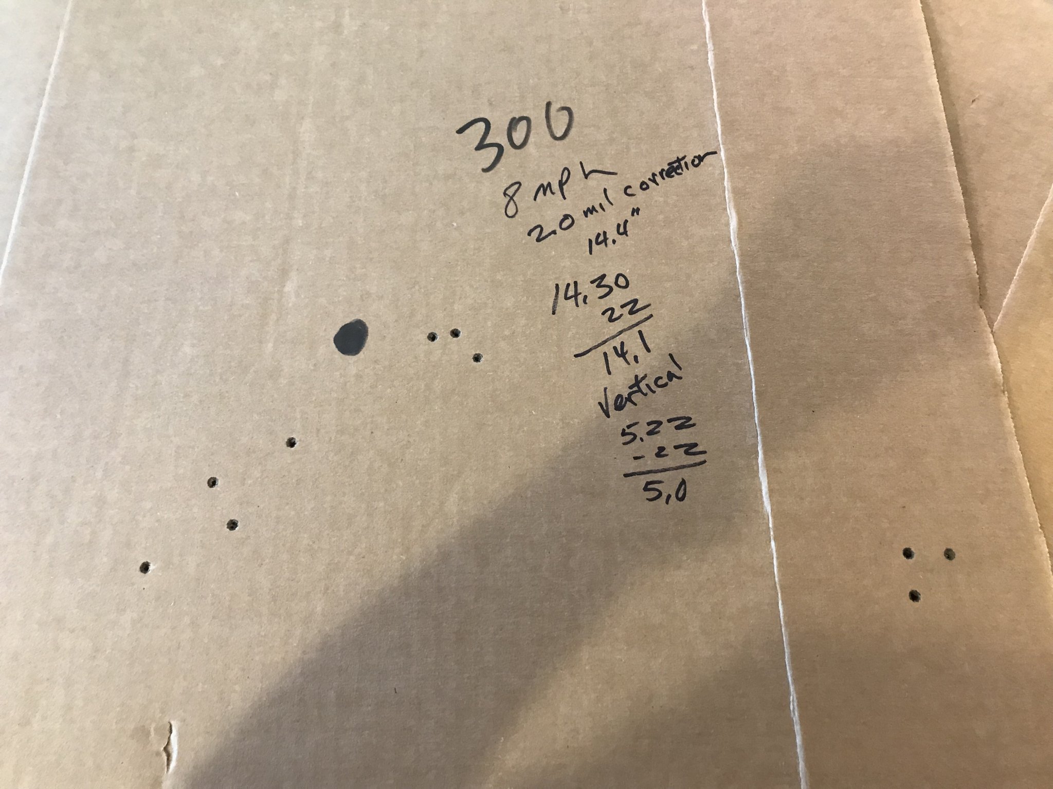

After all of this interesting SH discussion on fast twist .22LR barrels for ELR, I now have 3-400 rounds of Center-X through a 21" 1:9 Lilja on my Sako Quad - gently cleaned after every box with RF Blend.
The lot of CX that I have been shooting will group at around 4" @ 200y with my Sako and Anny factory 1:16 barrels, but with the Lilja 1:9, the vertical dispersion is 10-12" - totally unacceptable. Results at 50 and 100 are excellent, but this is not why we are all experimenting with fast twists....
I bought the barrel hoping for some improvement at 3-400y, but now I am thinking why bother? Is the Lilja now a just a $600 paperweight, or should I be doing something that I'm missing to improve accuracy?

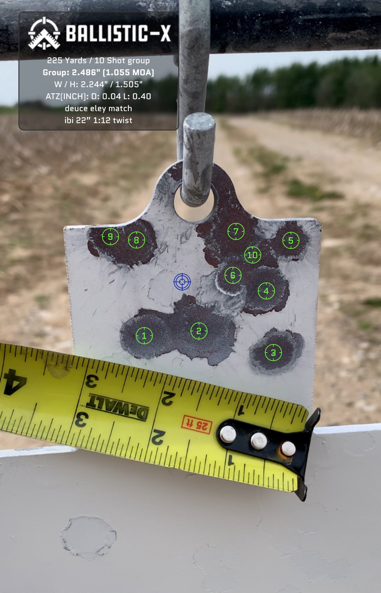

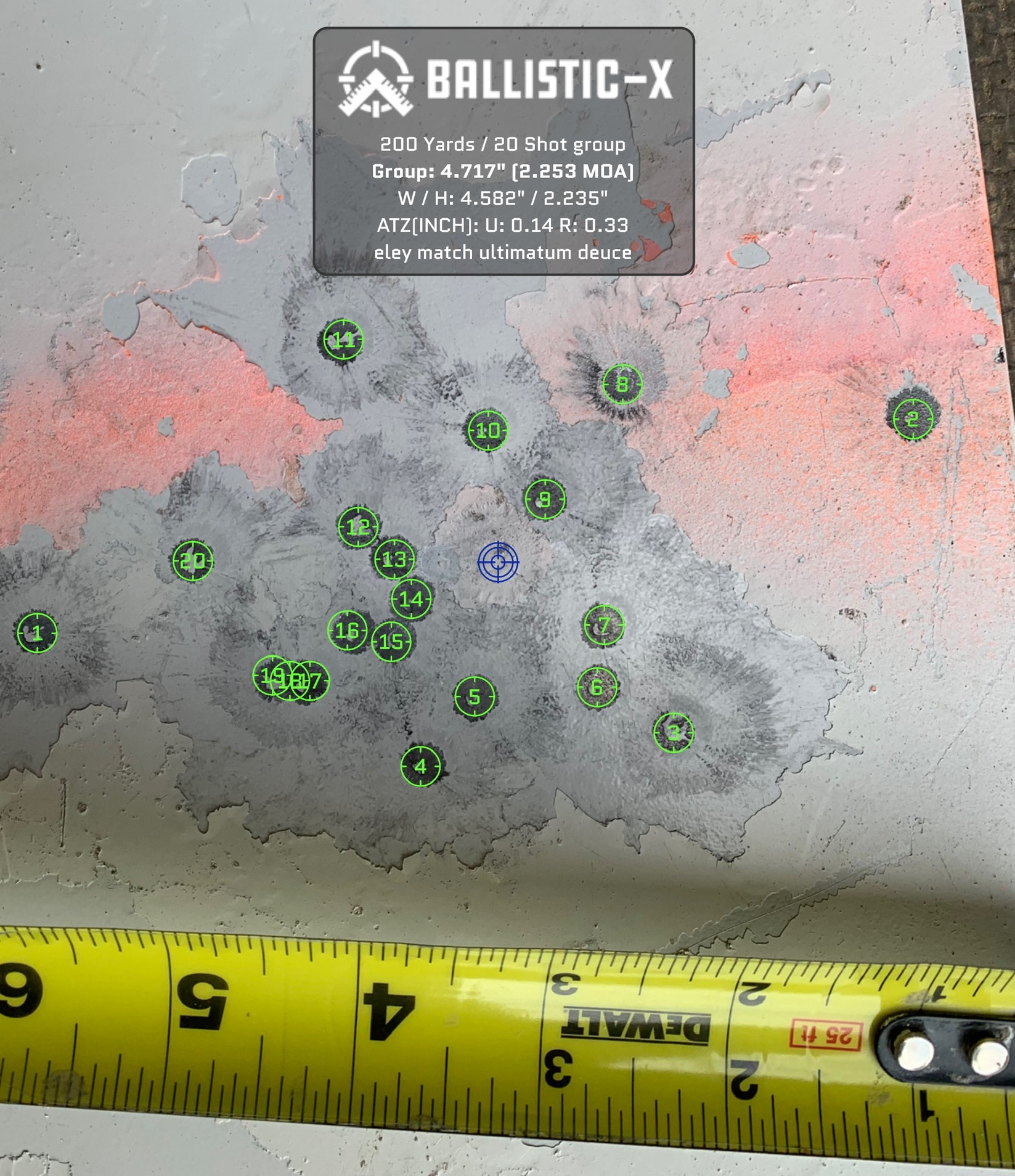

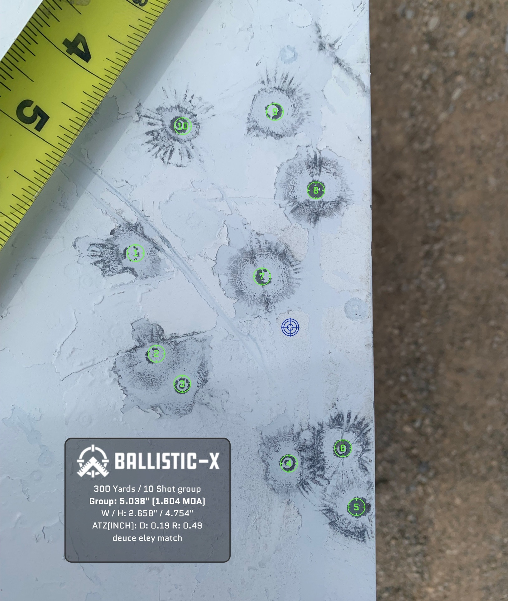

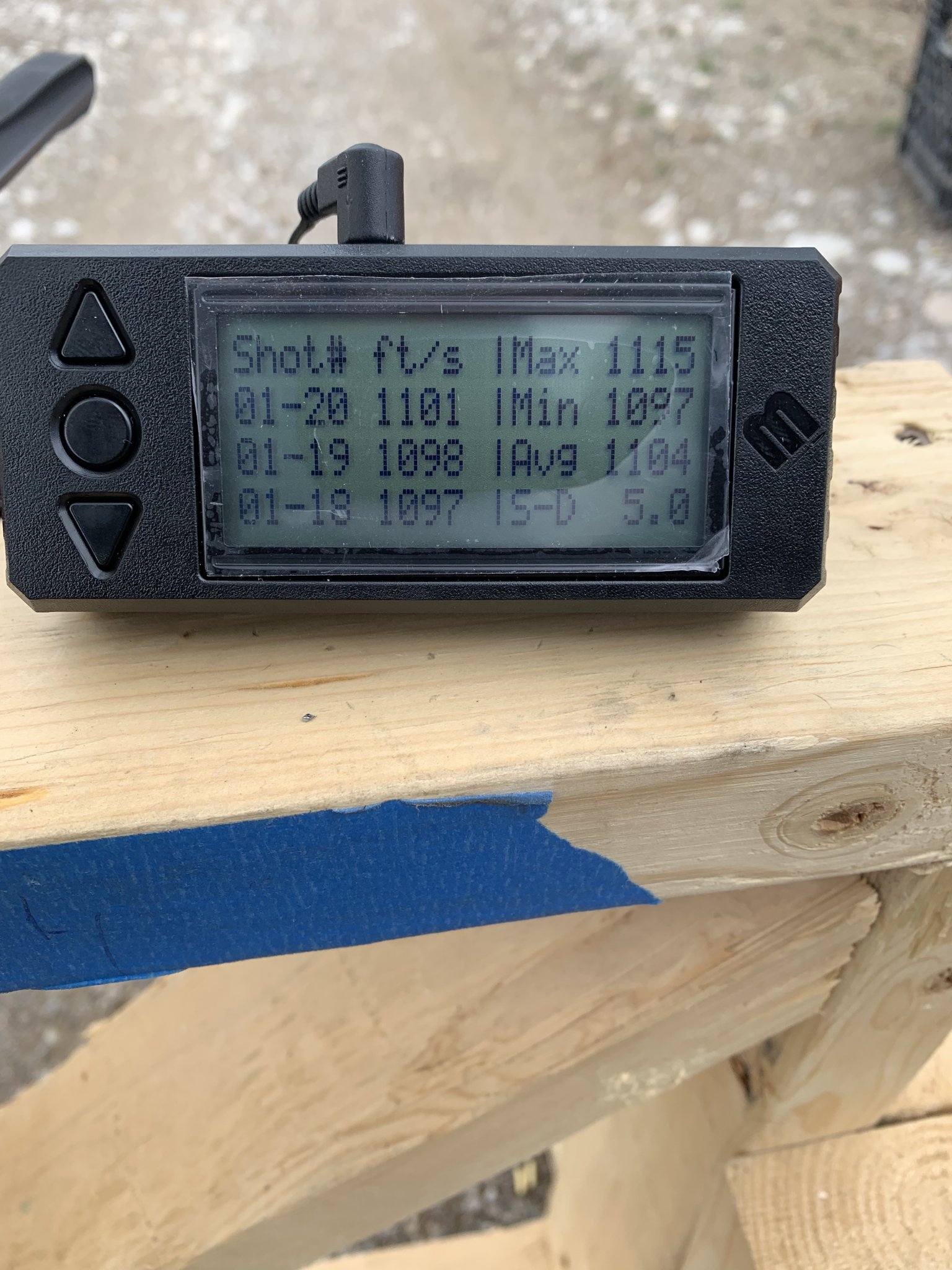

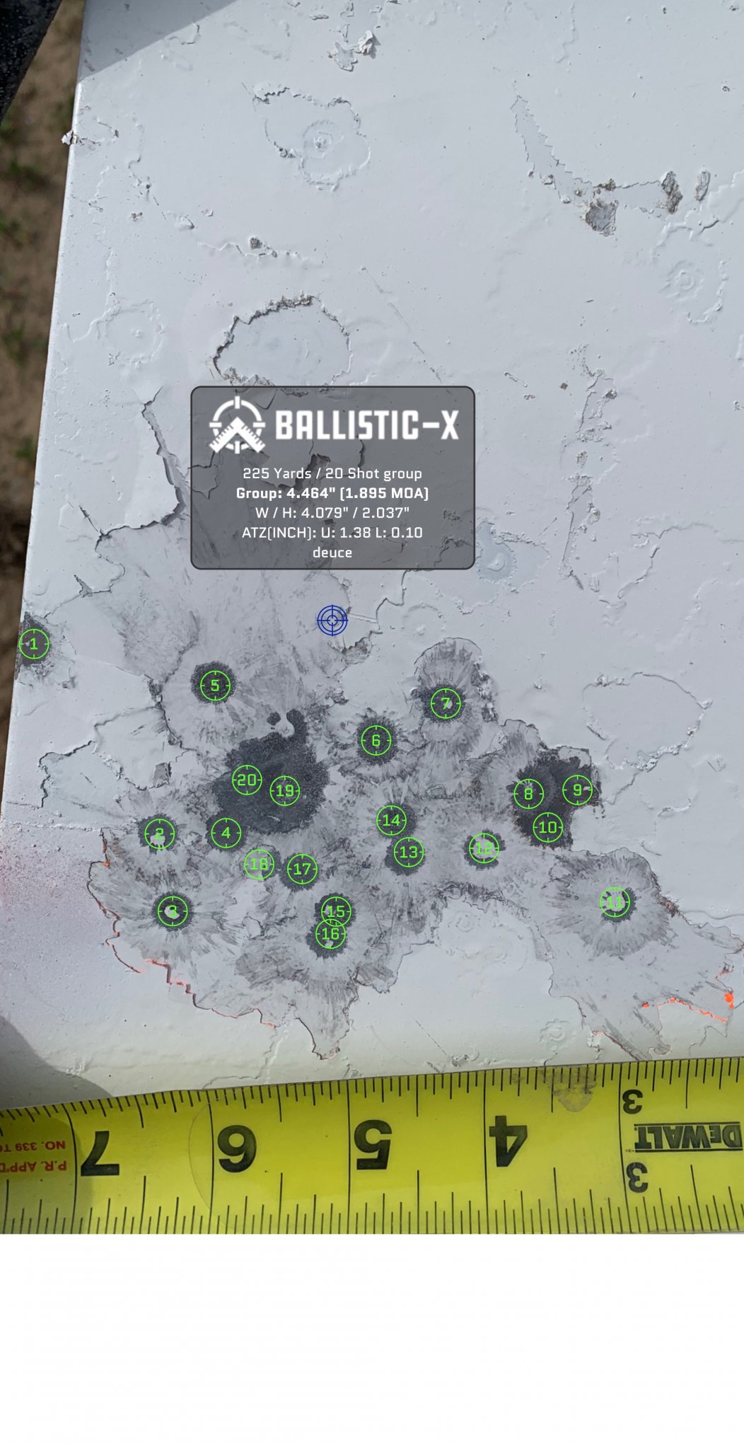

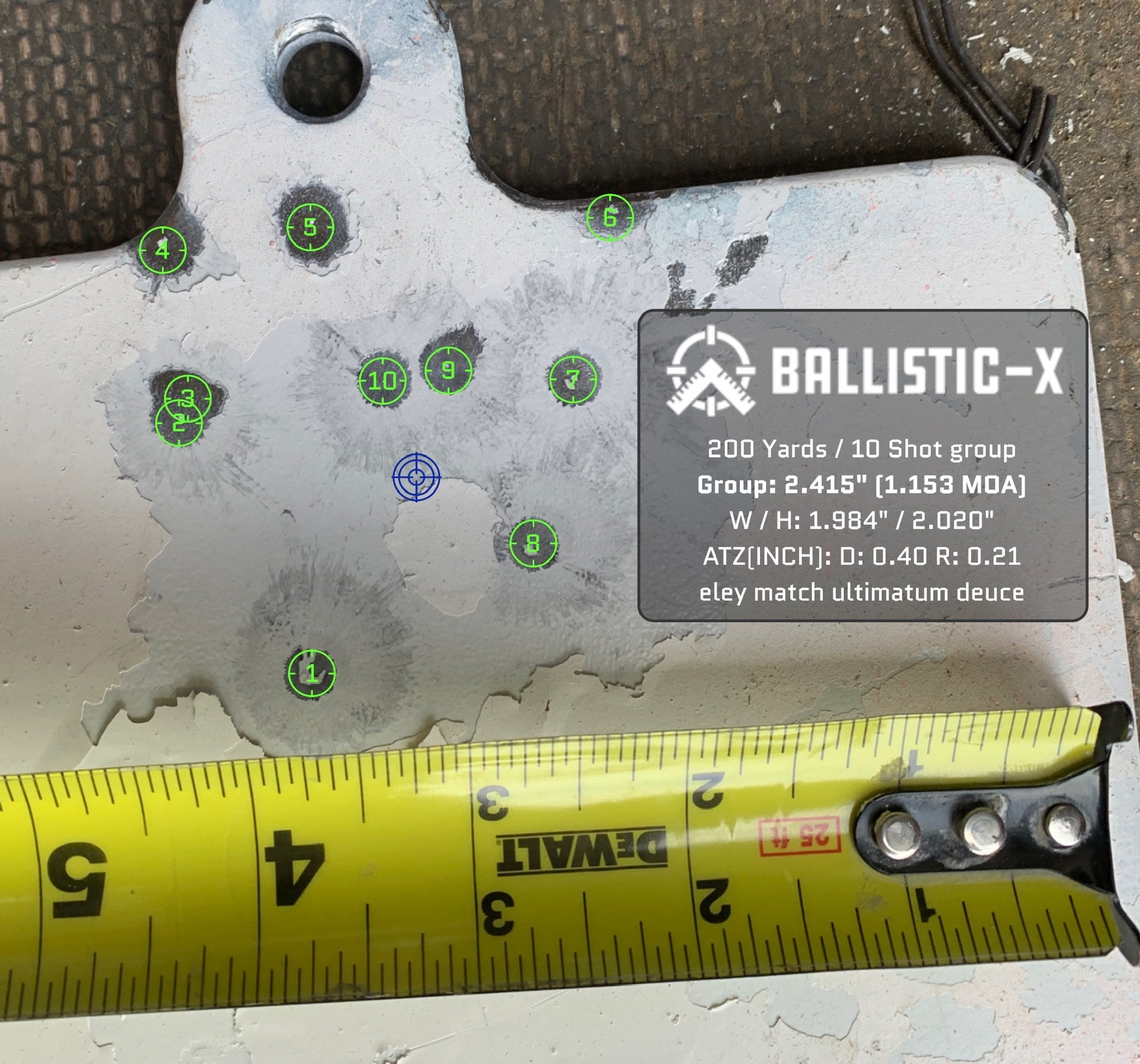

Promised range report -1 to 12 20” IBI. On a Duece. Eley match. Mv 1114 ( the box says 1068). Sd 3.7 for ten rounds. I tested 3 other lots in this barrel got 10.9 , 6.7, 8.3. Wind was on and off 8 mph. Here are the targets. I didn’t want to use a ton of ammo so obviously a small sample size. 50 and 100 are 5 shots 200-300 10 shots. Basically really happy with the
results. I think the wind died on those 3 on the right of the 300. That would zero out my 2 mil correction. I’m used to 4-5 in groups at 200 with lot tested ammo in 16 twist barrels. My conclusion is i got lucky on this barrel ammo combo
Promised range report -1 to 12 20” IBI. On a Duece. Eley match. Mv 1114 ( the box says 1068). Sd 3.7 for ten rounds. I tested 3 other lots in this barrel got 10.9 , 6.7, 8.3. Wind was on and off 8 mph. Here are the targets. I didn’t want to use a ton of ammo so obviously a small sample size. 50 and 100 are 5 shots 200-300 10 shots. Basically really happy with theView attachment 8127264View attachment 8127265View attachment 8127266 results. I think the wind died on those 3 on the right of the 300. That would zero out my 2 mil correction. I’m used to 4-5 in groups at 200 with lot tested ammo in 16 twist barrels. My conclusion is i got lucky on this barrel ammo combo
Looks good!!! I had my deuce out yesterday as well with an Ibi 1:12 22”. Had an sd of 5 for 20 rounds. I didn’t put it on paper at 100,200 or 300 just 50, 75 and steel from 75-325.
While my 20 shot group at 200 was douvle my 10 shot the vertical was only slightly bigger so overall very pleased.
In Litz's twist test he said some combinations lowered the SD. I'm too lazy to stick the 16 twist back on to compare, but it makes you wonder.
If I had a more direct comparision for 1:16 twist I would try it, but I have 2 ibi 1:12’s 22” and a lothar 16 twist. I have a 16 twist Ibi coming and a 14 twist ks arms coming

I have one of these on a Rim X, going on a month now. A lot of things could go wrong in a selection, length, mine 23", and chambering.
All I have right now is that I have tested a lot of ammo, at 50, 200 and 300 yards. Conditions not perfect, but it has been a struggle. Had a couple lots of Lapua Long Range that looked promising, so I slapped a tuner on, wasted even more ammo.
I can't add barrel, no clue what length to try cutting it off at. Been one expensive project.
I doubt it is the barrel itself, but choices, lol

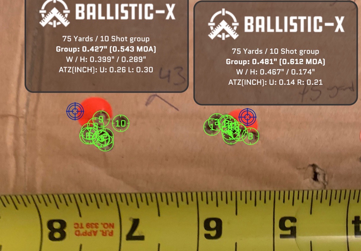

I got a Three 60 barrelled action by way of DI Precision with a 25" MullerWorks 8-groove, 1:13", 1.250" straight several weeks ago. I'm still in the process of releasing a write-up.
I'm not the best shooter by any means, but from my testing so far, I can throw any random lot of Center-X into it and it will shoot at least .6MOA at 50 yards and will get down to .3MOA with a good lot (shooting 10-round aggregate strings). I feel like you're not going to give up anything 50 yards and in.
Reactions: Turbo2 and 6.5SH
When a barrel can shoot "any random lot of Center-X" to produce at least .6 MOA (about .314" center-to-center or no more than about 13.5mm outside-to-outside) ten-shot group averages at 50 yards, it's an incredible thing. For that particular barrel there is no such thing as a bad lot of CX ammo.
What's more, lot selected ammo gets results that are considerably better, with ten-shot averages as good as 7mm outside-to-outside. It's hard not to wish for such a barrel.

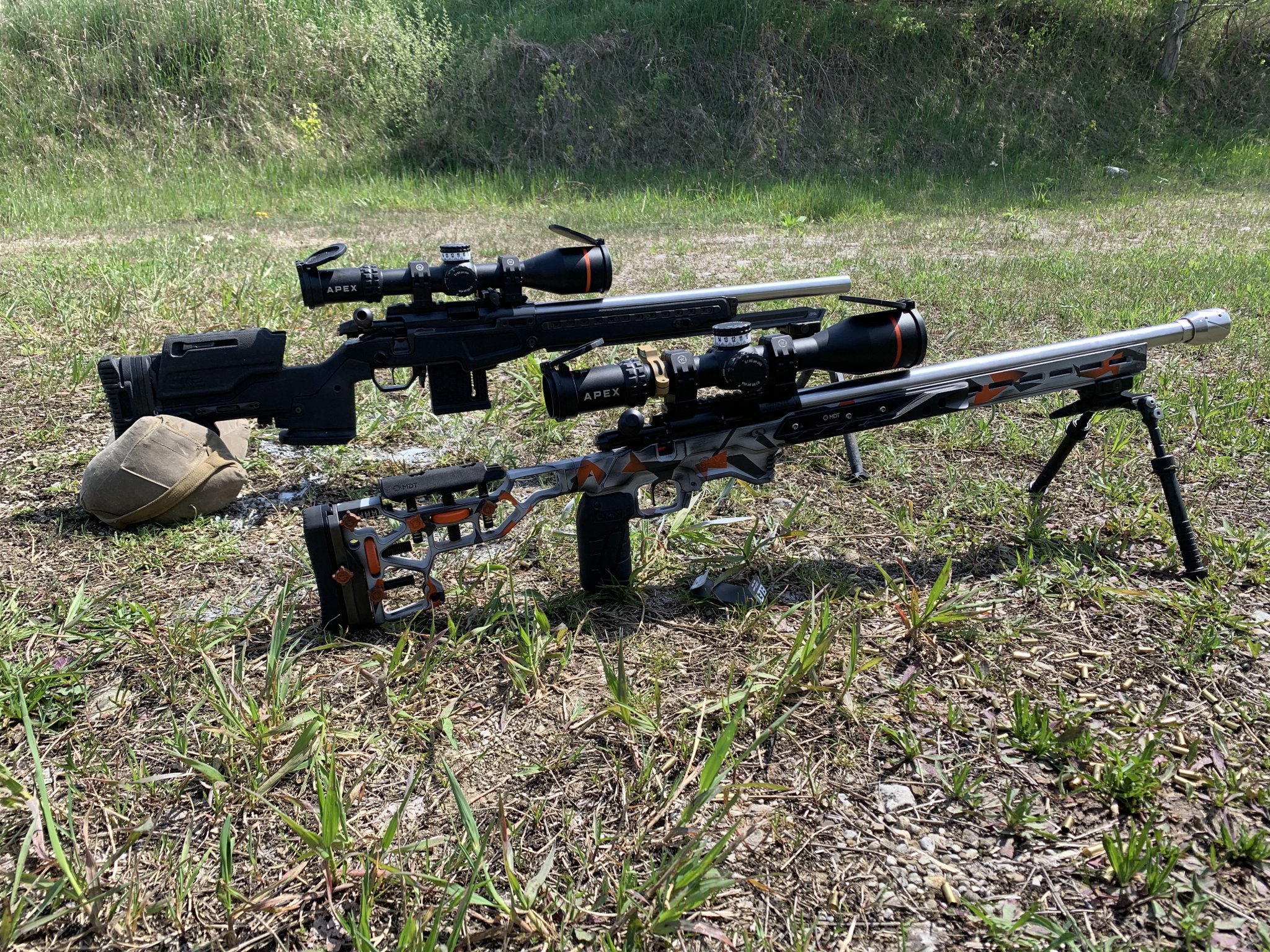

My most recent 22LR build using a new Vudoo Gun Works Three 60 action and a 25" MullerWorks 8-groove (1:13" twist, 1.250" straight) by way of DI Precision.
https://www.ocabj.net/di-precision-vudoo-gun-works-three-60-rifle-overview/
Build sheet:
  • Vudoo Gun Works Three 60 action
  • MullerWorks, Inc. 8-groove, 25″ length, 1:13″ twist, 1.250″ straight contour, unthreaded barrel
  • TriggerTech Diamond Pro Curved trigger
  • Masterpiece Arms Matrix Professional chassis
  • Vudoo Gun Works 40MOA scope base
  • AUDERE ADVERSUS 36mm diameter, 38mm tall, 20 MOA scope mount
  • Zero Compromise Optic ZC527 MPCT3 scope
22 lb 1 oz weight of rifle without bipod, running internal and external weights on the front half of the foreend to get it to balance exactly where I want it.

Update on the 13tw, a Eley reamer was used. After sorting through over 12 lots of various Lapua ammos, I tested some Eley match this am and found a winner. I was able to shoot 5 consecutive groups under 1.25" @ 200. ES of 14, SD of 2.4 for a 30 rd sample. Only issue I see, but did not see it actually, avg velocity was 1132. This will suffice for my first outing, when I have more time and nicer weather. There was inventory left of this lot and bought 5 bricks to see me through for a bit.
Also have a sample pack of 18 lots of RWS heading my way.
