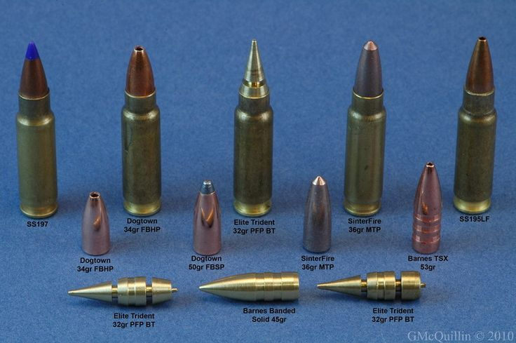

If only I could find some 45gr Barnes Solids:
