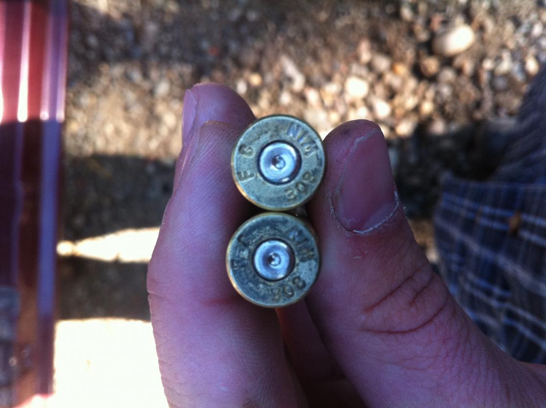

Went to the range last night with 20 reloads and out of those 20 I had 7 ftf. I didn't change a thing from the hundreds of rounds before this, came home pulled the bullets and re seated the primers and tryed to fire just the primer again to no avail. This is the first time I have had a problem with fgmm primers so I was wondering if anyone else has experienced any problems with them?
The one on the bottom fired the one on the top did not

I load a ton of 210's, as I sure you do also. I've never heard of it, but as I just started using a new sleeve-I'm concerned. It sure looks like you were hitting them hard enough. Do you have the lot #, I'd like to check my stash. Thanks for the heads up.

Both those primers in the picture look well hit. If that is a fair representation of what the other 6 looked like then there may be something fishy going on in Denmark. Did the tray or box look like it had possibly been exposed to a contaminant?

No damage to the box it has been sitting high and dry on my bench for a couple months, like I say this is the first time that I have had this problem. I do use a small amount of lube on the outside of the neck but I always whipe it off before putting it in the block for the next stage of my process. I was shooting federal brass that is probably close to the end of its life, but all the primers bottomed out level with the bottom of the case like normal. All the primer have good solid firing pin engagement, It's pretty warm up here but it's an extremely dry climate so I don't think moisture is an issue. So I guess ill just see what happens on the next go round.
