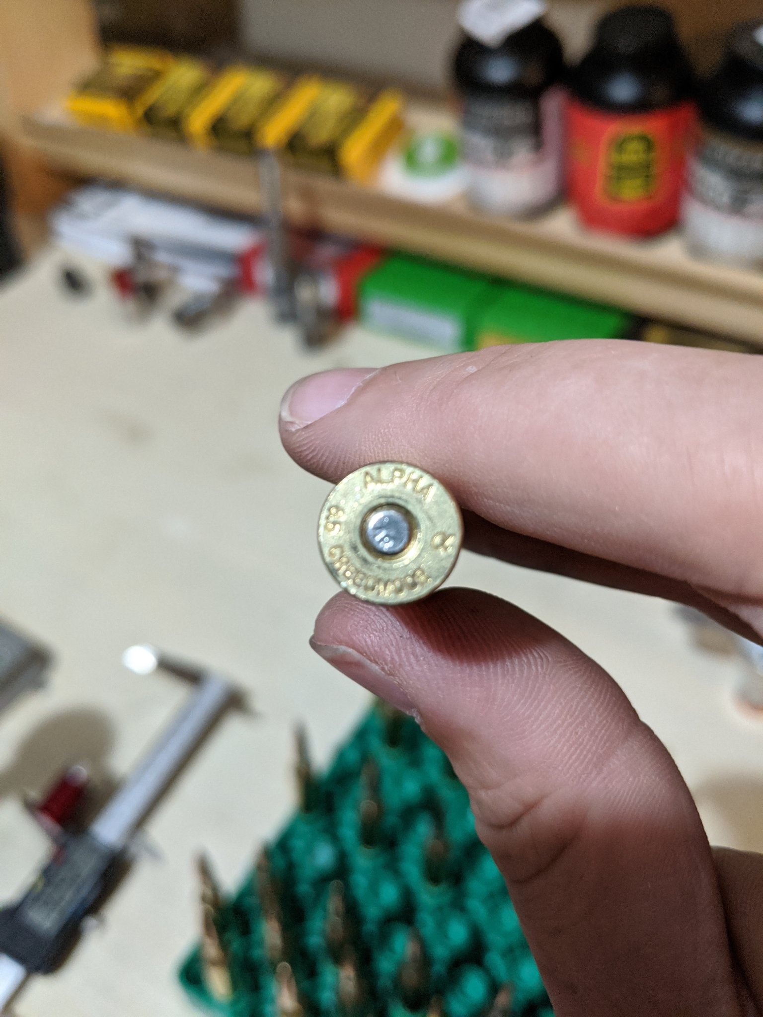

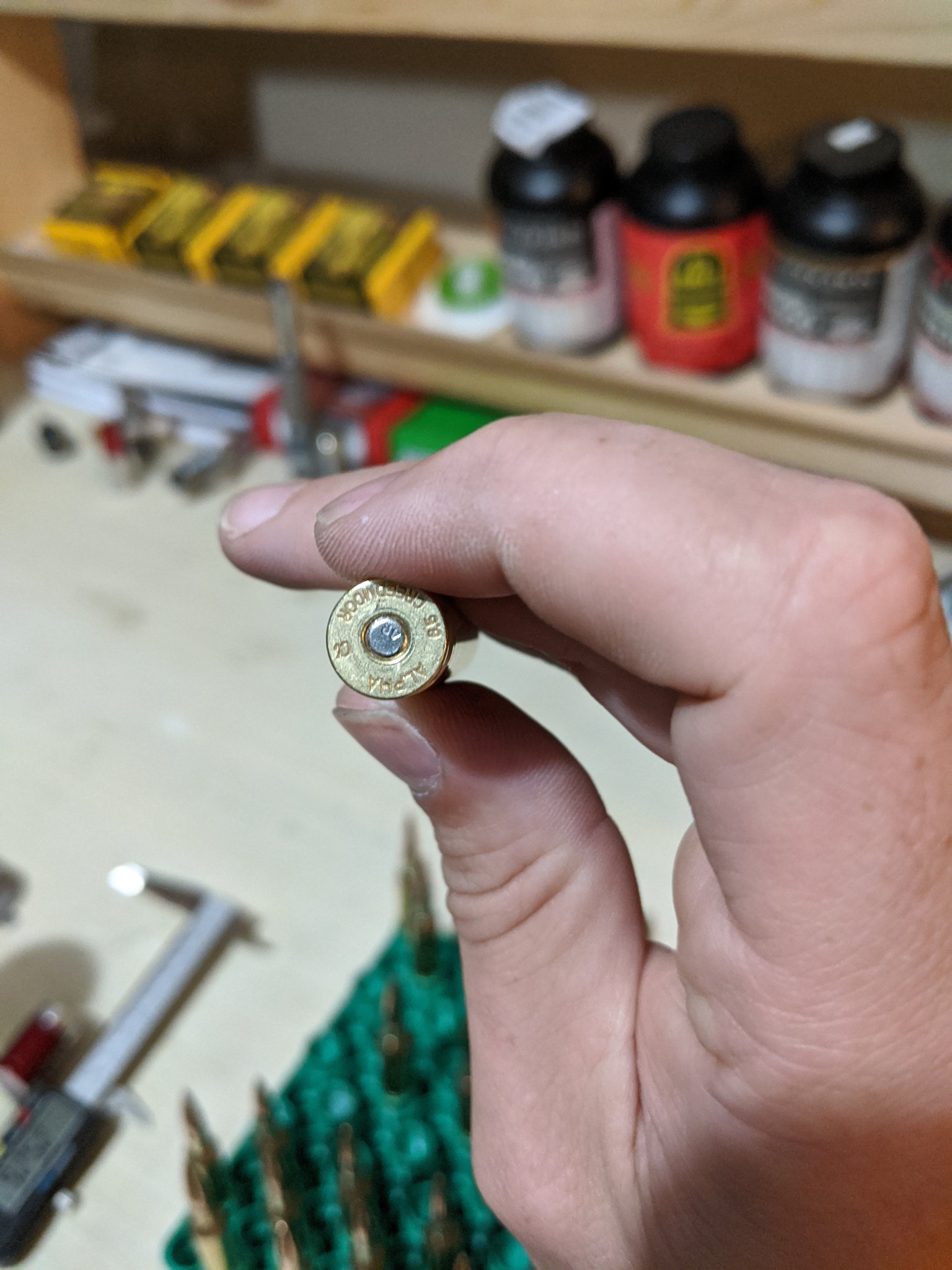

So now I'm done with the criteria part. Today I was on high alert while doing some more loading. Been working through some concentricity issues. While I was priming my cases I noticed that some 5/100 of my FGMM 205M primers have an AR stamp on the cup. Now I know that Federal makes an AR specific primer. I've never bought any so I can't compare hence why Im writing this post. Am I drunk or did my 205M primers somehow get AR primers mixed in with them in packaging? Seeing as consistency is the name of the game seems odd Federal would stamp 1/20th of their primers. This was the last box in a 1000 cube so I would have to assume the whole lot was like that. I have another 1000 cube of the same lot. Not particularly wanting to look through 1000 primers to see if they are all like this when I can just check when I'm priming.

Man that sucks. I'm pretty sure these two came from Midway but I'm not sure I got 2 1k bricks from Midway and 2 1k bricks from Cabela's or maybe Sportsmen's. I just looked through the last 100 pack out of this 1k brick and didn't find any that had the AR stamp on them. I have another 1k brick from the same lot I'll have to keep an eye on. I'm hoping it was a one off thing. Do you have any experience with the AR primers that Federal makes? Do they stamp them or am I way off? That's the first thing that came to mind when I saw the stamp.
