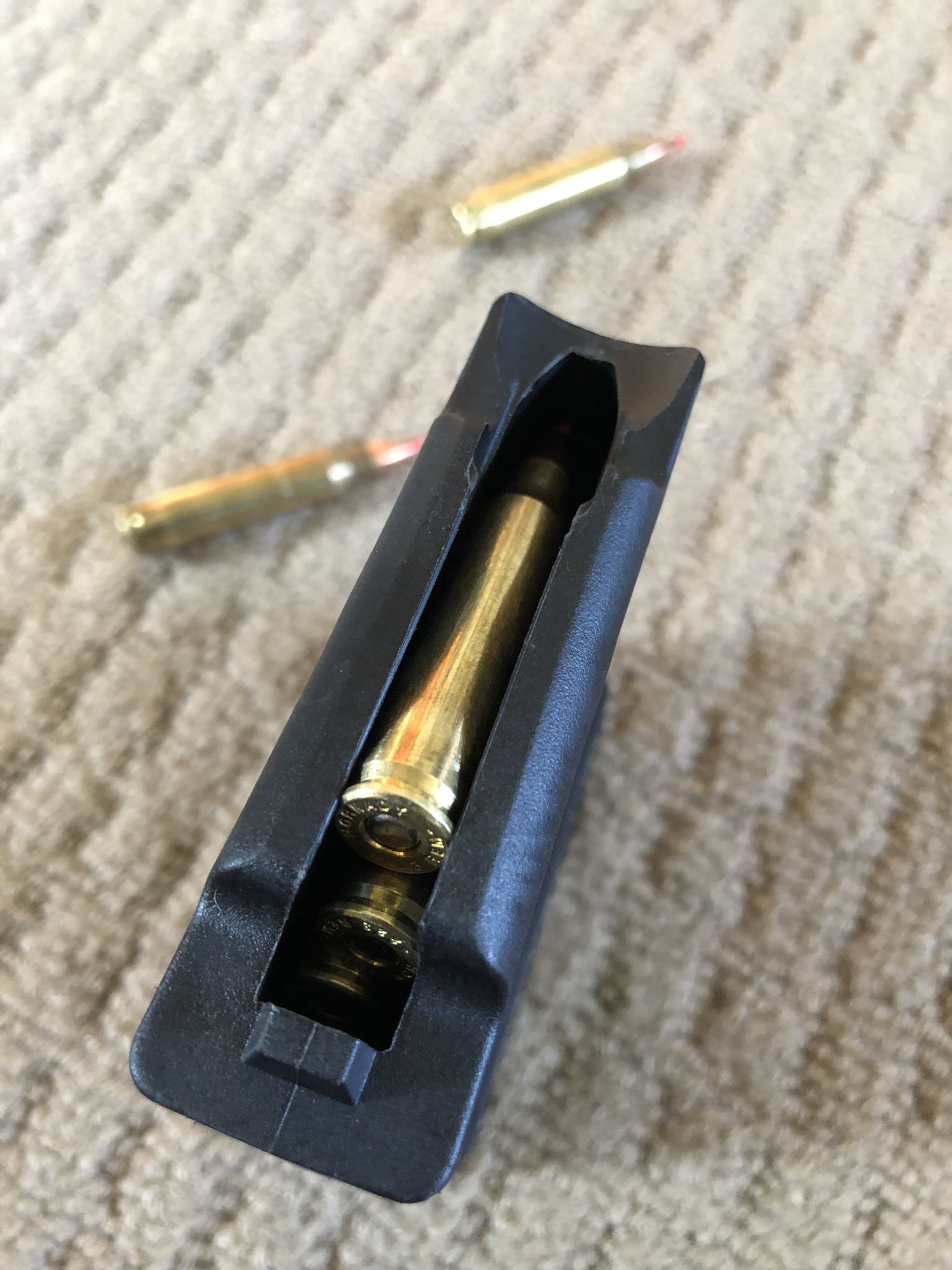

I’m curious as I’ve got the same issues with 2x new Ruger mags for a 223 RPR MKII. They both jam when when it’s feeding the last 3rd round. I have to plush the round out and into the breach with my fingers to get the magazine to release. It’s a pain, but I thought it was a dodgy magazine, but both supplied mags do exactly the same. What was the resolution that you found? Did you buy aftermarket mags that worked? Thanks
6 223 rounds in a Ruger mag all lined up. On feeding them out, the 3rd from last nosedives into the mag

I only use the AICS patterned magpul mags in mine. I have never had any issues with mine. They are very smooth feeding magazines for sure. I dont like the 308 pattern pmags. Never have. Always seemed like there is a lot of friction with those magazines. A lot more than the 556 pmags, which i never had an issue with.
