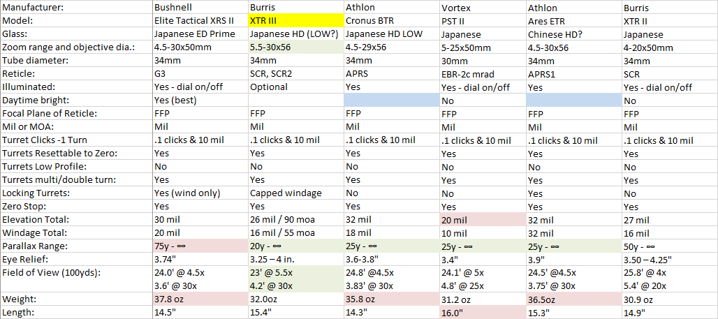

How soon do you need the scope? The reason I ask is because the new Burris XTR III 5.5-30x50 is coming out in a few weeks and looks to be a great scope for the price, here's some scopes in the range of what you're looking for where you can compare specs side by side. I should also mention that the Sig Sauer Tango6 line often goes on sale into the $1500ish range and the 4-24 and 5-30 usually get great reviews.
