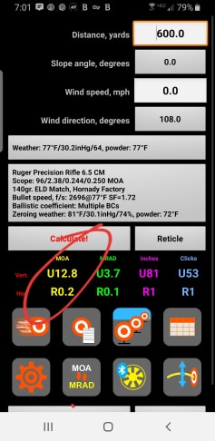

Which app? My app (Strelok Pro) gives me the elevation turret adjustment in clicks and MOA (or MILs).
In this case... the turret adjustment value is 12.8-MOA. So, 12-3/4 MOA. I know that my elevation turret is 12-MOA per revolution. Easy peasy... One full turn plus 3/4 (which is 3 clicks). That would take me about 2 seconds to do. I don't count out 53 clicks. Who does that?? :)

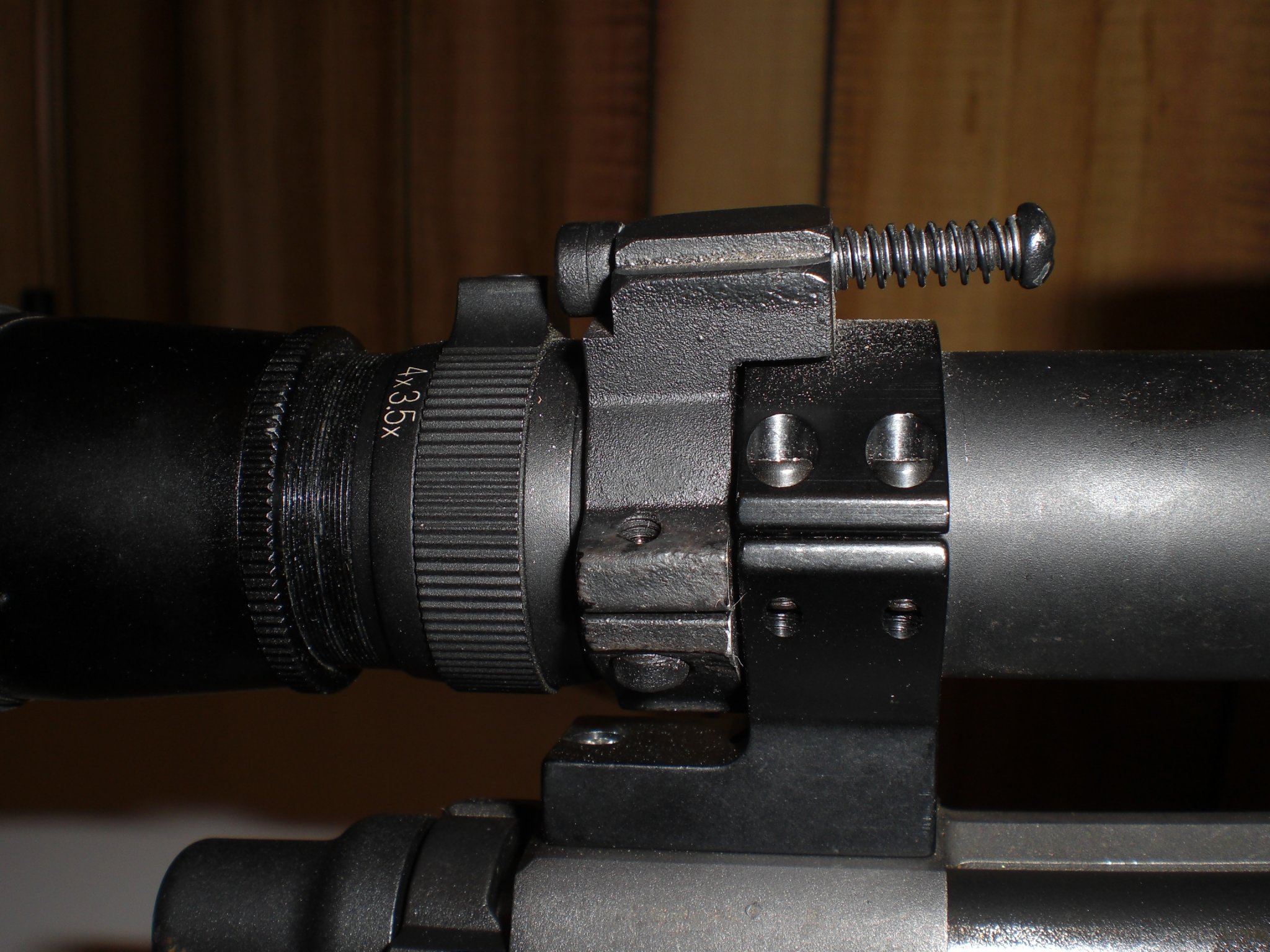

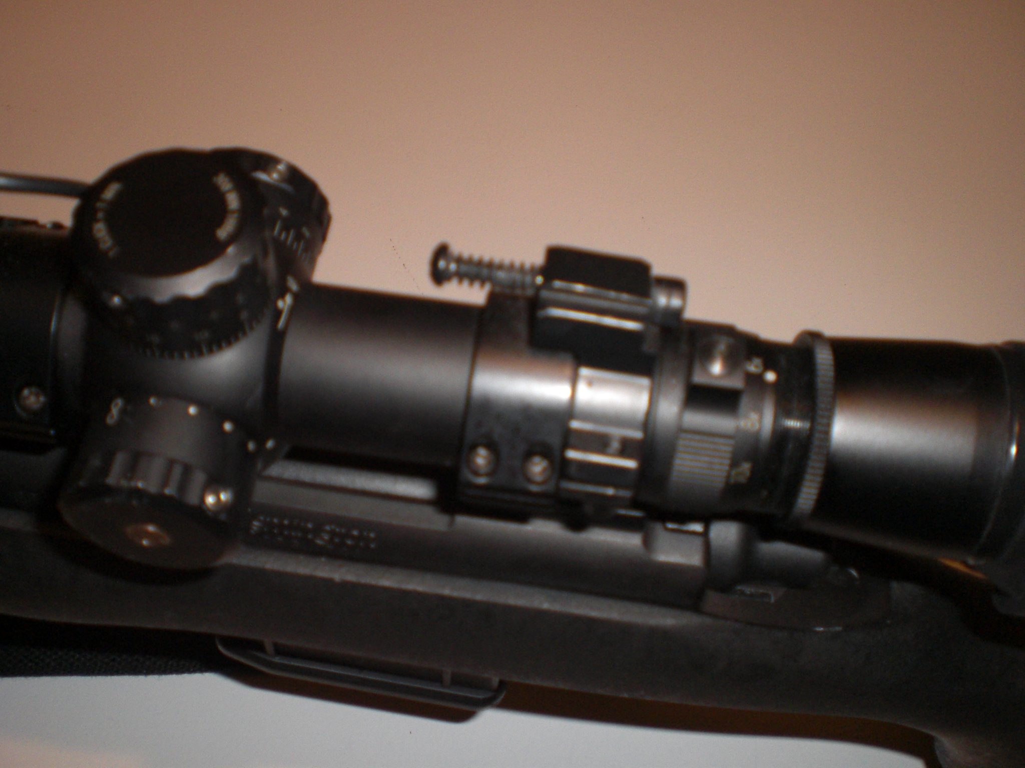

I was wondering how that contraption works looking at your pics, now I think I get it. Assuming a SFP scope, At max power the number of mils or MOA visible is what you have to hold. At exactly 1/2 power the number of available mils or MOA is twice what it appears to be and at min power 4x what is visible per the inverse relationship.
Can I assume you simply tighten the screw against the mag ring to lock it in place to preserve your ”hold ratio” (ratio actual mils available to visible Mils)?
I have them on all my SFP 3.5x10 M3's with MOA tree ret's (an other scopes as well). No scope doubles at half of the max setting that I have ever seen. Once I test the scope on max power to make sure the ret subtends correctly there, I reduce power until the reading is half of the max then adjust the doubler stop to the power ring. On most Mk4s like mine it will be real close to 6.2X. Why Leupold never installed a de-dent for this is beyond me. This way I can use it at night w/o issue as I shoot a lot, an I mean a lot of subs at night. The doubler allows 400yd holds w/sub ammo, more than that depending target size I'll either drop to 3.5X or knob but, I hate adding up with the knobs anymore, it just takes extra time I normally don't have at these kinds of shoots.

I run my two SFPs on ARs using the same concept but make an index mark on the scope body to denote true half power...haven’t seen a mechanical mag stop like that before. And yes, a detent would have been nice but that makes too much sense.
