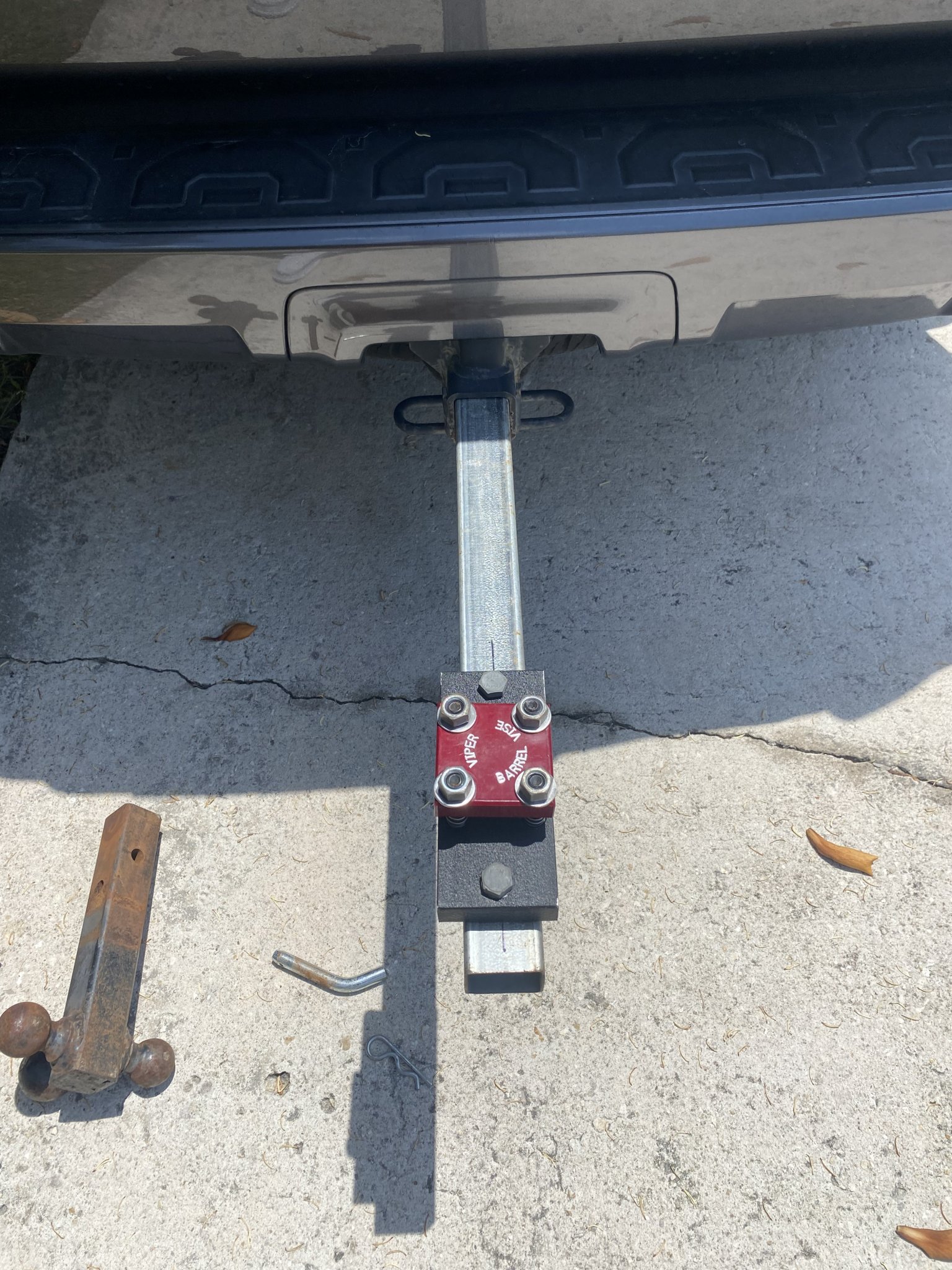

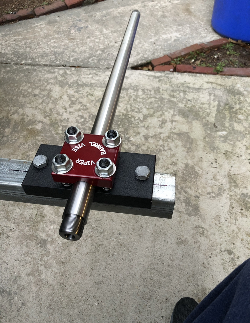

I use the PMA vise.
I bolted it to a chunk of 2” square tube I got cheap as scrap, and made a hole lat the other end so I can put it in my hitch, with the pin.
Not a pro. Barely mediocre amateur on my best day
Slips in the tool box with other gunsmiffin tools and is handy.
At home I just put the tubing in a bench vise or clamp it to the bench with a couple c clamps or small bar clamps.
Reactions: A5scott
I don't even have my viper mounted at home. I just use a couple of C Clamps and clamp it to my workbench when I need it.
If I needed it at the range, then I'd just clamp it to a picnic table/bench.
Cheap but works.
Viper vise $60ish
2” aluminum square tube $5ish
2 bolts, nuts, spacers $5ish
