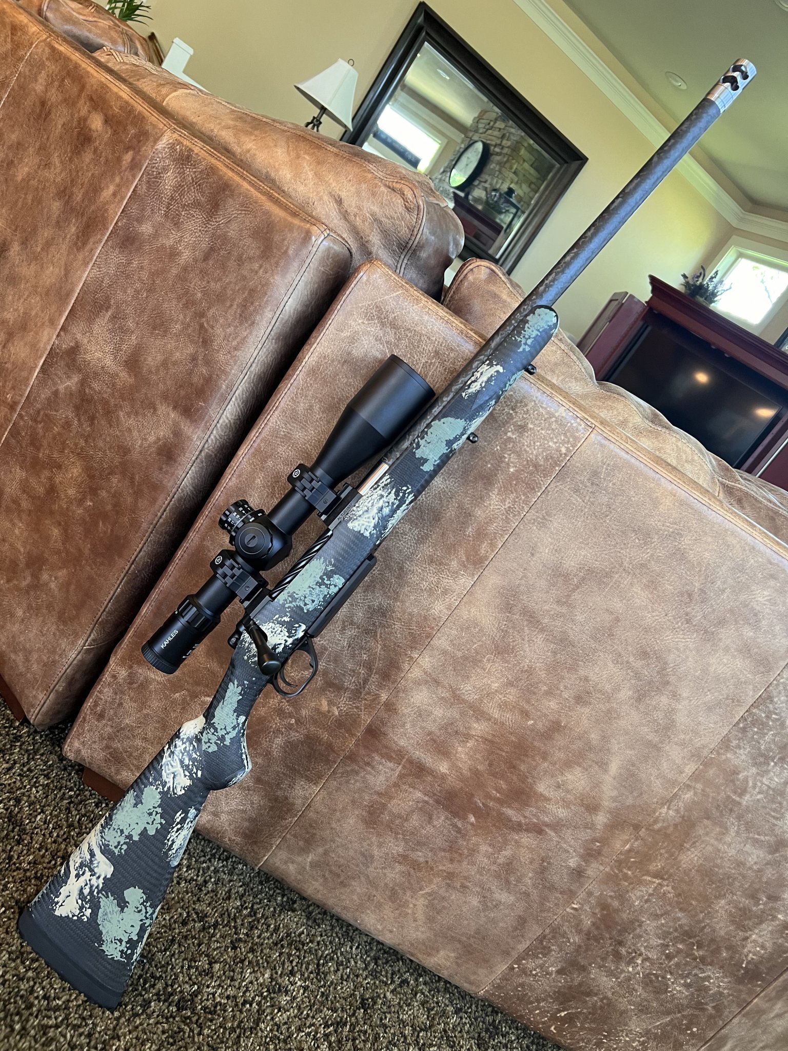

Well I finally got my 7PRC done. Bighorn Origin, Area 419 rings and arca, Manners EH1-A stock in scorched earth high gloss (so damn beautiful, the pic doesn’t do it justice), Nightforce NX8, Proof Research 24” barrel, SRS titanium brake, and good ol’Atlas Cal. It comes together fully chonky at 12lbs.

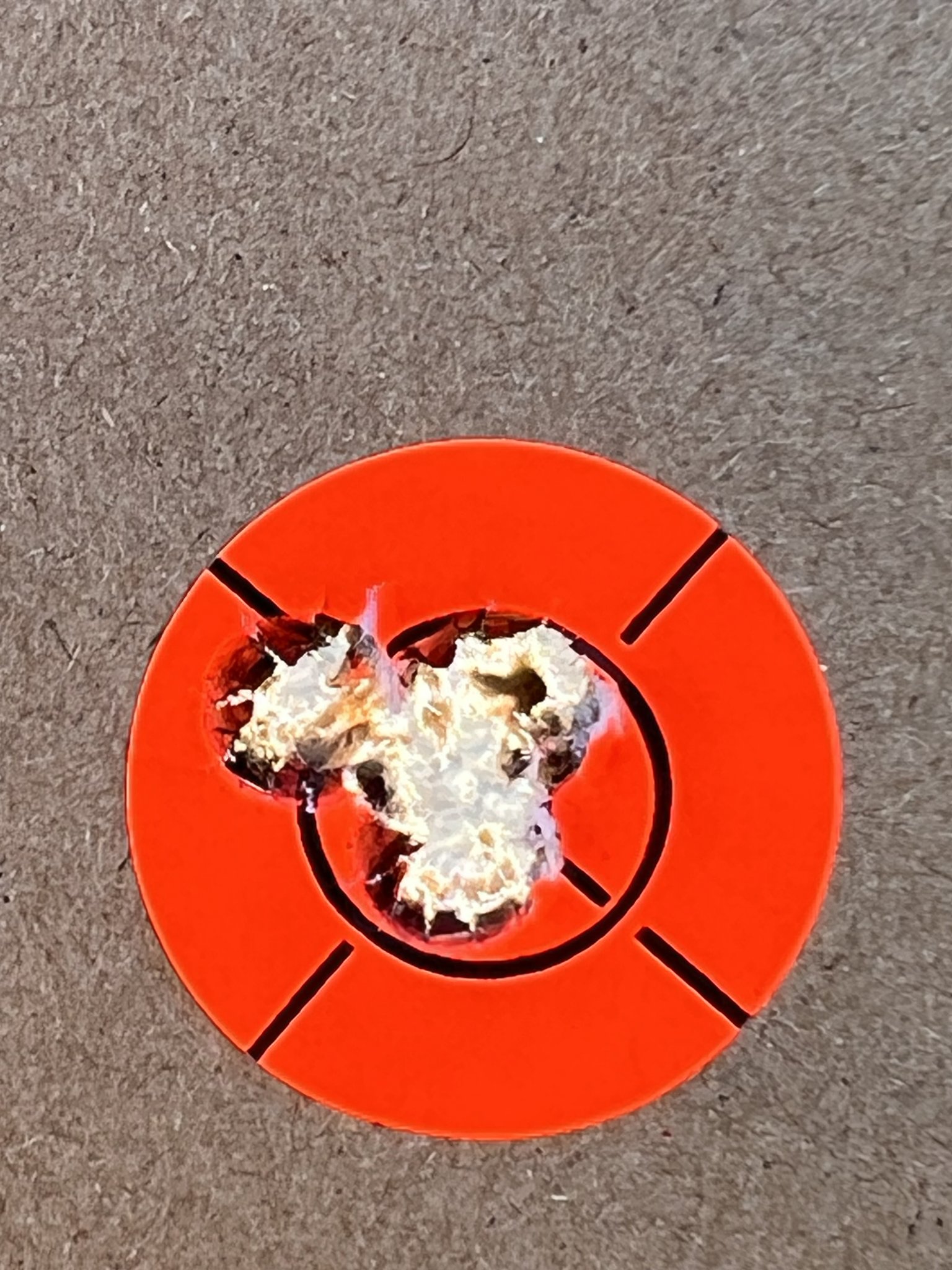

Had its maiden voyage today at the range. Only have Precision Hunter on hand, but here’s an example of 2 groups. Will see how it goes as the barrel breaks in and as I try different loads. Any other recommendations for factory ammo to try? I may start hand loading for it, but am short on free time at the moment.

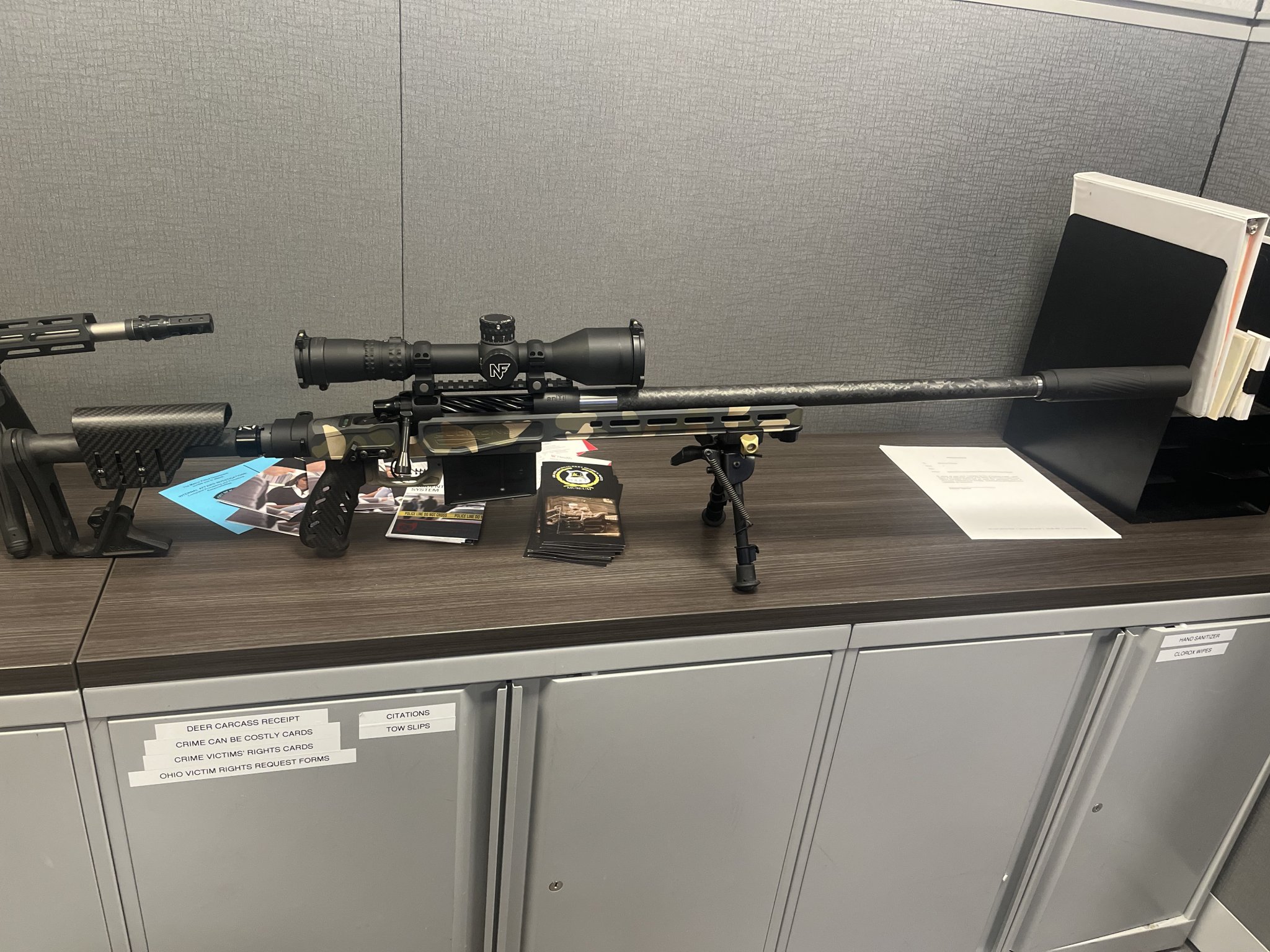

She looks good have the same build being done by SAC, except a manners PH and a 22” carbon barrel. Up in the air with the NX8 To get the 32x or do the ATACR but only get 20x Technically building it for hunting but honestly it’ll be at the range more than anything. That’s where I’m confused by which scope to do. Currently have a 5-25 ATACR but think the 5 is too much magnification for a potential short range animal kill. But also wanna be able to bang steel at 1000 Decisions decisions

Beautiful gun @Ohiohuntr ! I need to get my hands on a suppressor soon. I did take my gun out again the other day and it is starting to tighten up. Maybe some barrel seasoning/break in lol. Who knows, will most likely just end up reloading and trying for bug hole type accuracy.

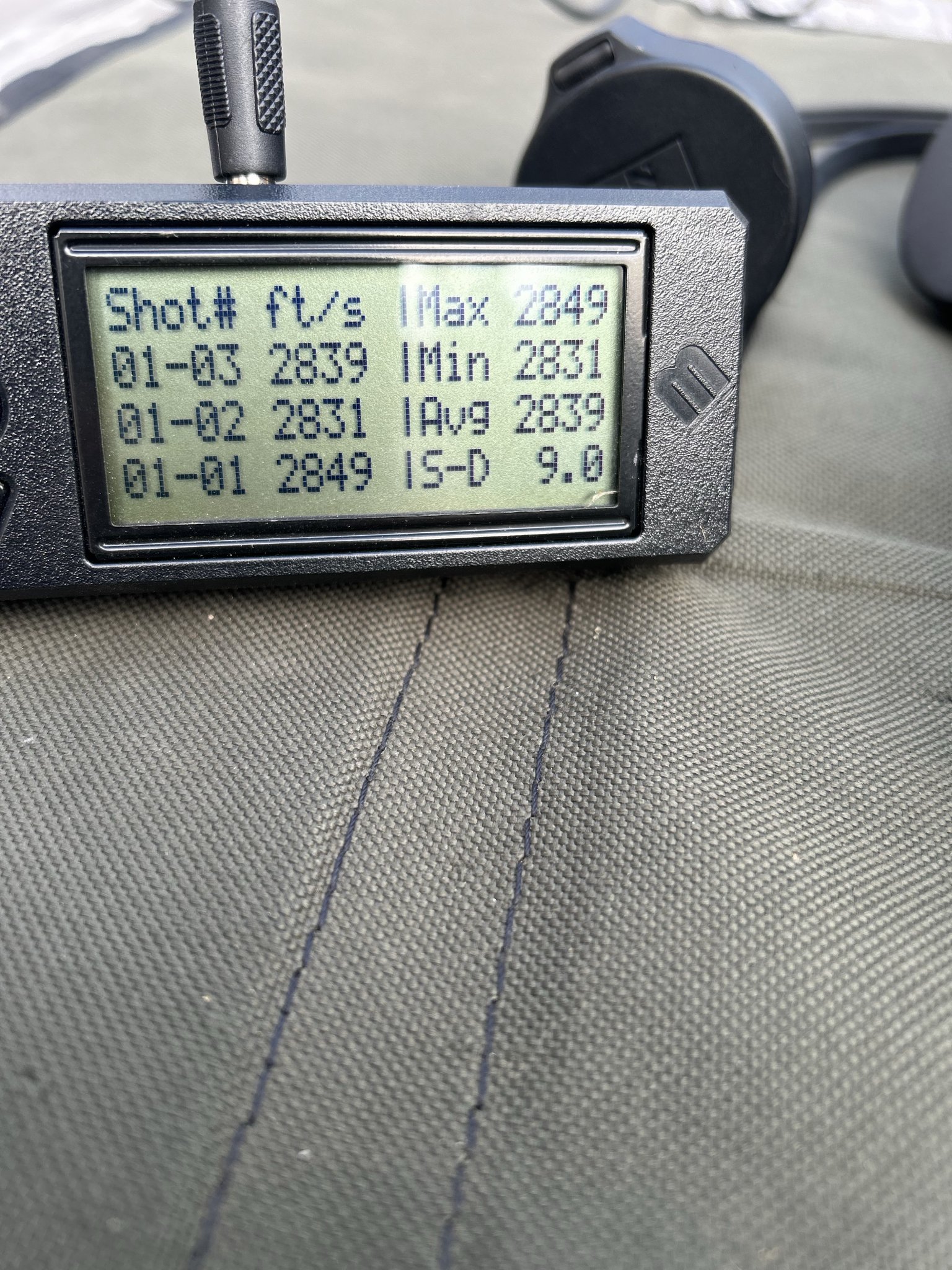

Mine sped up about 50fps with the 22” barrel after about 75 rnds, hanging in about 2925 with the factory hornady 175 eldx, however the gun definitely prefers the 180 eldm in the factory flavors. I loaded up a ladder with H1000 and am hoping to get out this week to see what it likes, I have some 180 VLD’s that I’m gonna do a ladder for as well. Chiefsillyhorse helped me set the rifle up and has been a bad influence on me with these guns lol

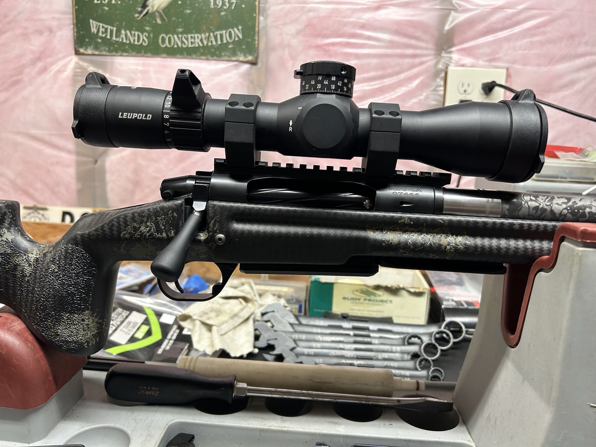

My 7PRC was built with similar components. Origin, 24” Proof, Manners Pro Hunter, Hawkins Hunter DBM, Leupold Mk5 with Gunwerks reticle. I just finished putting 100rnds of factory Hornady (same lot) 175gr ELDX through it over the winter. I was hoping the Hornady load would shoot well at a descent velocity so I could just run factory ammo, but it didn’t. Groups were 3/4” @ 100 and velocity was low. Bbl only sped up 50fps (now 2889) after the 100 rounds. I’ve taken it to 1018 and closer several times and it smacks steel. Just annealed the Hornady brass with an AMP and will FL resize, trim, prime and start load development. Have 175gr Berger Elite Hunters and R26, N570, H1000 and 7828 to try. Not going to try all the powders if I find one that shoots. NM Elk tag draw is mid April 🙏. Good luck everyone.
