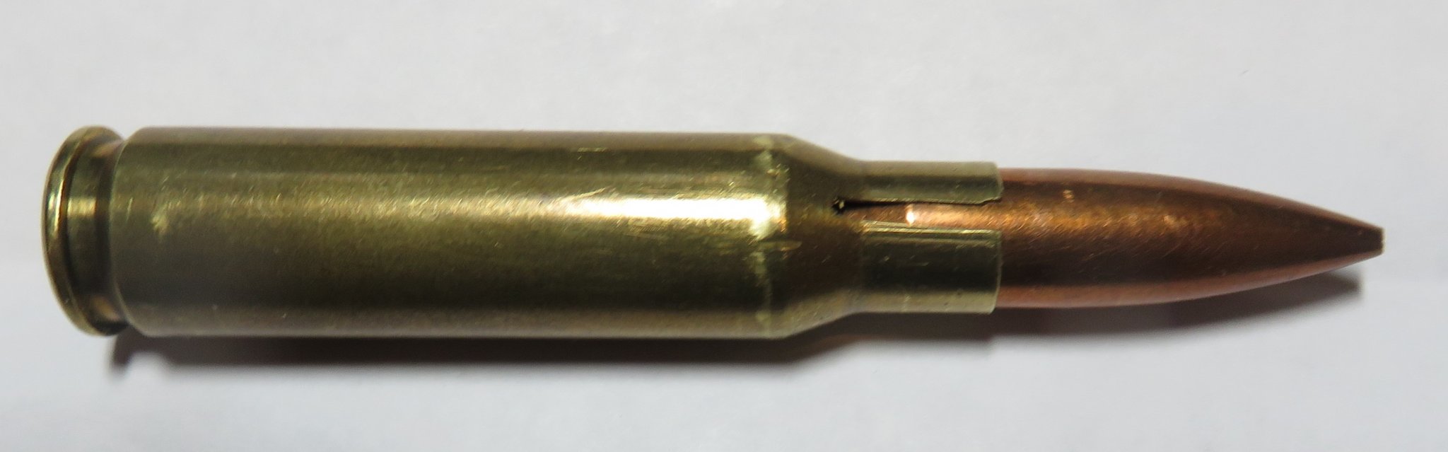

    Below is a pic of my .308 fired case that I cut two slots in to find the lands. The bullets is in just tight enough to slide when I close the bolt and not stick in the lands when I pull it out. It took some practice to get the feel for it where this method has worked pretty well in getting consistent measurements for me (like within +/- .0015").
    Reactions: Dildobaggins
    Below is a pic of my .308 fired case that I cut two slots in to find the lands. The bullets is in just tight enough to slide with I close the bolt and not stick in the lands with I pull it out. It took some practice to get the feel for it where this method has worked pretty well in getting consistent measurements for me (like within +/- .0015").
    What did you cut the neck with? I was thinking maybe a Dremel. With a cutting wheel.

    I was lucky enough to find a Stoney Point OAL gauge at a gun show. I purchased the modified 6.5 Creedmoor case and measured multiple times using a Hornday 140 gr ELD-Match bullet. The readings were a consistent COAL of 2.847". Even if I was off by a few 1000ths of an inch, all you're trying to do is establish the starting point. Using Eric Cortina's process, you take the 'Lands' value and subtract 0.020" to define your starting point. Since everyone's comparator tool will read slightly different, I referenced all my measurements using the COAL with my 140 grain ELD-Match bullets. 2.847" - 0.020" = 2.827". I reference and label my cartridges using the COAL, but I'm actually measuring using a comparator on the Ogive. My longest cartridges were seated for a COAL of 2.827". Then down in 0.003" increments down to a COAL of 2.815". I've never tried making cartridges that are 2.830" or longer.
    Hornady factory 140 gr ELD-Match ammo has a COAL of 2.800". I keep a master 2.847" dummy and a 2.800" factory cartridge by my reloading table. I zero out my comparator caliper using the factory 2.800" cartridge and measure every cartridge I reload. My caliper measurements are then 0.027" down to 0.015". I start reloading with the longest rounds so if I overshoot the bullet seating, I just save that one for a deeper seating depth (shorter length). By the way, even the longest cartridges (2.827" COAL) feed just time from the AICS magazine on my bolt action precision rifle.
    I've found the powder, grain weight and seating depth all play a factor in the group size. For IMR 4350, my tightest groups are a COAL of 2.824". For Winchester StaBall 6.5 it's a COAL of 2.818". For H4350 it's 2.821". To compute my actual bullet jump, subtract those COAL values from 2.847".
    If you don't want to buy a OAL gauge, ask around at your rifle range. If someone asked me, I'd bring my OAL gauge on my next visit for them to take measurements. If they had a different caliber, I'd tell them to buy the modified case at Bass Pro, Cabela's or online. And, most importantly, for them to bring the bullet(s) they plan on reloading. The outdoor range I visit is a fixed price for the entire day, so spending 20-30 minutes helping someone get the measurements they need (or sight-in their scope) is just good Karma in my book. I have people who teach/mentor me on precision shooting and reloading, so I need to pass it on.
    Perhaps I'll just buy the Hornady OAL guage. I'm heading to sportsman's warehouse later today anyway. I'll do that method, and then 1 other, and see how they compare. Can't hurt doing it more than 1 way I guess.
