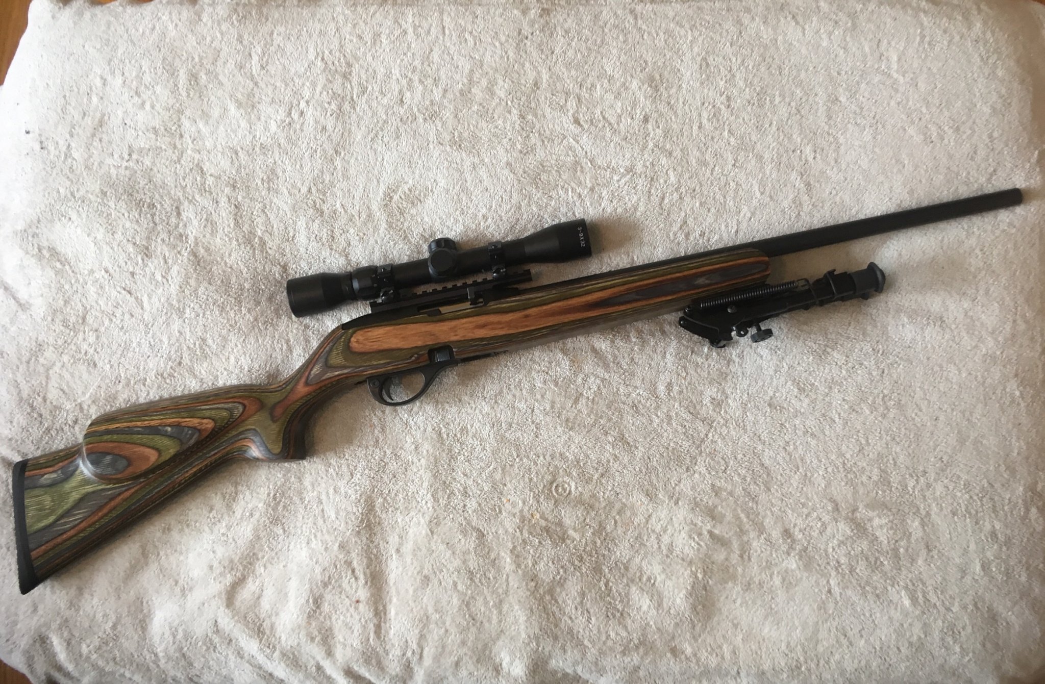

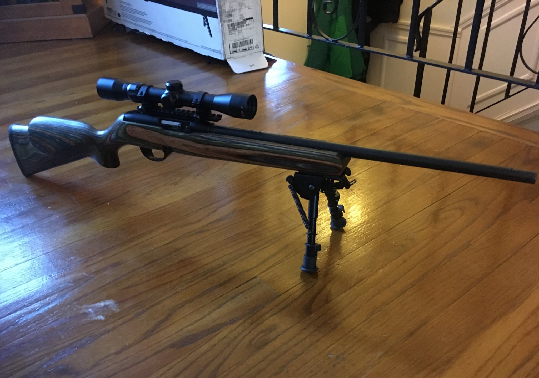

Finished the Remington 597
LongRangeLefty
Shoots heavy loads..
Feb 13, 2017
798
314
Volquartsen target hammer
Volquartsen extractor
EGW pic rail
Cheapo 3-9x32 scope
Lefty trailblazer stock w/ inserts
Went out and shot bottle caps at 50 but I’ll shrink that down. Functions flawlessly. I’m pretty happy with it
The volquartsen extractor is a absolute must do for the 597, turned my jam-o-matic into a flawless functioning rifle.
I found the target hammer to be a bit of a let down, a definite improvement but still very heavy. I recently polished the sear catch area and it made a huge difference.
Enjoy your rifle, I love mine despite not using it very often.
