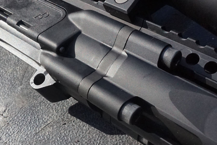

I can’t say I’ve seen the same for the large frame DDs. I’ve seen several students over the last few years that have had issues with large frame DD rifles having POI shifts when shooting off of tripods/barriers vs prone. Often to the magnitude of 4 MOA. 😬
I think you will be ok with either of them. I understand the concept of the receiver extension but I don't think many of us are at a point where we can definitively isolate receiver load as a cause of POI shift. People over estimate their positional shooting abilities especially with gassers.
No, definitely able to isolate the issues with the Daniel Defense rifles. “Student” does not mean incapable.
One particular example was a professional shooter who was running a V3. Her performance was well noted by myself and other instructors present from earlier courses she attended.
She shot well through the entire morning of this particular course, then in the afternoon during the tripod course of fire her POI dropped dramatically down 4 MOA from her 100y zero. Her groups maintained roughly 1-1.5 MOA.
Upon investigation by two instructors the phenomenon was repeated, the rifle zero from the prone off the bipods then moved immediately to the tripod and exhibiting a 4 MOA shift down in POI.
This is not the first (or the last) large frame Daniel Defense rifle I have seen do this and quite frankly it’s not necessarily a problem that’s unique only to them. But the SP10 has not exhibited such things out of the handful I’ve seen. I think the SP10 might be one of the best kept secrets in large frame has guns.

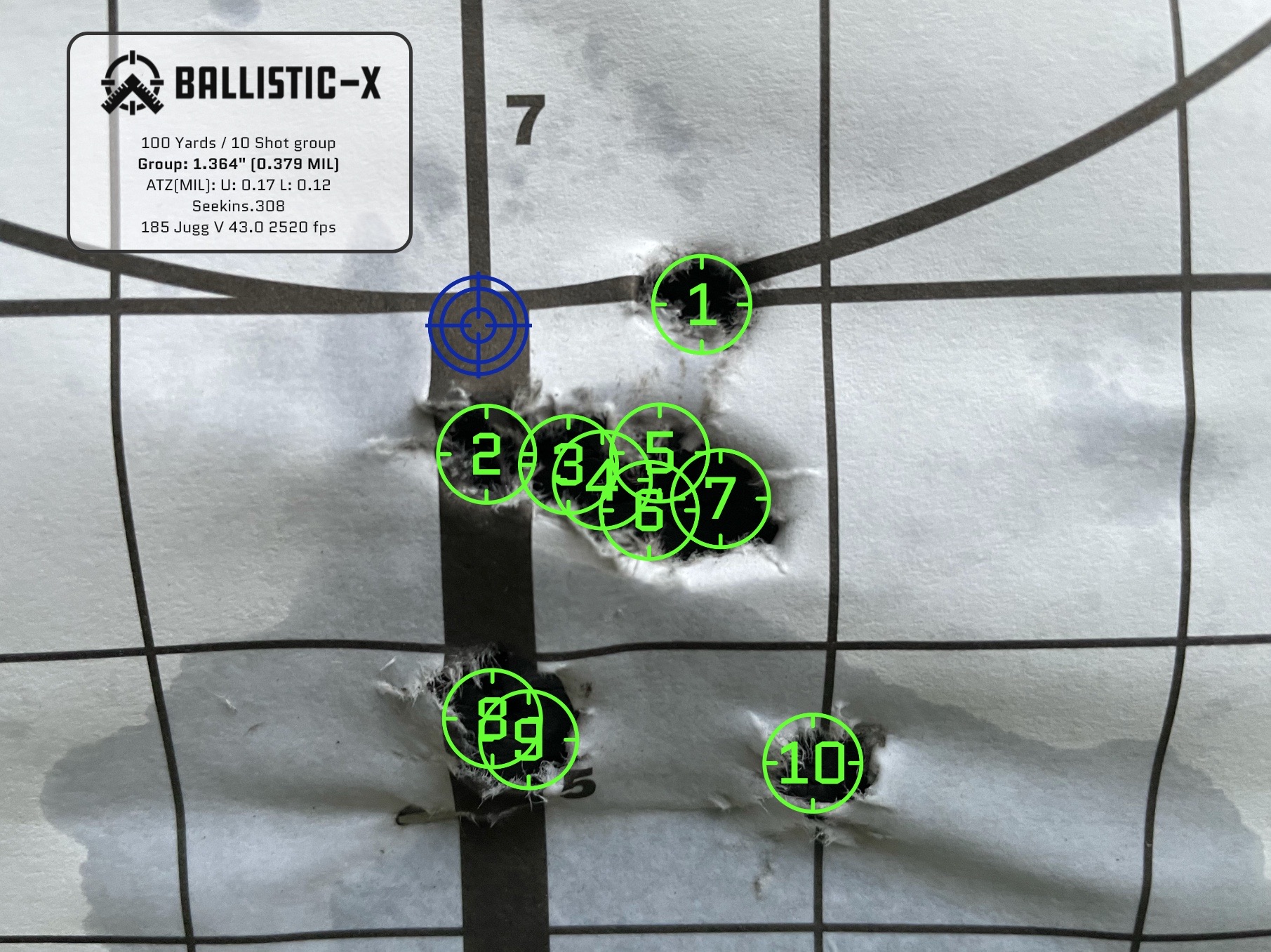

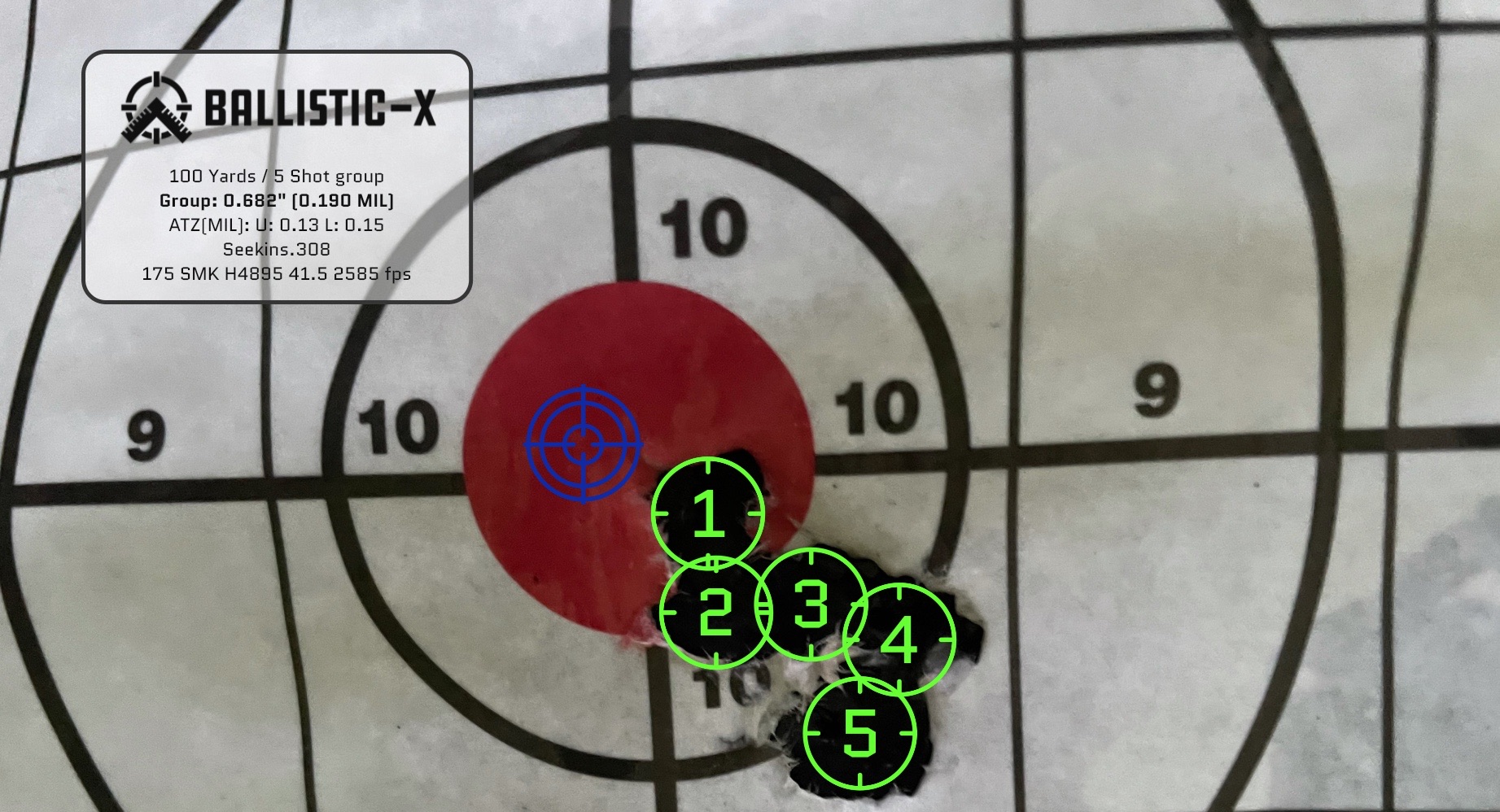

The Seekins .308 builders kit took a year to get. Kept putting me off every 3-6 months. I was told all the parts go to fully built rifles first. That just angered me. Then why sell a “builders kit” if you don’t want to supply it. Or at least be up front about that. Ultimately at 1 year I was fed up and they made it right. I didn’t even need a BCG or barrel! I have a several of their guns and they perform well and have very nice fit and finish.

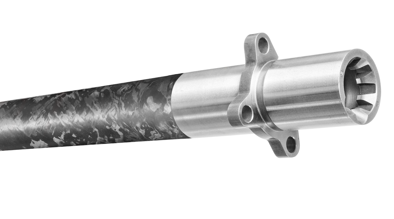

24" is a over kill for .308, I'd recommend 18-20" Stainless, and 1-10 twist is perfect.

I love my Seekins DMR build, probably would have bought a SP10 had a cheap MWS not fallen into my lap.

The problem with the DD V5 is the Barrel/Handguard interface, as shown below the barrel extension utilizes a flange system so the Handguard and Barrel are secured directly to the upper with a 4 bolt design.
The benefits are it doesn't require special tools for barrel/barrel nut removal, but due to the design any pressure/torque applied to the handguard will directly transfer to the barrel causing as stated above a POI shift.

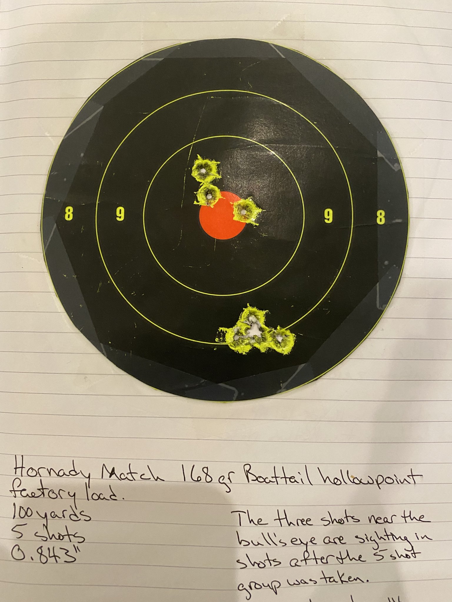

Perfect example here. I can lay down 6 shots 0.65” but then 4 more are scattered. I doubt it’s the gun because I’ve kept all 10 at about an inch. My bolt .308 is 0.8” all day. That’s probably me too.
