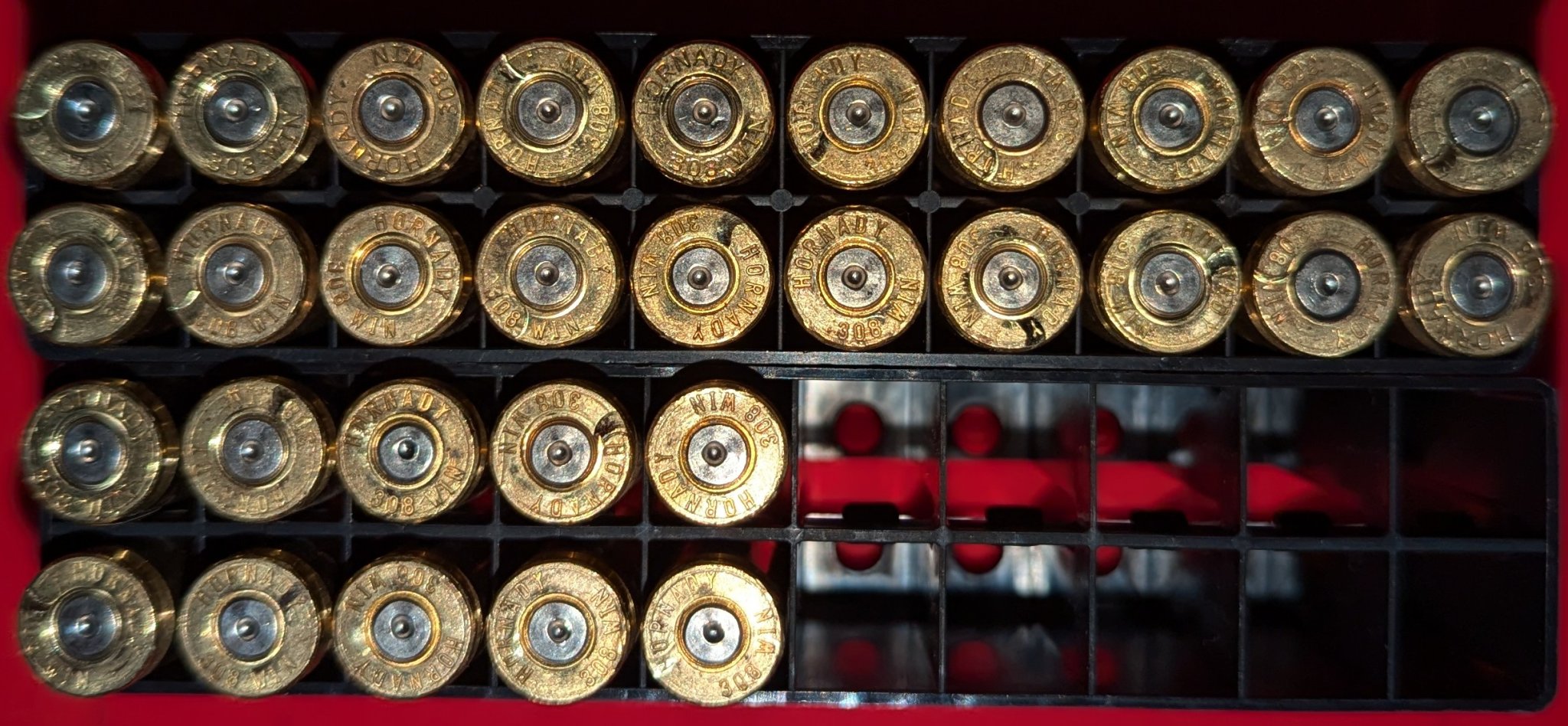

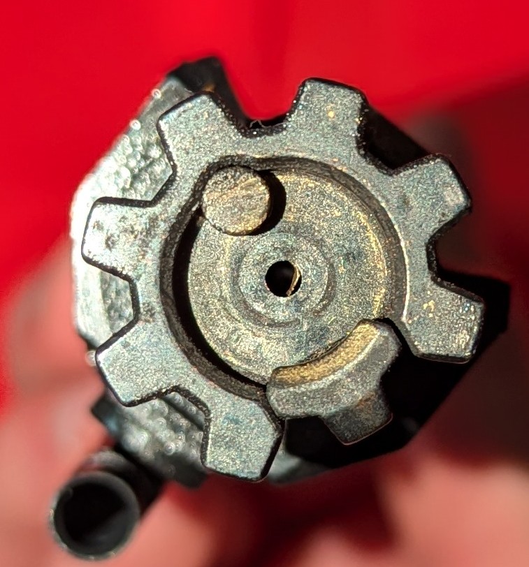

Finally put together the ar10 parts I had lying around and it work great once I got the gas block adjusted but then it started having issues ejecting and seemed to really chew up the rims.
I know the AR10 ejectors are normally pretty rough on the brass but I just want confirmation on what I've gathered from forum browsing.
Based off what I've seen it probably wasn't gassed properly, or the buffer weight was off, but weighing more towards improper gassing
This was running it with empty casings just to test cycling, work work fine then every couple rounds it would either fail to fully pick up a round which is probably cause it doesn't have a bullet or fail to fully go into battery
View attachment 8503977View attachment 8503978View attachment 8503979

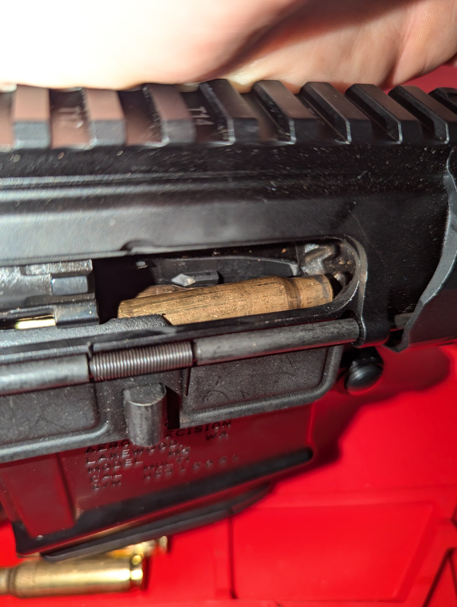

View attachment 8503980View attachment 8503983

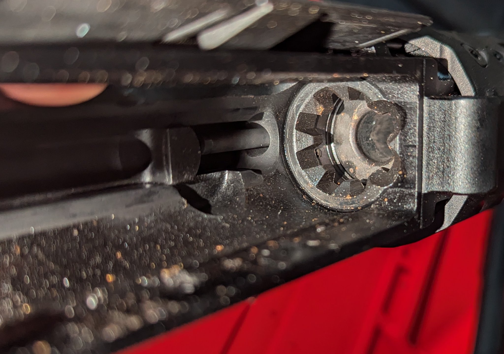

I would round / smooth / polish the edges of the ejector.
Clean out whatever that sliver is in the bolts FP aperture hole.
Polish the feed ramps.

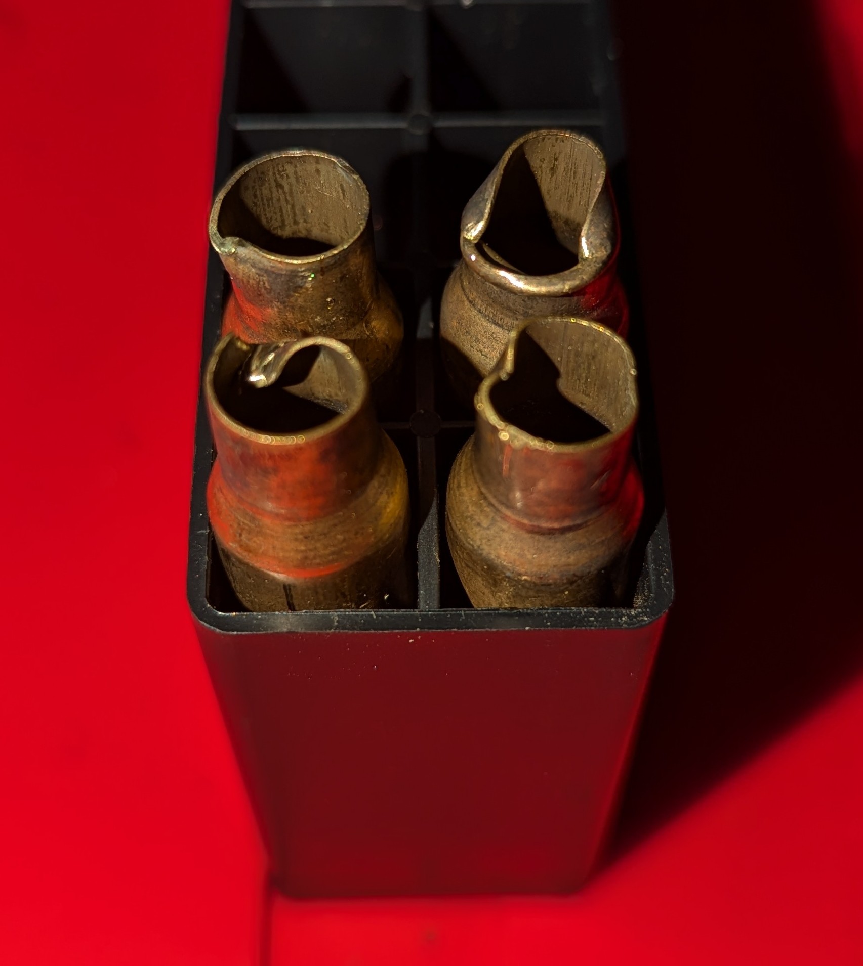

Ummm... yeah don't cycle fired cases... the necks will be to large to seat easily... and .. , well you can see the rest.

That ejector should have a slight bezel on it. It clearly doesn’t. That’s gouging into the brass.
I don’t understand what you hoped to accomplish by cycling fired brass.

PS: I should add that it's a faxxon bolt not aero, I just didn't separate it from the barrel on the build list for some reason

Where exactly would you round off the ejector?
Worked before but now it doesn't? Looks like high pressure. If you shut off the gas and you still have flat primers and ejector imprints, you probably have carbon in the throat. If it's a Faxxon nitrided barrel, they leave a rough layer down the bore that needs to be cleaned out with an abrasive like iosso.
Probably has Nothing is probably wrong with the parts.
Do not need high dollar bolts, most come from the same few manufacturers, made on CNC machines, out of the same 2 alloys of steel with the same heat treat and inspection....and both alloys work well.
Can't tell much from pictures.
The barrel extension has sharp corners, polish them.

Don't be concerned about feeding empty cases....the ones you'll use, will have bullets in them, and the ones that need to feed, and be concerned about.
