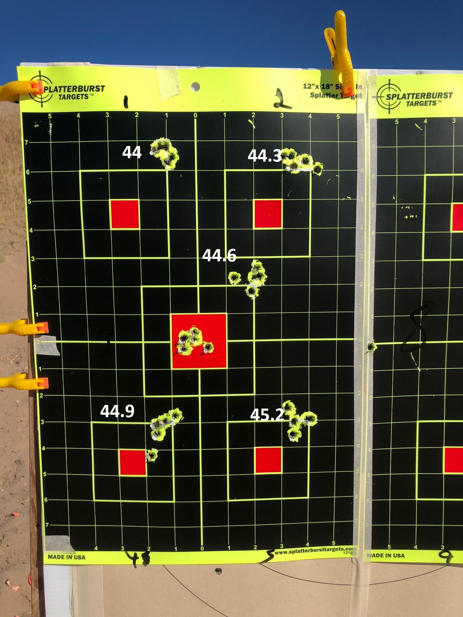

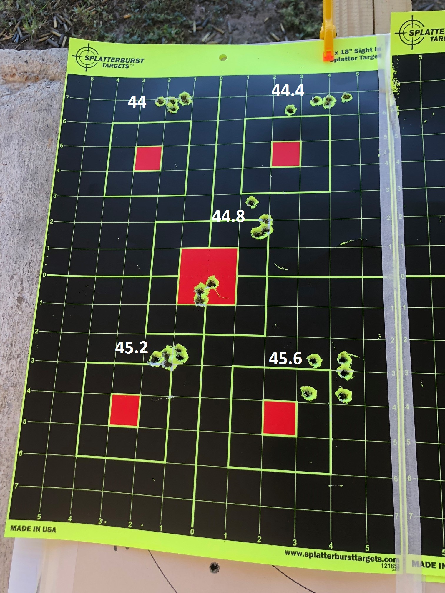

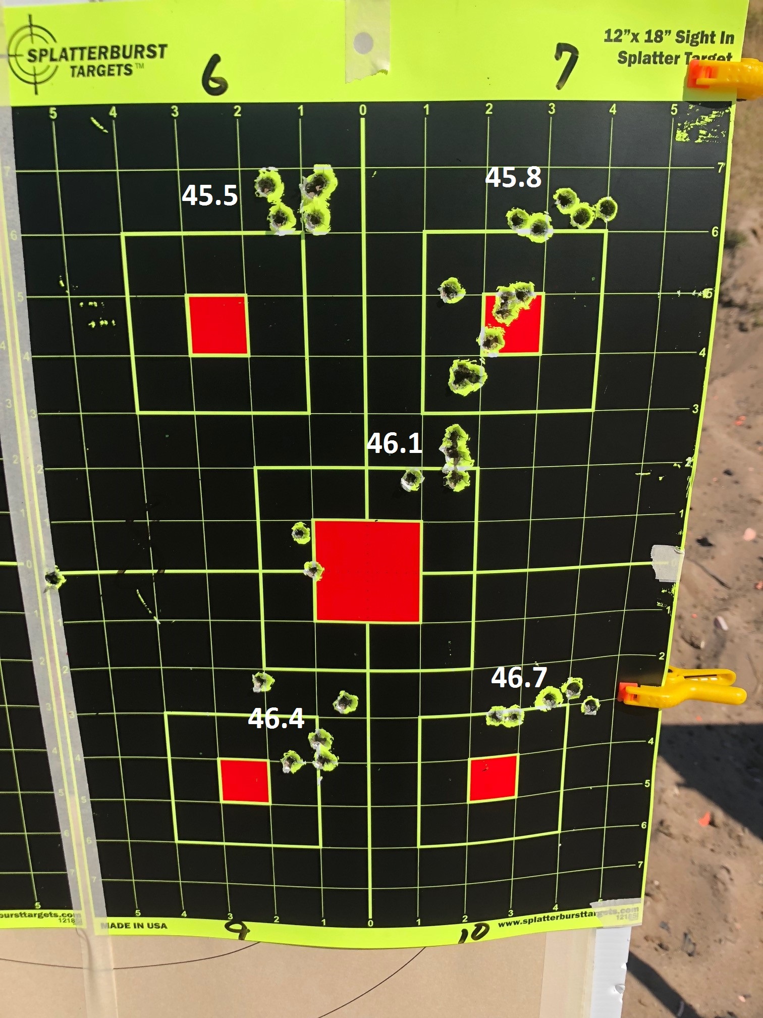

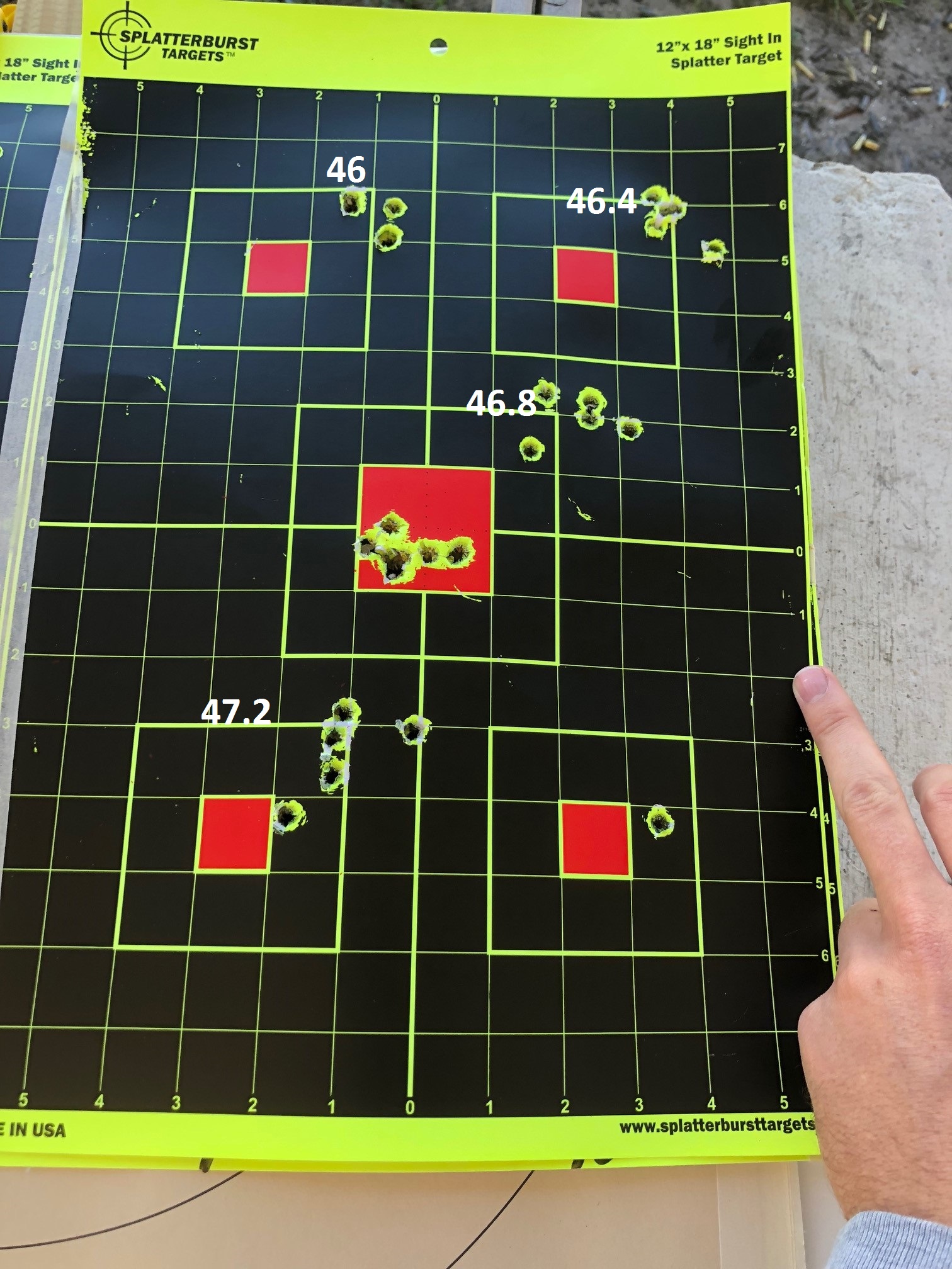

First Batch of Load development rounds, some interesting findings
Maxim0
Sep 28, 2018
130
27
Hello ALL,
I finally got around to making my first batch of load testing rounds up and shot them this past weekend. I did two separate 50 round boxes broken down as follows
My gun has a really deep throat (remington 700 pcr 24" 1:10 5R) that measured in at 2.9385 with the 155scenar. Due to that I did some rounds at 2.8 and the others at 2.9185
155 Lapua Scenar
Lapua Brass
CCIBR2
Varget
using redding match neck bushing and micrometer bullet seating dies
5 of each charge
OAL 2.8
44 44.3 44.6 44.9 45.2 45.5 45.8 46.1 46.4 46.7
OAL 2.9185 (.02 off the lands)
44 44.4 44.8 45.2 45.6 46 46.4 46.8 47.2
The groupings are shown below i'm looking for input on how to proceed. I didn't have a chronograph at that time but just got a magnetospeed in the mail so will give fps with further testing. I noticed no signs of pressure all the way up to 47.2 but was crunching down on powder for everything above 45.5. Will be making a charge tube tonight to see if it helps compress the powder. If it does I will try to find a higher accuracy node.
For now im thinking of doing a mag load (2.8 OAL) @46.1 and a hand load (2.9185 OAL) @ 46.4.
For curiousity sake i did all of this shooting at 100y with about 15mph winds, Do winds impact .308 @100y?
This is my first time ever reloading so any help would be greatly appreciated, also is there software or an app where you can put the picture in and it will give you moa?
Now that I have the magnetospeed I was thinking of working some loads up and just going to the indoor 25y range and get some FPS readings and also explore higher charges (if the charge tube helps compress the powder im worried about hurting my redding micrometer bullet seating die which states in bold letters do not use with compressed loads)
Winds - yes, even at 100 you will have horizontal impact shifts. Especially if the wind is not constant.
Software - https://ontargetshooting.com/ or Range Buddy mobile app.
Without a chronograph... 44 and 44.4 looks to have more consistent vertical dispersion.
You have a little bit of everything not related to reloading with those groups. But if 44.0 turns out to be above 2650...
Also, the Lapua Scenar is not a bad choice though I prefer the 168 SMK with N150.

I hate to say this, but you basically took 100 shots and do not have much to show for it, other than on target #3 44-44.4gr, which looks somewhat promising.
Let's try find a more efficient way to do this. If you shoot 3 shots that look like shit, no need to fire 2 more. I am kind of a 3 shot group guy, and am sure I will get flamed, but I've never ever seen a group tighten up after 3 shots. You can have a questionable group and make it look more impressive by obliterating the center, but it's still the same size.
As for wind at 100, you are not far enough along here to worry about wind affecting bullet flight, I'd be more concerned with the 15mph wind moving your rifle at the firing position.
Reactions: LG65CM and Maxim0
The unmarked shots in the bulls were bought rounds just to warm up the barrel. Do you think my rifle just doesn’t like the scenars? If so any recommendation for 600 yard bullets? Really want to try the juggernauts. But they are expensive and I’m told need to be near the lands which would mean above mag length for me
No not in love with the 155’s any suggestions for my long throat would be great. Would love the have an accurate load that can make that huge jump. Can’t believe my lands are at 2.9385. But single loading isn’t out of the question by any means

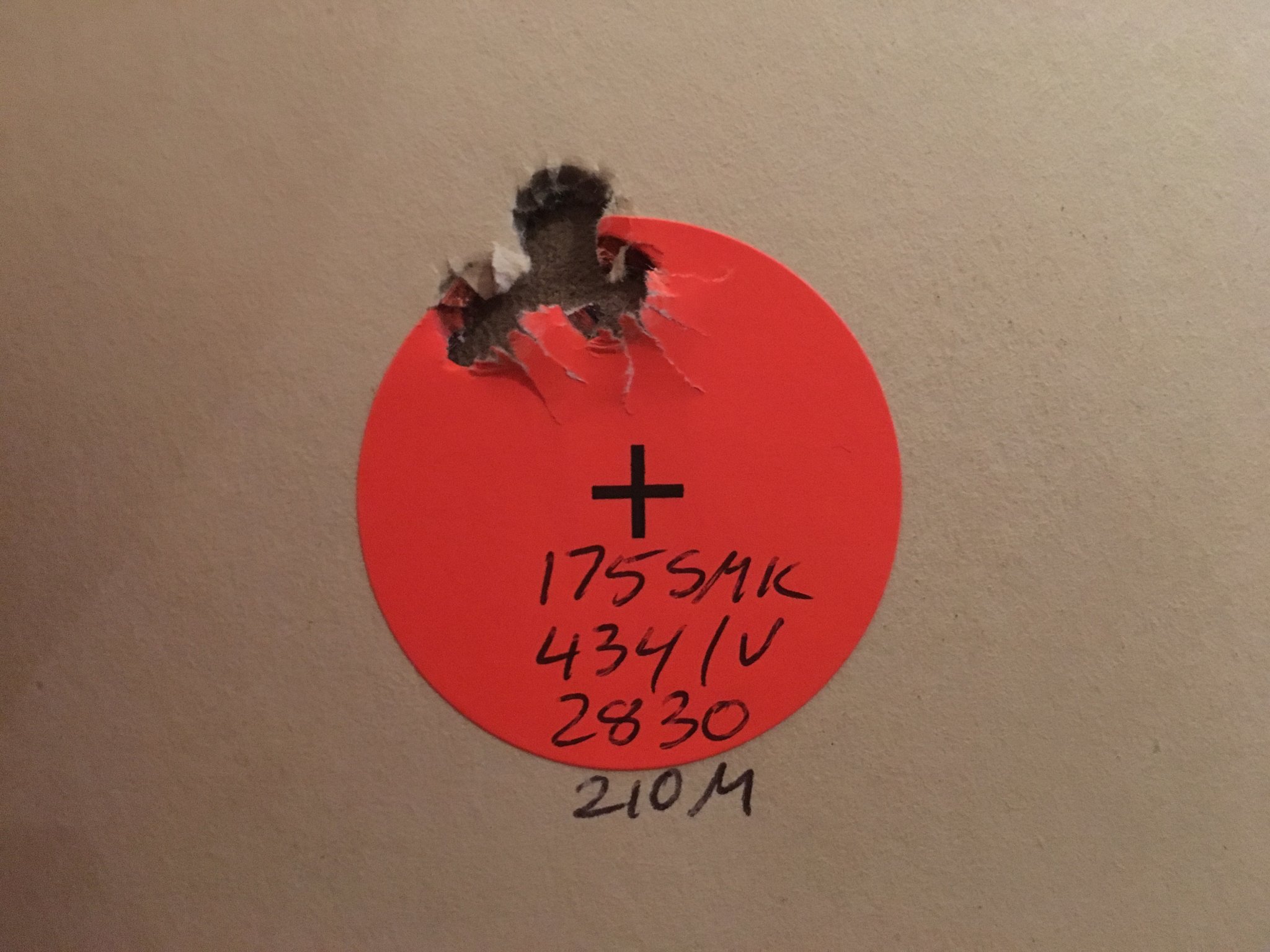

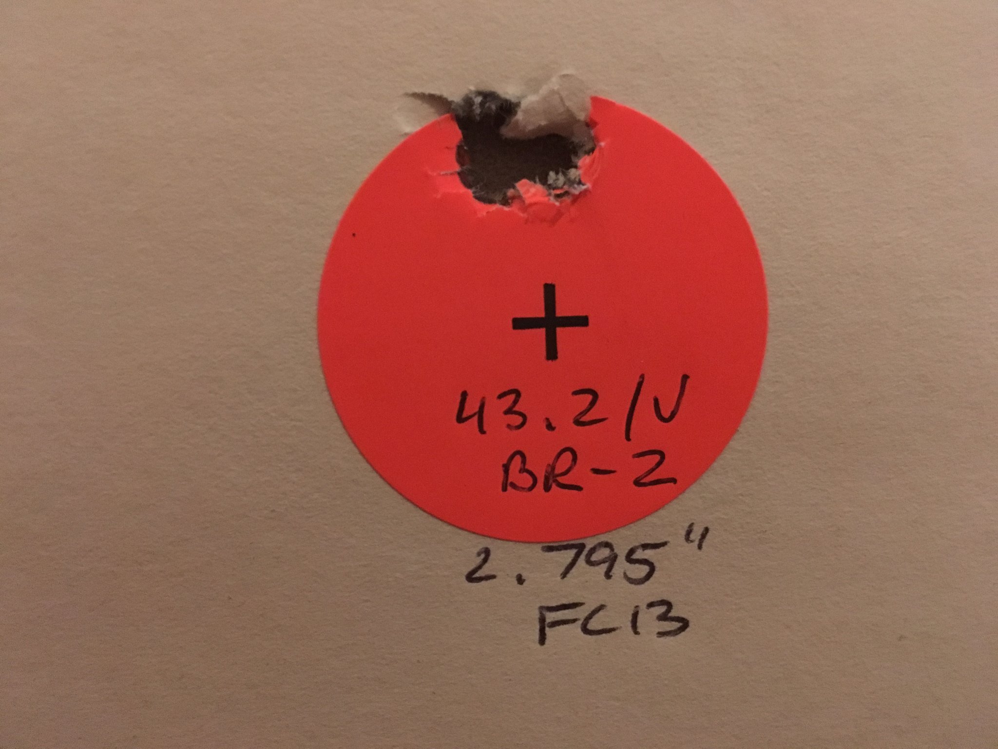

Long jump to the lands does not hurt accuracy. Try 168/175SMK over 43.something grains of Varget at 2.795”-2:835” coal. I got a new 308 last month. This is 168SMK:
This is 175SMK(still needs some tuning):
Basically these are the same loads from my old 308. The 168 is jumping .065”, the 175 .030”
