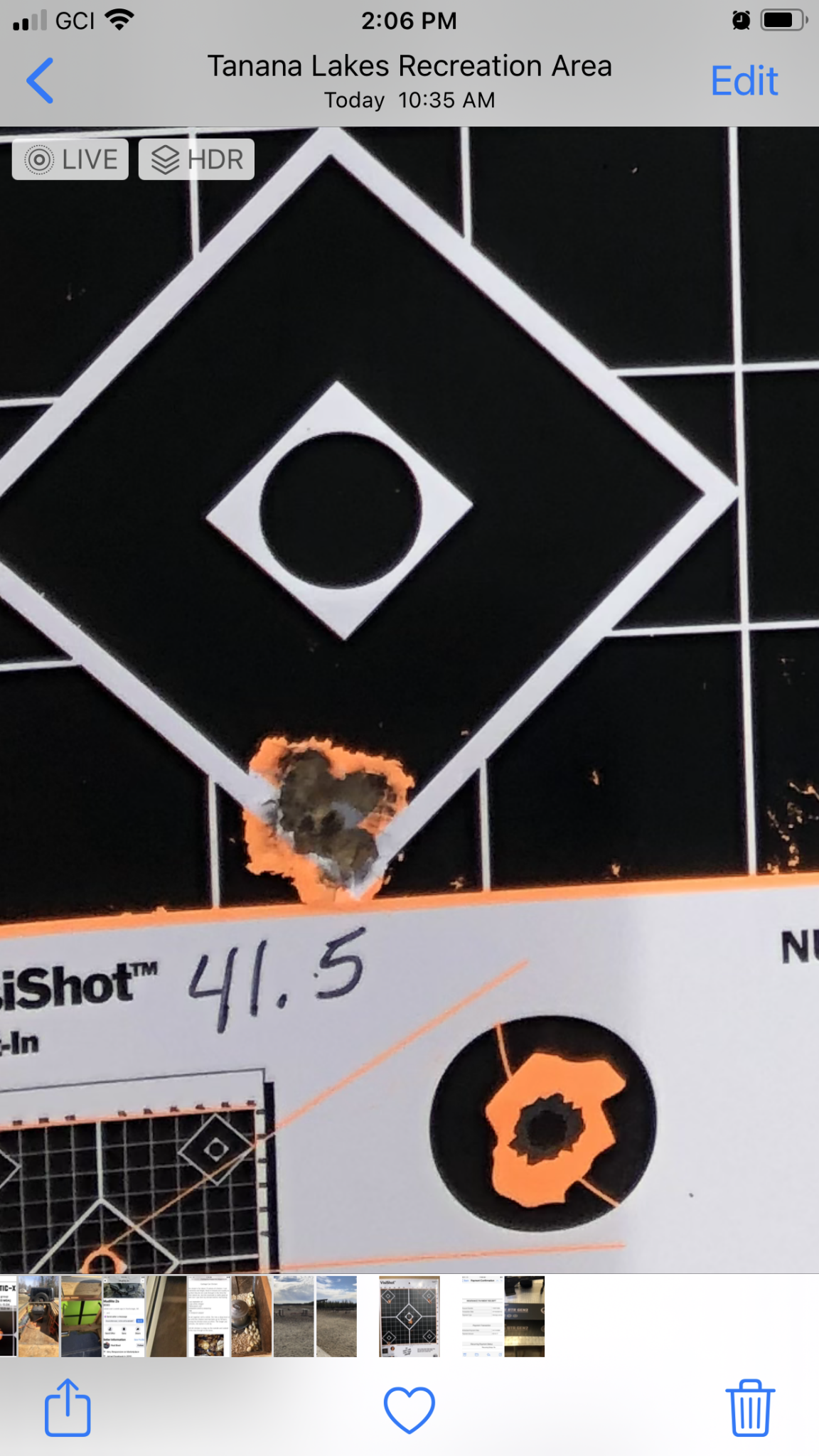

Ok great thanks, 41 was a good group just had slight swipes, if I find a charge with a good group will changing seating depth make it go to shit or does it typically follow the charge through different seating depths? I’ll back off .03 and go from 39.5-41 and see if it still shows pressure

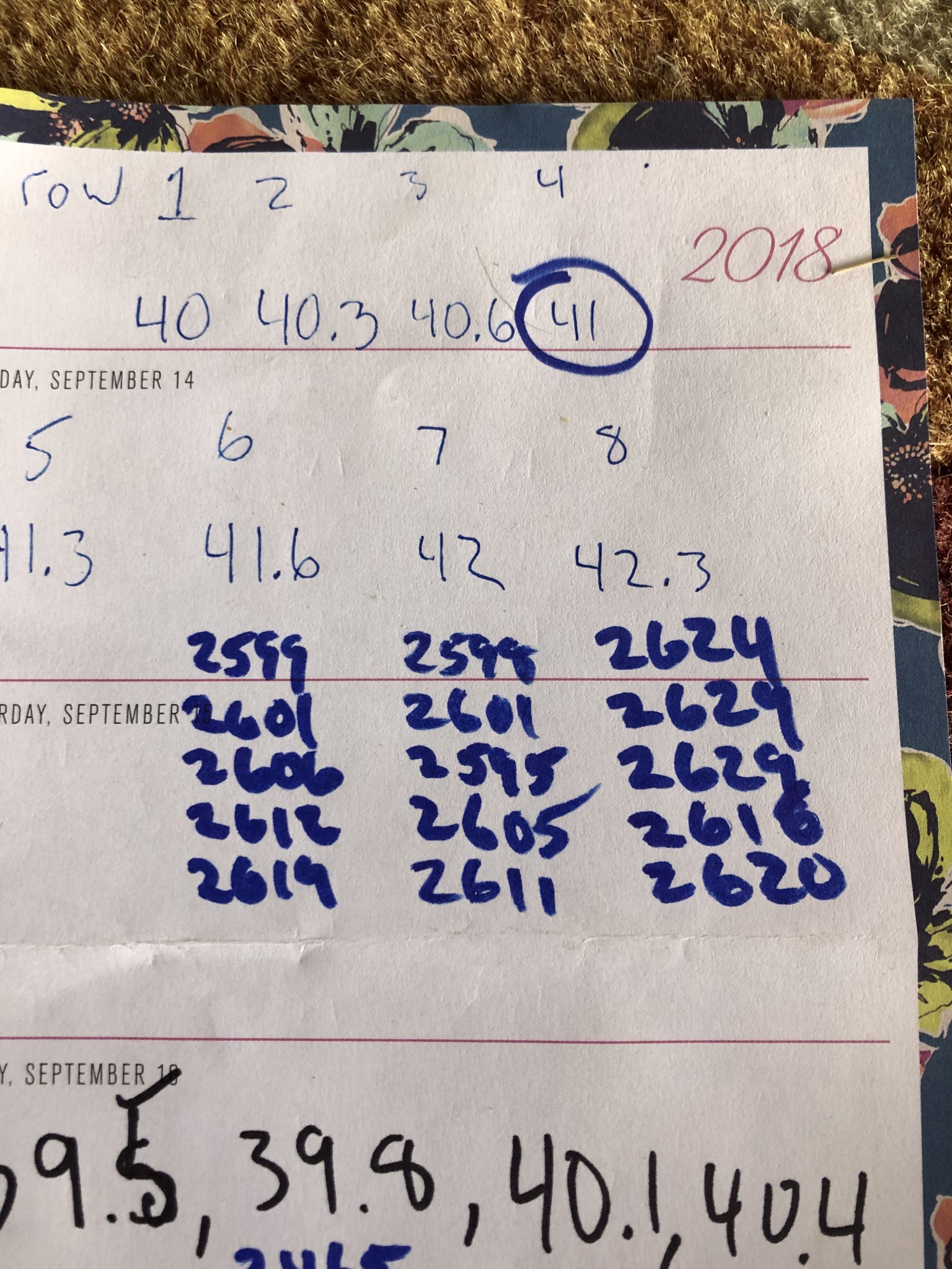

On the advice of others on here I ran a ladder to check velocity and pressure with H4831sc and the 147eldm. The group for the ten shot string was very similar to what I observed with H1000 with more speed but very little vertical dispersion over a 2.7 grain spread.
I wasn't totally focused on the group but wasn't being sloppy either.
6.5 Creedmoor Lapua brass
CCI450
43.3 2524fps
43.6 2555
43.9 2594
44.2 2615
44.5 2655
44.8 2656
45.1 2689
45.4 2689
45.7 2724
46.0 2732

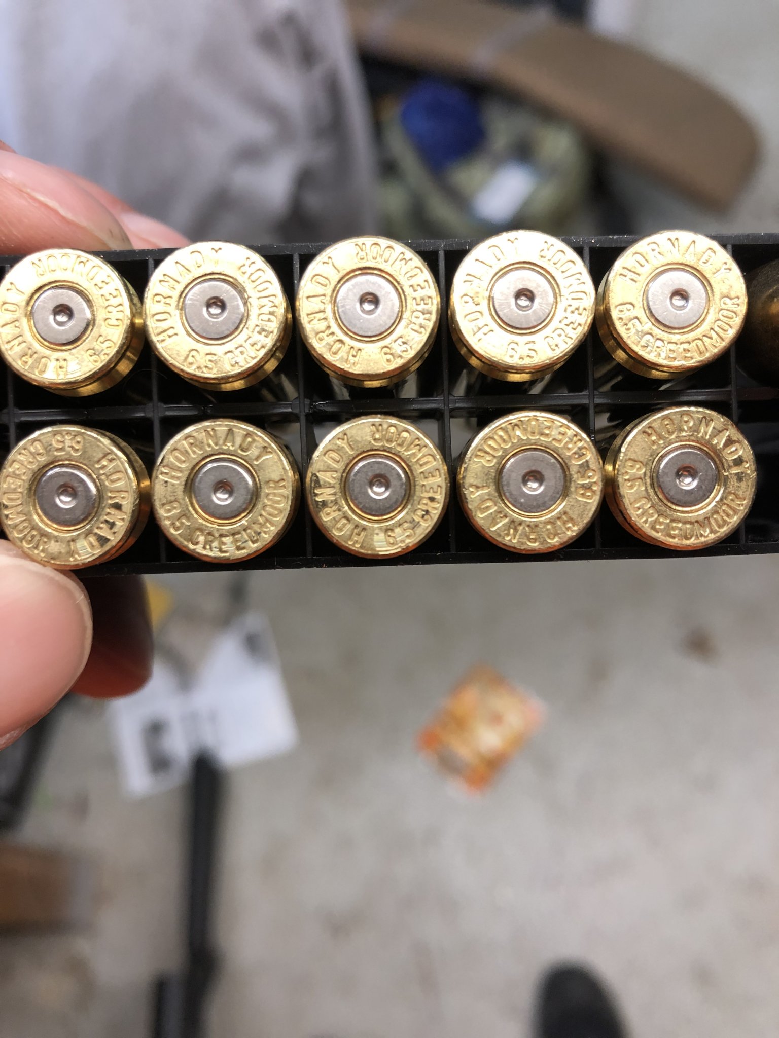

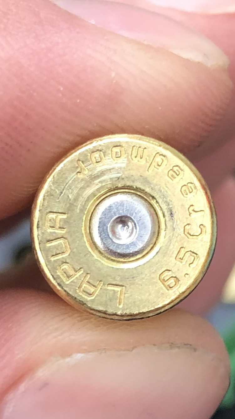

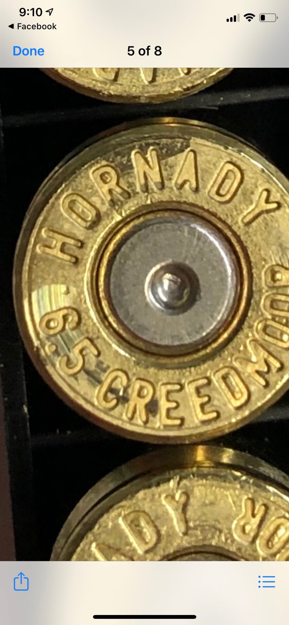

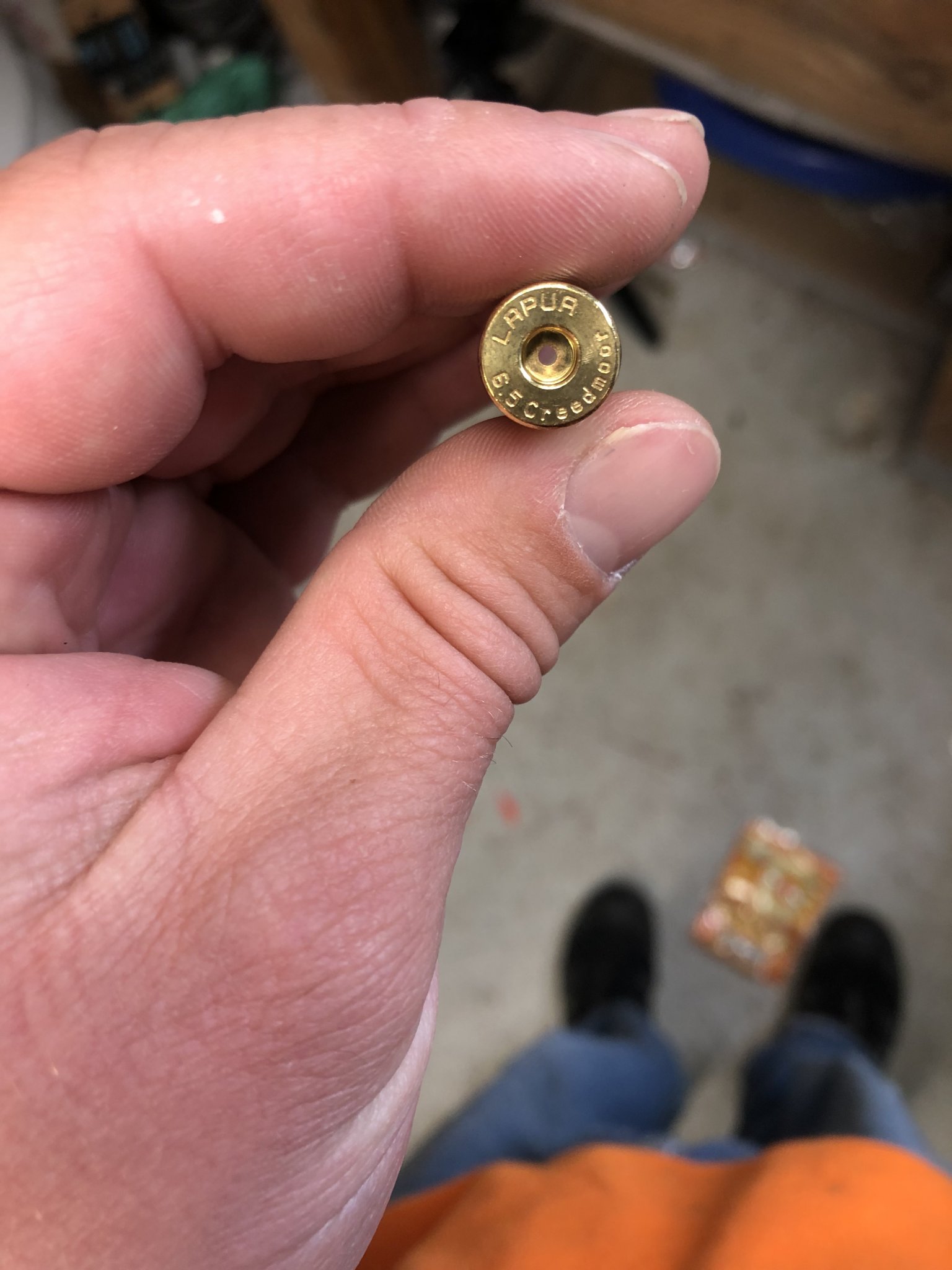

Ok fellas something is not right with the Tikka, all of the cases showed pressure even at mild charges, I looked at the cases from the first box I put through it factory hornAdy 140’s all of them show pressure as well. I chambered a brand new empty lapua case and when I ejected it there were marks from the extractor, I chambered it 3 times and this is what it looks like.

Ok fellas something is not right with the Tikka, all of the cases showed pressure even at mild charges, I looked at the cases from the first box I put through it factory hornAdy 140’s all of them show pressure as well. I chambered a brand new empty lapua case and when I ejected it there were marks from the extractor, I chambered it 3 times and this is what it looks like.View attachment 7310743View attachment 7310744View attachment 7310745View attachment 7310746
Nothing is wrong. What you have is a minimum headspace dimension chamber with brass that essentially is "perfect fit" from the bolt face to the datum on the shoulder.
Load, fire, reload the brass. Rinse, repeat. Have fun.
Reactions: MudMuppet
Thank you, there’s a little resistance closing the bolt with a case and nothing when empty, is that of any concern or just run it as it?
Yup just a little snug, I take it I’ll just go off velocity because I can’t read pressure sign

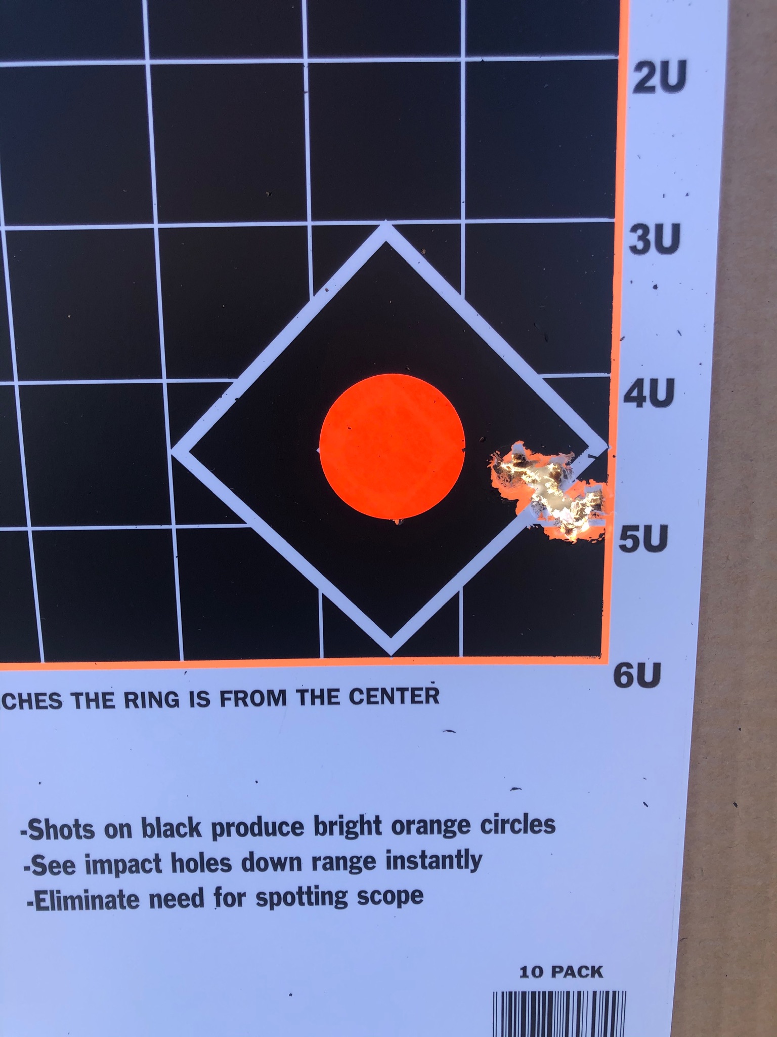

I ran a quick and dirty OCW test yesterday with H4831SC and the 147eldm in once fired Lapua brass.
The 45.4 charge was the only one that was 4 rounds and I believe would have been better but I really think I pulled the last shot when one of the guys a couple of benches down touched off a 50BMG as I was breaking the shot.
Either way the first 3 rd group was cold bore included and was .063" so can't really see improving on that.
Not bad at just shy of 2700fps from a 23" barrel with the 147eldm.
Barrel is a Bartlien 5r M24 profile 1-7.5 twist with SAAMI. 199" FB chambered by Kelblys
I need to load up 30-40 rounds at 45.2 and see how they hold up at 600 and 1200 yards when the winds aren't being to bitchy.

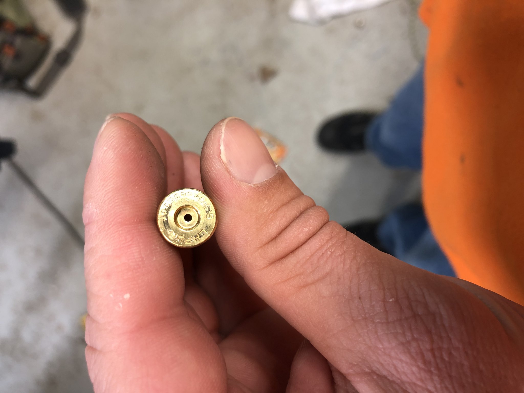

It’s really stiff it takes a lot of pressure to depress it, I image that’s what it ejects brass 5 feet if I don’t catch it
So long as it will fully depress until it is flush with the bolt face and doesn't have any sharp edges on it I'm sure it's fine.
Just give it a good look over, if you see that it is shaving brass off remove and smooth any sharp edges if you have the tools to do it.

Yea there was brass flakes all over the bolt face, I put a new piece of empty brass in and chambered it ran the bolt a few times and I can see where it’s making contact on the shoulder. Then I sized a new piece of brass and same thing
Sounds like your chamber is at minimum spec for headspace or just slightly under.
If your die will bump it back enough to give .0015-.001" headspace that's probably about as good as your going to get.
Better tight than sloppy.
I set up my 243win with minimum headspace and it's perfect with everything I've tried but Nosler ammo and brass is a bit tight similar to the issue your having.

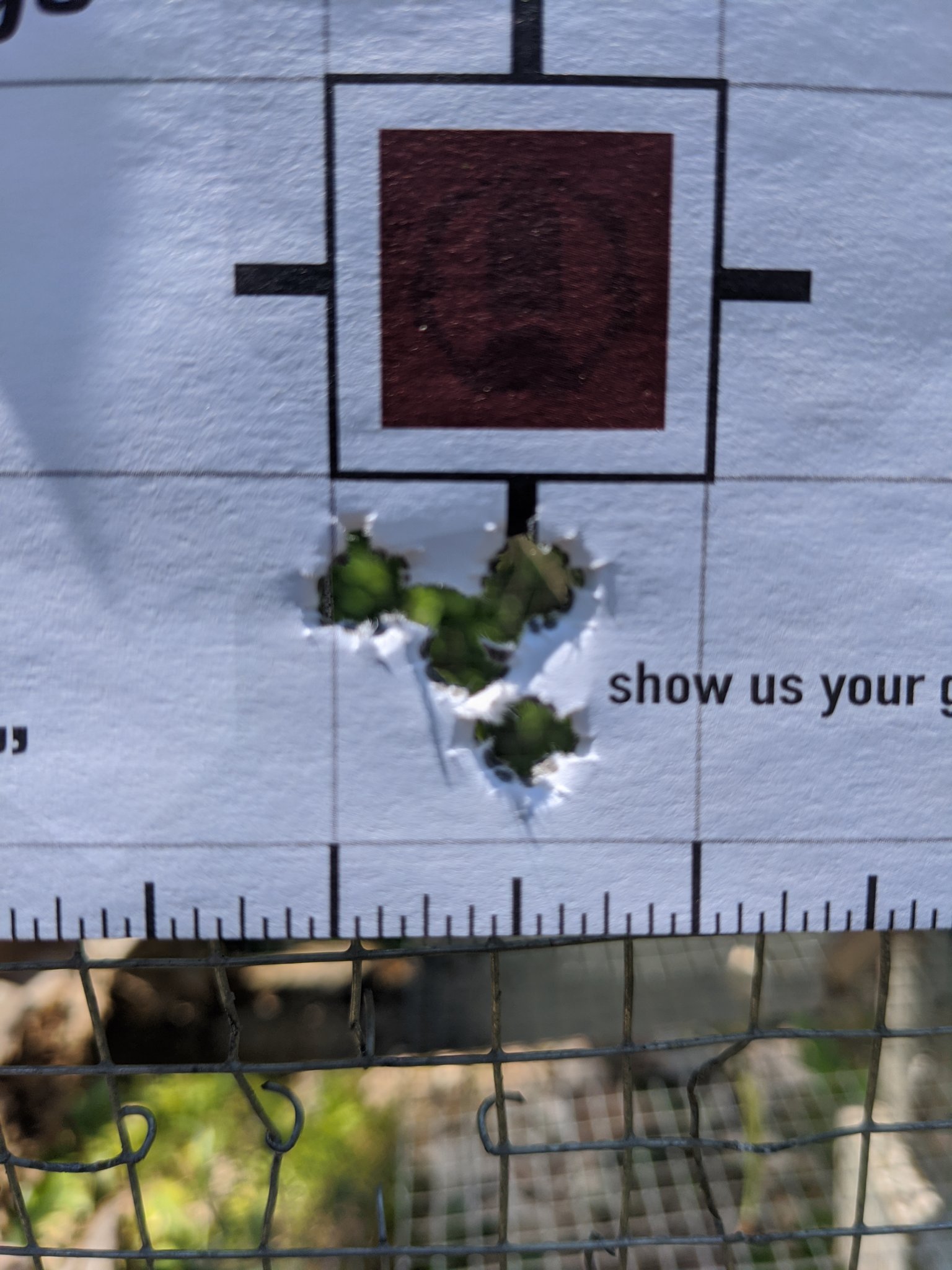

5-shot group using 41.8 grn of H-4350 with 147 ELDM’s.
that was my old load in my Savage as well. shot quite well and good SD's. was able to pull 1/2 MOA groups at 875 yards before my barrel started opening groups.
not sure it works on all rifle but some people seem to have some really good luck with this combo @ that charge.
hopefully you got this issue sorted out. I'm not 100% convinced what your seeing is pressure especially with what appears to be zero flattening of the primers ( I don't mean flattened but those are very round!) I would imagine something to do with the bolt/chambering as your already investigating, did you ever find out what's causing this?
I think so, seems like a tight chamber and when I pull the spring for the plunger it doesn’t mark the brass anymore. Also when spring is out of bolt and I chamber a once fired round it still binds up a tiny bit closing the bolt but when I take the same case and bump it back .003 it chambers fine. It shoots fine so I’ll leave it till I put a new barrel on
In the T3 X that’s a little unusual…
It is very common to have the bolts start to stick as the action warms up and you go to extract a somewhat hot load.
I ran into this problem with a stock ticker T3X TAC A1. LRI makes a replacement bolt for these rifles that is boron nitrate coated, which helps a little bit with the sticky bolt syndrome.
Most factory ammo performs flawlessly in my rifle, but spark ammunition tends to start the stick after about 10 to 15 shots. Part of this is due to the design of the rifle and small angle bolt lift design.
After replacing the barrel with a proof carbon fiber drop in, I found this thing shot really well out to 1000 yards in lowlights class. (at least until I change to some thing that had a dramatic impact on where my rifle was doped to…)
Even with the rounds traveling at 2650 to 2670 I was having no problems hitting targets at distance… so I’m not really convinced that the 147 grain ELDM bullets from hornady need to be moving faster than 2700. I guess in an ideal world they be traveling at 2850, but the stories abound of these bullets not doing well at high pressures… Especially when they do perfectly fine in highwind and out to 1000 yards.
If the bolt is sticking when you chamber into the factory barrel then that’s because the brass is thicker than other factory brass…
I replaced my barrel and it likes 147 ELD-M with 41.5 grn of H4350.
What was the velocity? I'm tuning Berger 140's right now and have a reference load for my Tikka T3x TAC A1 that groups like that, but I use 43.4gr of StaBall. My average velocity is 2660 with SD's of 5.5-ish. I'm shooting for distance so the velocity matters.
My average velocity is 2789 with SD of 4.5 and ES of 12. I’m running a 26” barre.

LC Brass at a variety of charge weights. Settled on 24.0g of N140 with 77gr SMKs. No other pressure signs so I'm guessing similar to the poster above that the brass is slightly thicker or sprung back a hair more or something...
