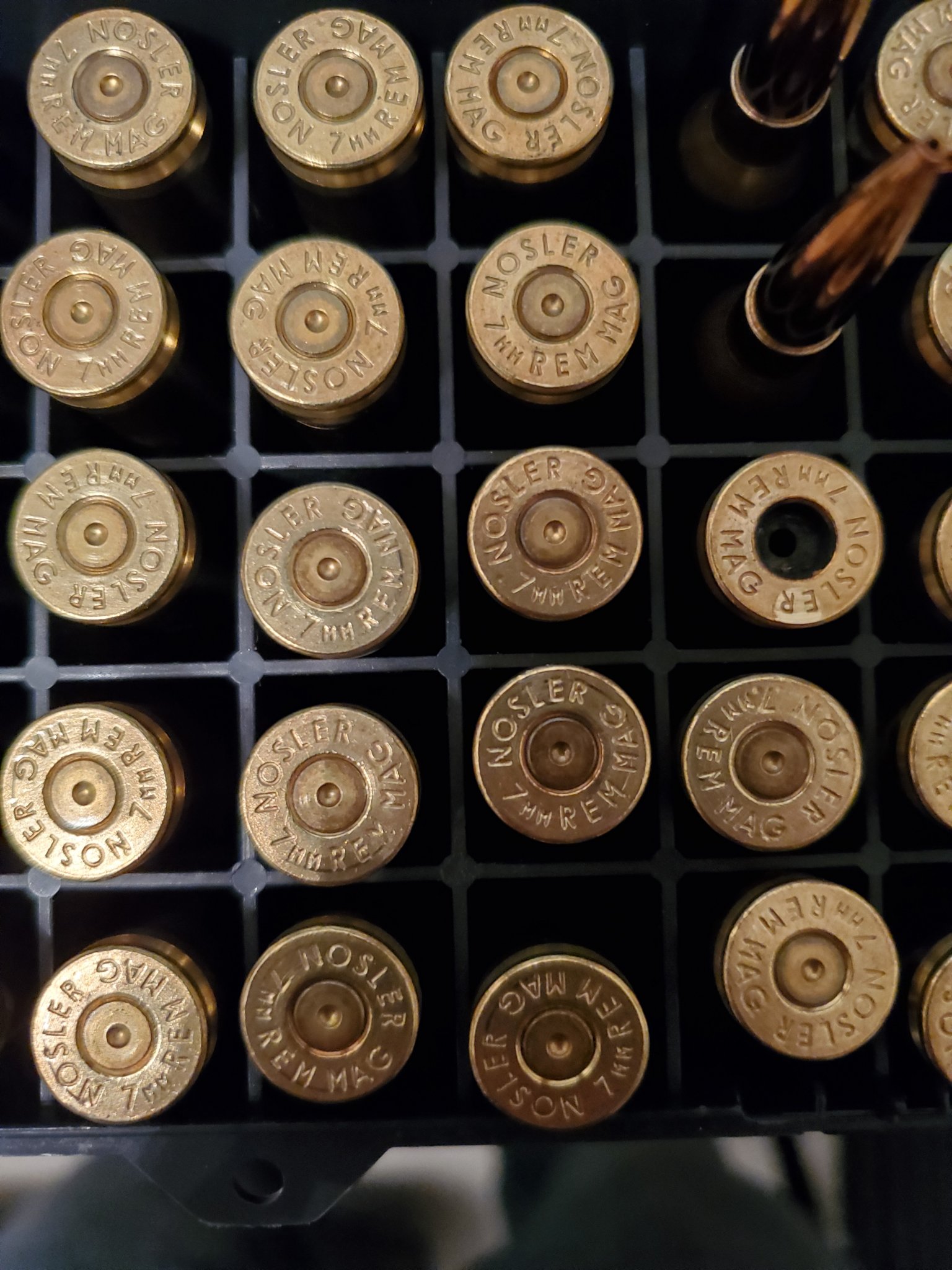

I was fine tuning this load a few days ago, and blew my first primer. I was testing three loads in two nodes that showed promise from a few weeks ago--the one listed above, a slightly heavier (70.9gr) variant, along with a lower node using 60.9 gr of N570. None of the rounds showed pressure signs that I could see (nor did slightly heavier charges I tried in the earlier test round). However, the original test was done in ~75* weather, whereas the one from a few days ago was done in ~95* weather (although under cover, out of direct sunlight). The headstamps of the 20 rounds in question are pictured below, although I obviously didn't fire the last two after the primer blew on #18.
As you can see in the picture, the one that blew has a clear ejector mark, but none of the previous 17 rounds did. On the one or two before it, I thought I felt some stickiness in the bolt lift, but I wasn't sure if it was my imagination, since I hadn't had any trouble with this load up to this point, or with a couple of test loads that were a little bit heavier. I also didn't see anything on the case head indicating I should stop. The one that blew was #48 fired that day. For what it's worth, I had been using a home made barrel cooler between each 5 shot string to manage the heat buildup, and shooting the three loads being tested round robin.

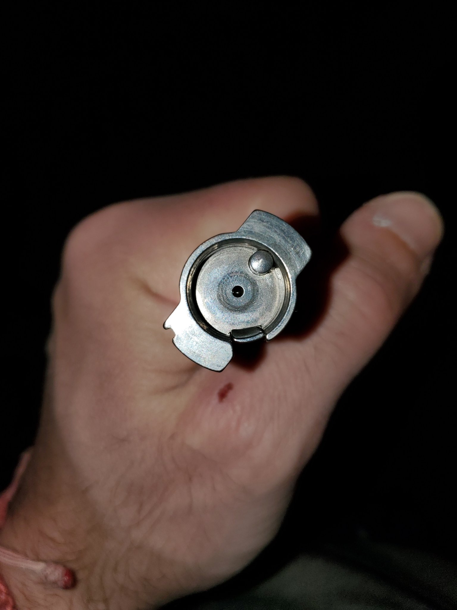

Here is a picture of the bolt face after the shot:
I got the load recipe from Berger over the phone, since there isn't data published for the 184gr F-Open bullets yet. Naturally, they cautioned that I should watch for pressure signs, which I thought I was doing, but apparently not. To my admittedly untrained eye, it doesn't look like I damaged the bolt face, but I'd appreciate a second opinion. As for the brass,

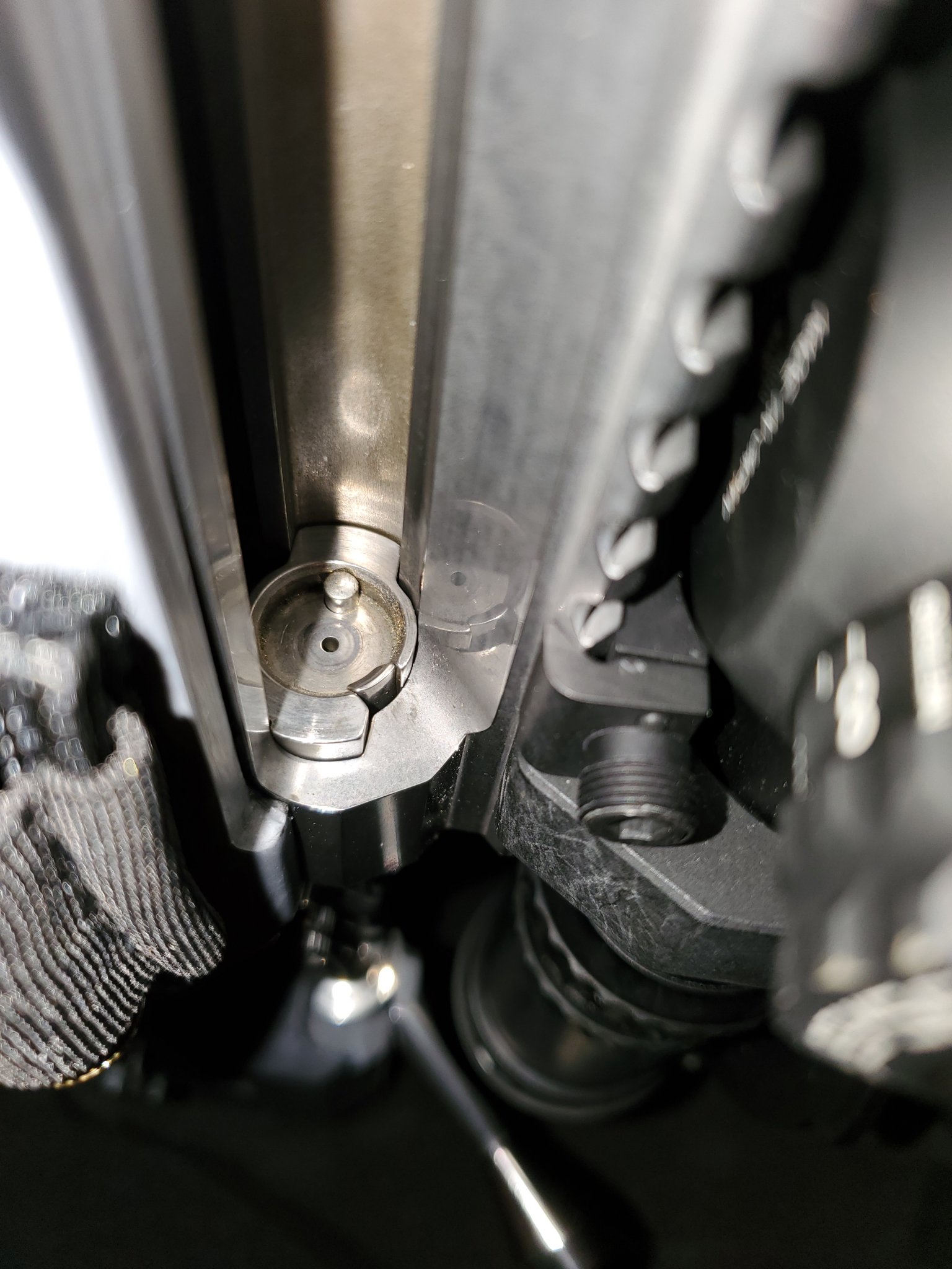

Clean the bolt face to see if there is any pitting. We can’t tell from the pics.
Were your primers seated properly? I only ask because the ones in the lower right of the picture are canted and a couple look to have two small leakage lines from them. And the third row second from the bottom appears to have a mark on it over the L. Could just be the lighting in the pic.
Could it be the primer it’s self? I know Winchester primers run a little on the small side. How did the primers feel when seating them?
I only ask because I have had issues with nosler 308 brass and Winchester primers. After a couple firings they seat very easily, almost too easy. I switch to cci200 and haven’t had an issue.
Just a thought.

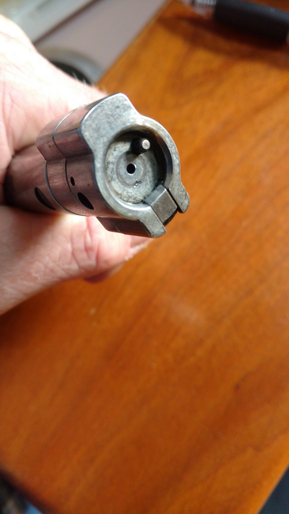

Had to switch from Winchester primers after LR primers failed and gas cut a bolt face, and had the same thing happen on a different rifle with Win LRM primers the week after. Will never use WIn primers again, even though Winchester did make it right and repaired both rifles and bought back the rest of the Win primers in my possession. The return and repair process took months, but I ended up NEEDING to buy a new rifle for hunting that year. :cool:
Aaron
The bad win primers I had several years ago just blew a pinhole in the corner of the cup. It looks like the OP's blown primer fell out of the pocket. Very different situation.
Here you go. Also fixed OP.

You are right, and I should have mentioned the mode of failure with the pin hole at the corner of the cup... mine failed this way too.

Your primers look kind of flat, not super flat, but more so than I usually see on factory ammunition. Also, it looks like you have some cratering in the case in the lower left corner.

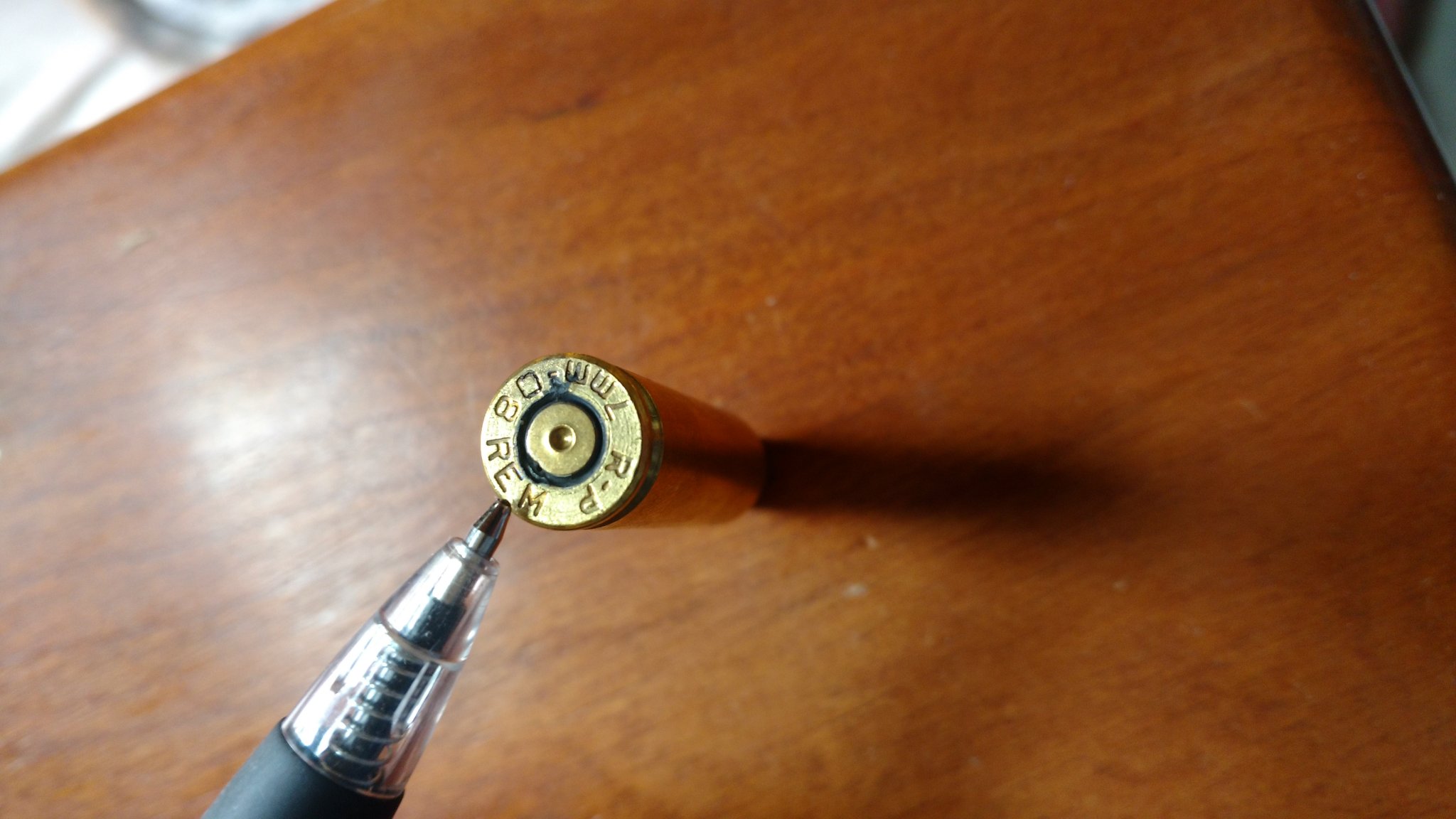

I'm no expert to make that determination, but here's a pic of one of my failures and you can compare and try to determine that difference. Also a pic of gas cut bolt face. Mine were mild loads well within published load data with SAAMI spec COALs.
