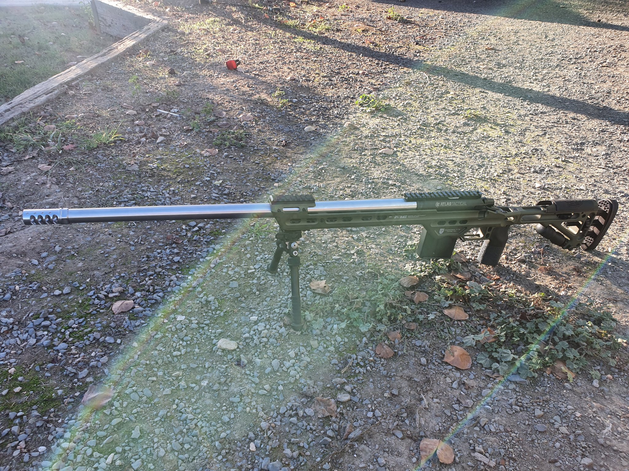

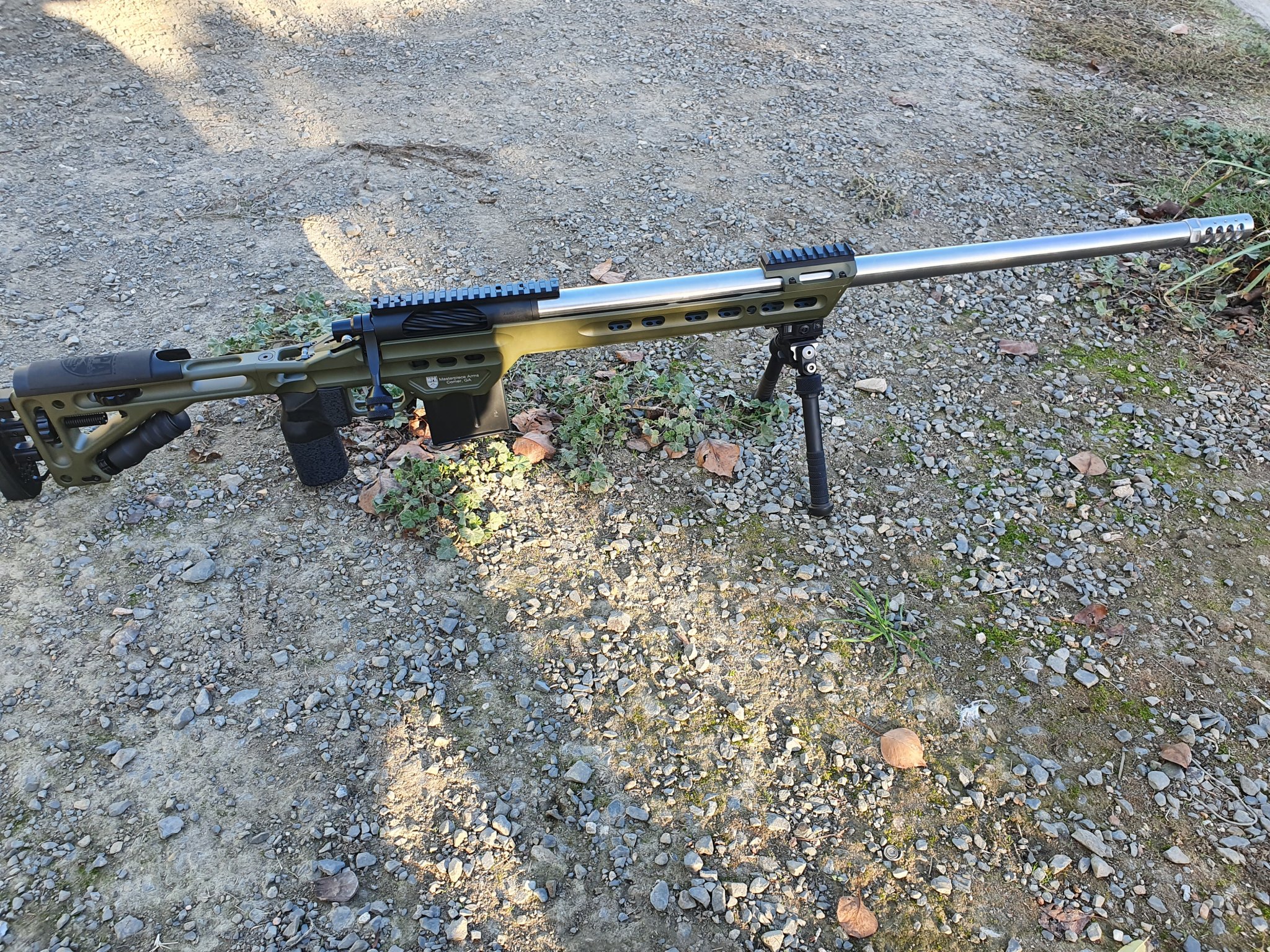

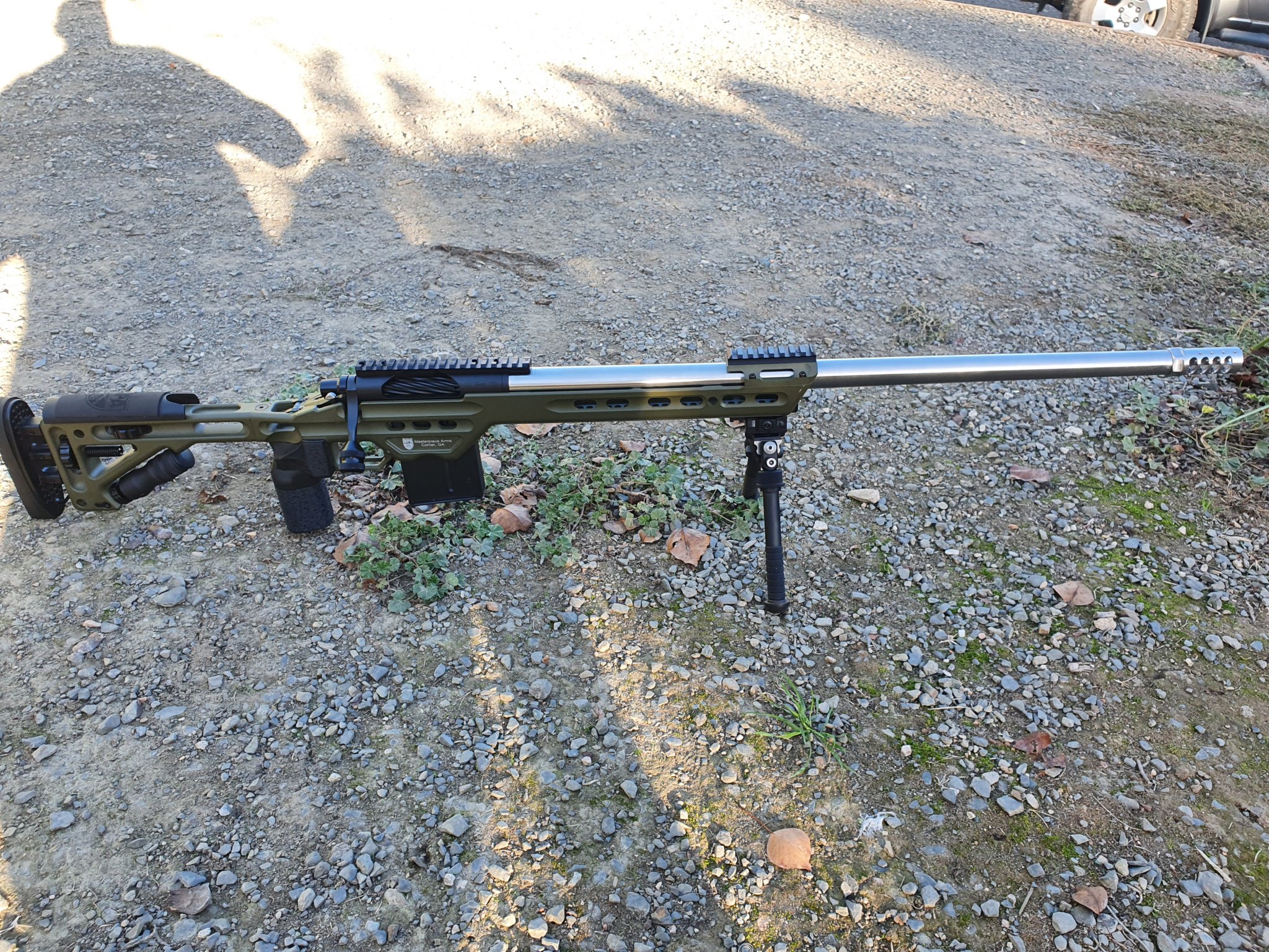

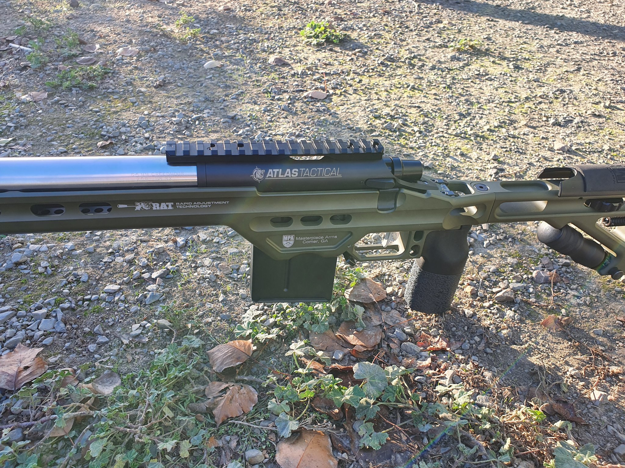

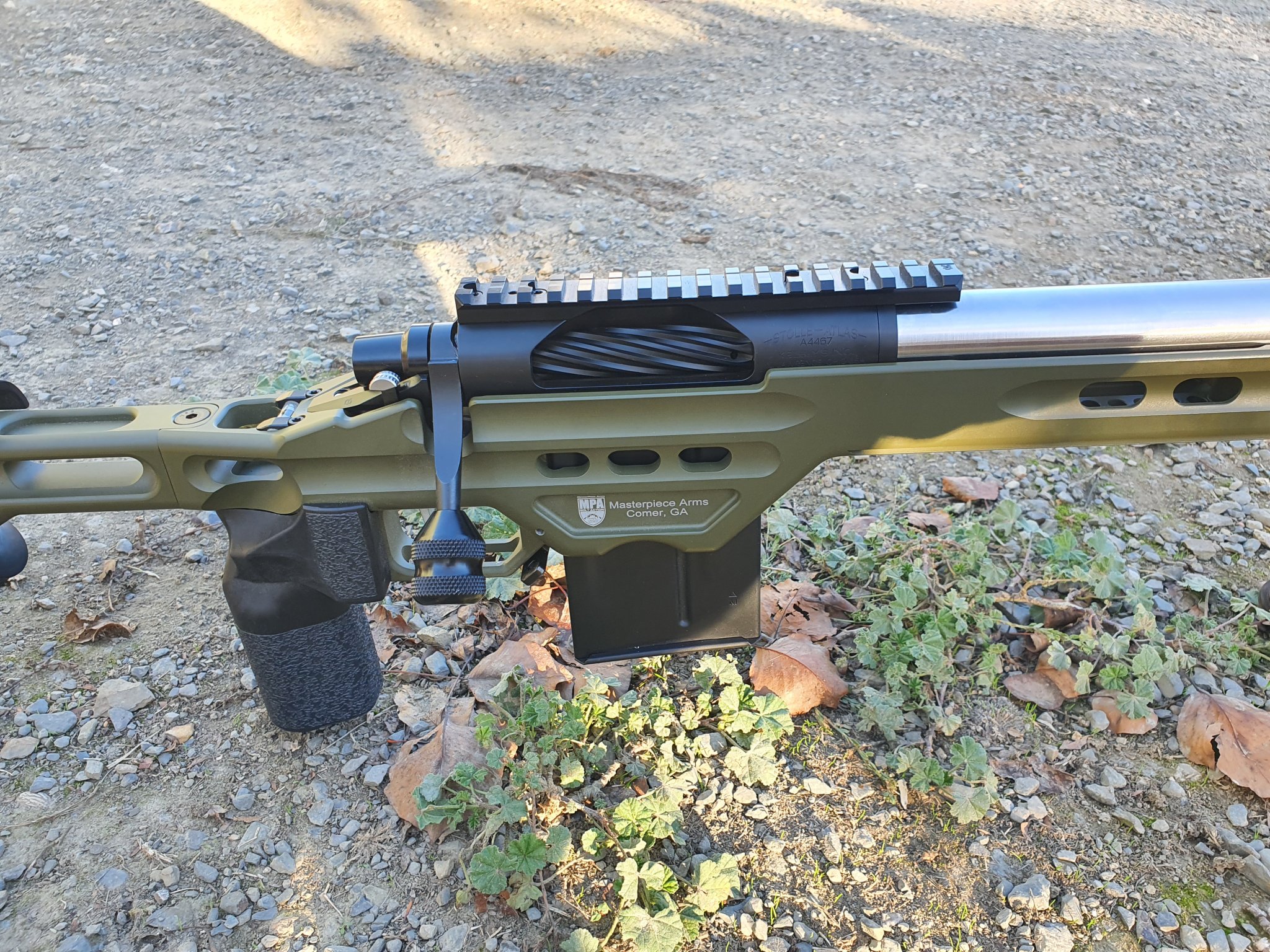

Another Update !!!!!!
So gunsmith has sent through photos, our barrel and break cerakote was not done because the lead time was just too long.
My local cerakote shop are able to do it and only a week turnaround time.
So here she is.
MPA BA Comp
Kelbly Atlas Tactical
Brux Heavy Varmint (26.3inch)
APA Little Bastard Gen 3
Bix&Andy Tacsport Pro 2 Stage - 90 degree trigger shoe.
Cant wait to get behind it and send a few down range :D:D:D
Thanks to everyone who's been following and or offering advice.
