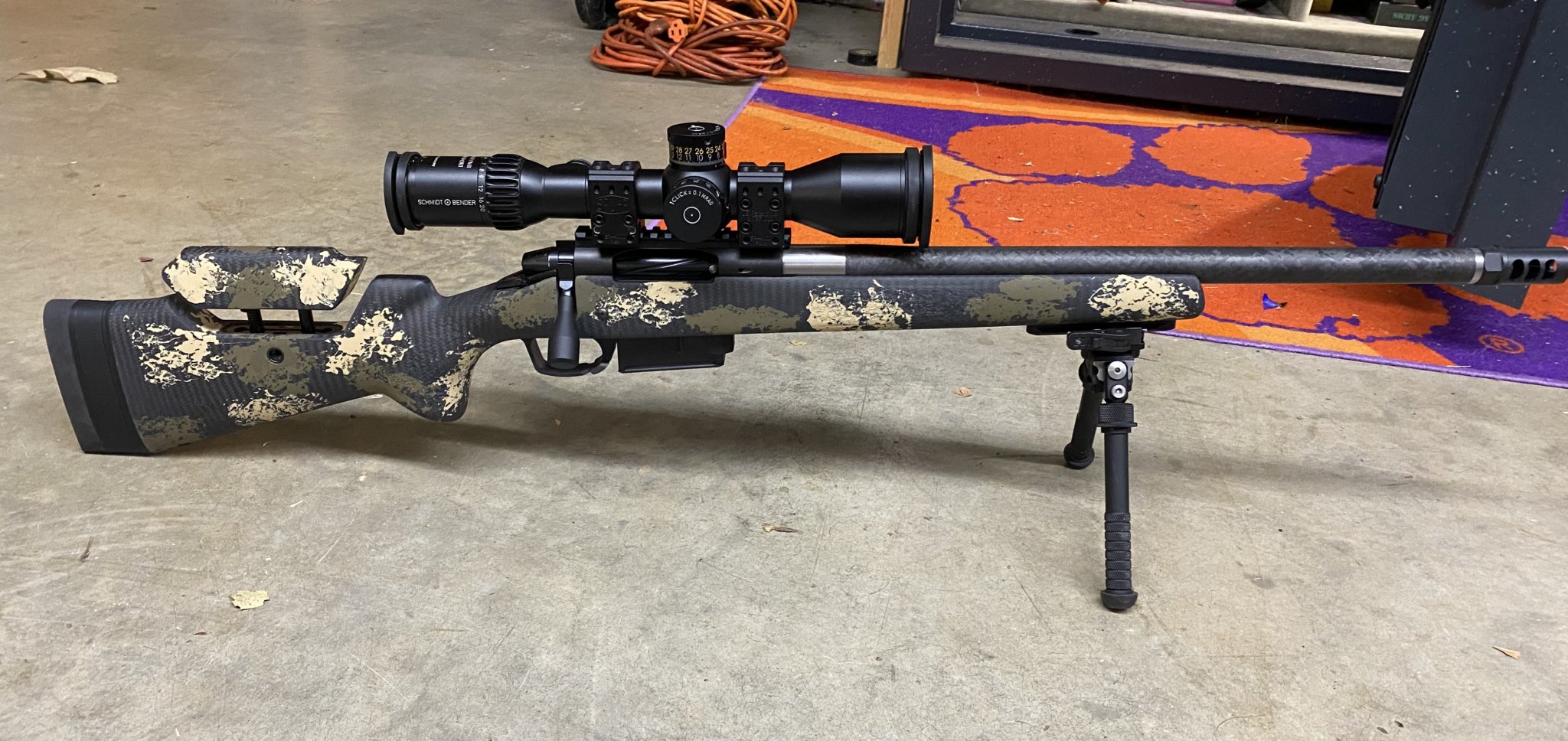

Keep in mind you can eliminate a lot of guesswork with the Manners/Zermatt/Proof combination.
Manners can install the chassis for the TL3, and you can order the pre-fit barrel from Proof. Shortest CF barrel Proof offers in 6.5CM is 20", which is threaded 5/8x24. The Manners chassis would also eliminate all guesswork on the bottom metal and magazine. The Zermatt actions come nitrided, so the only options for cerakote would be the metal portions of the Proof barrel.
I did this and the rifle without optics was just over 7lbs.
Reactions: Stoweit and BACB
Thanks! I’m going to look into this combo.
