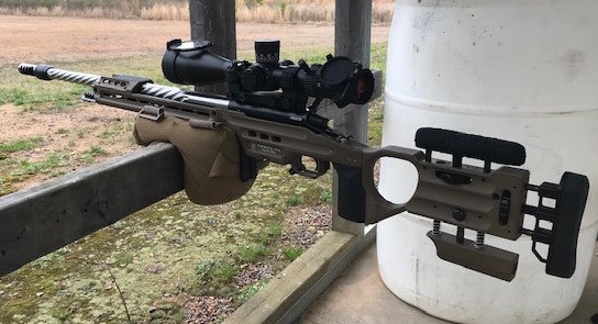

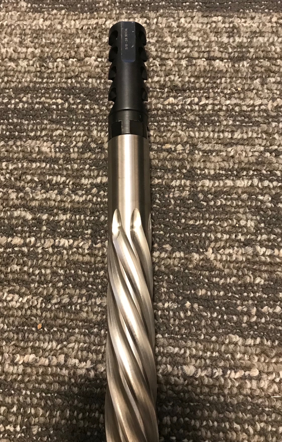

So I’m pretty sure I’ve settled to a final parts list for my build. Going to go with the origin action and an osprey prefit from pva. What’s the way to go for barrel contour? M24? And does fluting affect anything other than weight and appearance? I do really like the look of spiral fluting so if it doesn’t affect the barrel accuracy wise I’ll probably have it fluted.

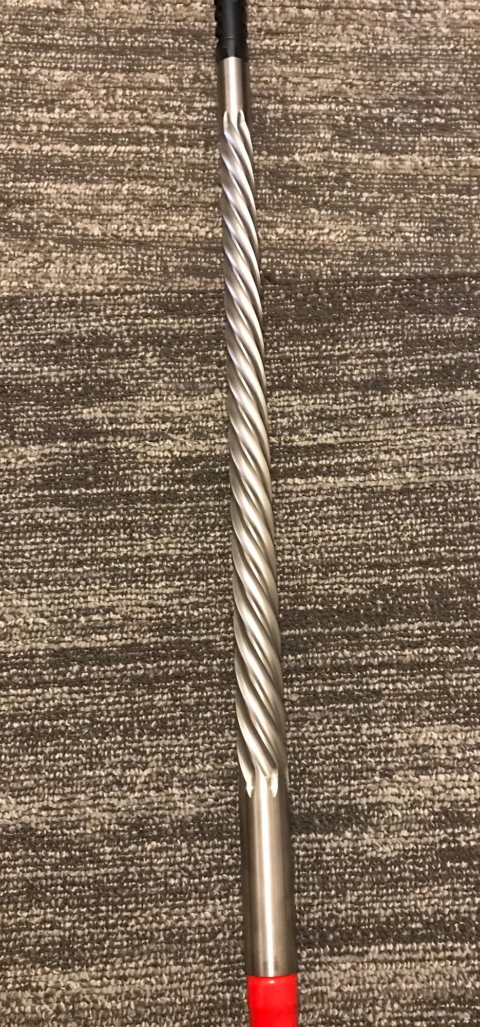

Nope the fluting doesn't effect accuracy with the PVA barrels. I have my 6 ARC spiral fluted and it's very accurate. If you are getting it fluted go with the Proof Competition contour and the fluting will lighten it up some.
So, done right, fluting shouldn’t affect your results and fluted barrels surely are nice looking. But how often you shoot and have to replace barrels is a consideration. If only for learning and occasional range trips, I say go for it.
If you think you’ll get into competition or shoot very often, the extra cost for fluting is usually a casualty of the budget.
For your first one? Go for it. You’ll feel better about the results and it’ll suck you in.

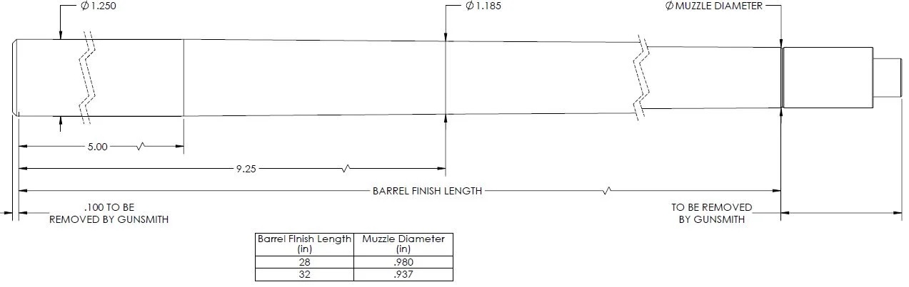

If you’re going to flute it but still plan on PRS I might even go straight profile. If you plan on a finished length of 26" then the straight profile should be heavy enough so that you won't need to add much (if any) chassis weights.
I like HV or Comp contour at 28” because it balances well in my chassis’s with minimal chassis weights

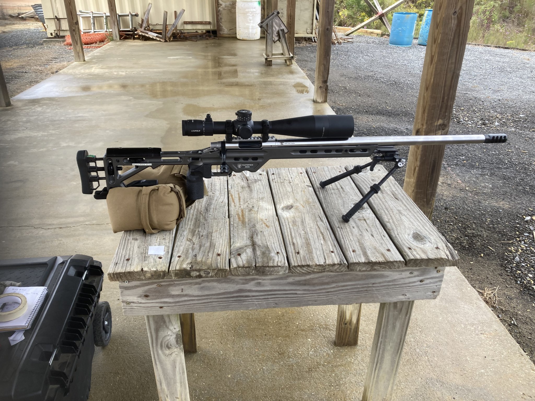

Anybody have an mpa ba comp chassis?
I am using one right now. I also have an ESR which I like more, but have no real complaints about the BA Comp. Masterpiece arms takes about 6 weeks or so to get one to your door, depending on the finish chosen.
The ESR takes an MTU profile, the BA needs spacers. However, with MPA’s blessings, I shoot mine without a bridge. Don’t really miss it. Rifle balances fine without it and i never use the night bridge for anything. If you are buying, go with the ESR.

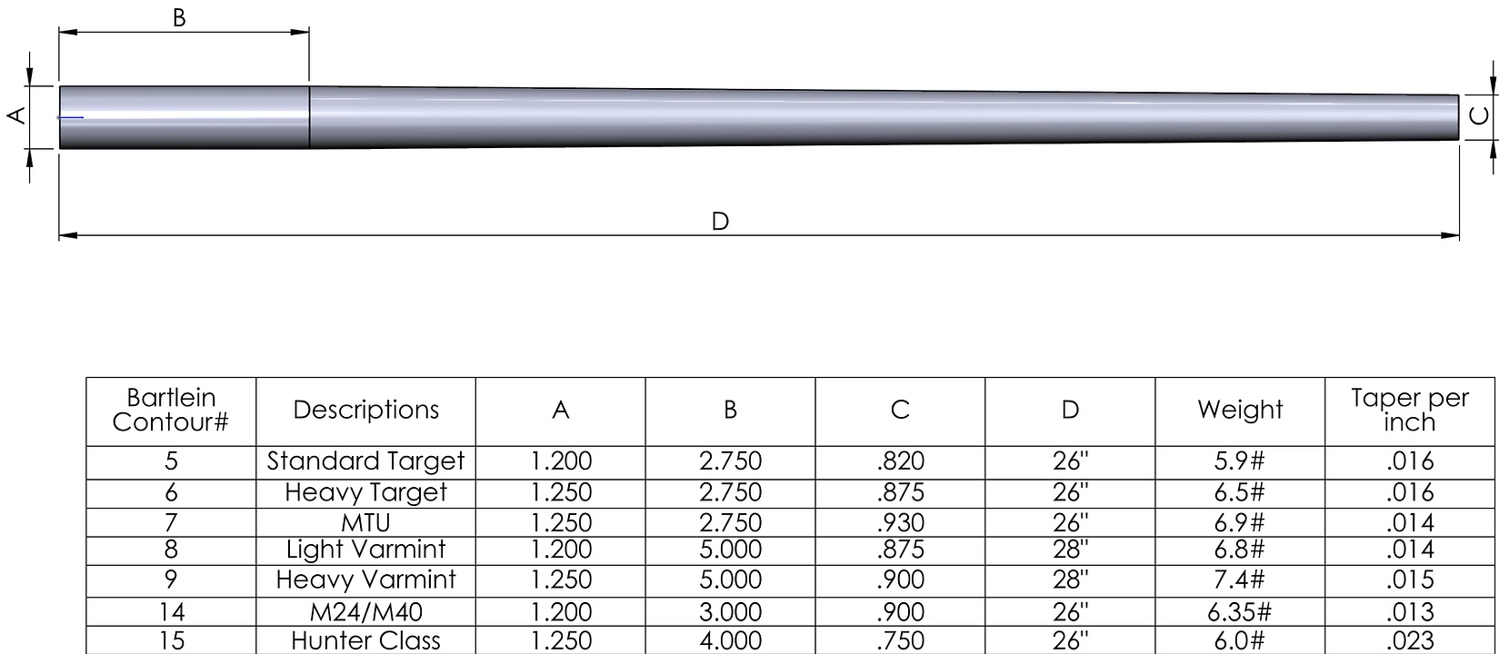

Would the esr also work with a proof competition contour?
Got a couple of charts. You can read the numbers. When in doubt, call Woody at MPA, he probably has the definitive answer. My guess is yes, but I have never knowingly laid my eyes on a Proof Competition contour barrel, so, my opinion has ZERO Value. Call Woody if in doubt.
Yes. You just have to look at the MPA site under Specs and it says it can take up to a 1.25" barrel.
