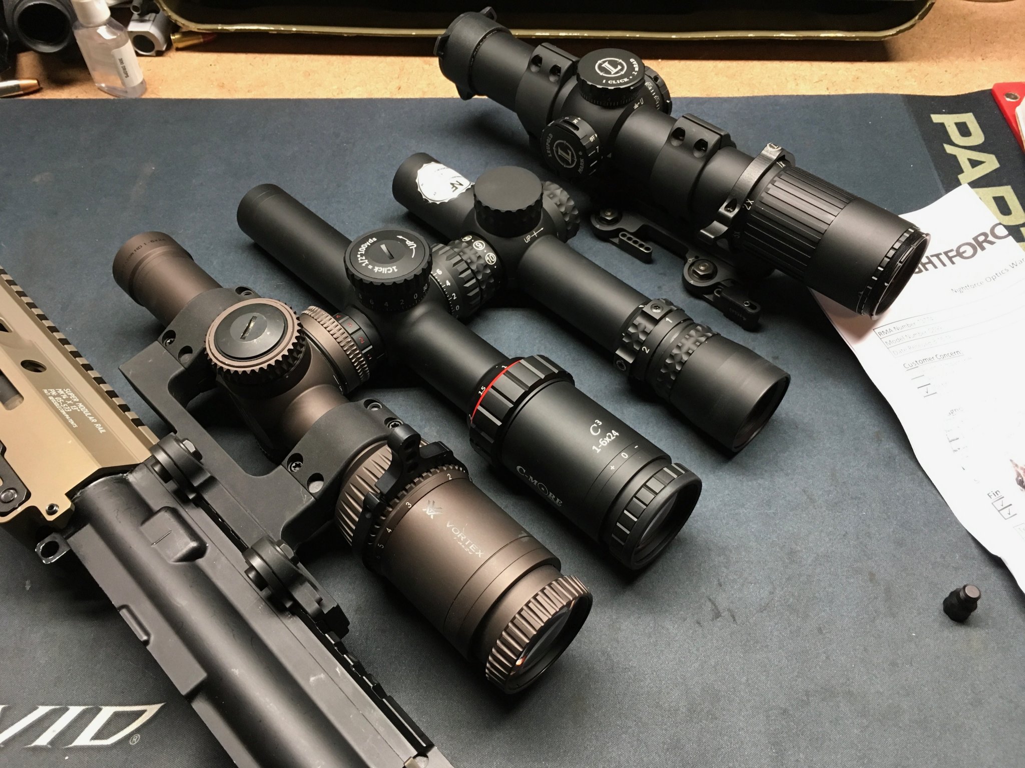

Here are a couple options pictured for size comparison:

Kahles K16i
Vortex Razor II 1-6
CMore C-3
Leupold Mark 6 1-6 (TMR-D)
Nightforce NX8
Steiner P4Xi 1-4

I'm in the market for a LP(V)O as well. I've tried several:
Elcan 1x/4x
Vortex PST 1-4x
Vortex G2 Rzr 1-6x
Burris xtr2 1.5-8x
And I've also tried a bunch of less variables
Vortex Spitfire
EOTECH RDS with 3x flip magnifier
Holosun RDS with 3x flip
RMR 2 moa with 3x flip
ACOG 3.5x with 5.56 chevron
Burris 556
I think my main problem was my requirements. I wanted to be able to DO ALL. So inside 100yds and out to as far as my 5.56(18) can get on 12" steel which is about 750yds. And none of these will do all that. So, time to give up. The two I liked the best were the ELCAN and the RZ Gen2. I sold both of those, but maybe I just need to go back and get them again :)
The Rz Gen2, per my memory had super clear image ... I used it a lot for tree rats at 1x to 3x ... that tiny bright dot in the center was all I needed .. then I used the critter as the reticle, occasionally needing to aim up or down an inch with the .22lr depending on the distance and the elevation. But I really miss it in that role.
The ELCAN had a very clear image as well and two different illuminations and also a great tiny single dot. I like a tiny single red dot for inside 300yds or 400yds ... but unfortunately, my eyes don't work with the RDS, so I need something like the vortex or the elcan where the dot won't split into 2-3 parts.
And again SPF doesn't bother me if there is a great tiny red dot of illum in the center, I won't be using the subtended reticle for short distances, just the dot when I'm dial down to lower power. Or even without a red dot I'll be using the center of the reticle and the center is always FFP even if the rest of the reticle is not.
My problem with like the Vortex 1-4x was the reticle was too small for me even on 4x ... my olde eyes kicking in. And the ACOG reticle was fuzzy, olde man eyes again. For some reason the ELCAN reticle was never fuzzy even though it had no diopter either. At 500yds the ELCAN was crisp all around.
But open to other ideas as well !!! I'd like something with 1x on the bottom and at least 3x on the high power ... and about the bulk and weight of the RDS + 3x flip ... with an SPF reticle if it has a subtended reticle, so I can see the reticle. Those are probably my requirements.
EDIT: One will go on 5.56(14.5) and hope to get out to 450yds ... the other will go on 5.56(10.5) and hope to get out to 300yds. These are day carbines. Shooting at steel and critters. And a bright red dot illumination that doesn't split up in the center would be great also.

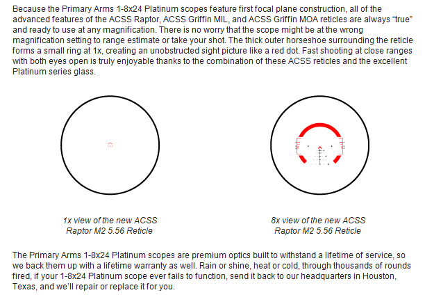

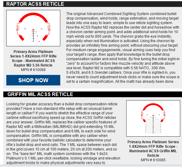

OP take a look at the Primary Arms Platinum 1-8 with the ACSS reticle:
https://www.primaryarms.com/primary...escope-patented-acss-reticle-pa1-8x24ffp-acss
While I have not tested the range finding capabilities (no human volunteers!), I did find it easy to true the 200 yard and beyond hold-overs with one simple .2mill adjustment for my load. Makes 500 yard shots child's play and the 5mph wind holdovers work extremely well. Wish it had 10 mph windage holds and was a tad lighter, but I can certainly make due!
