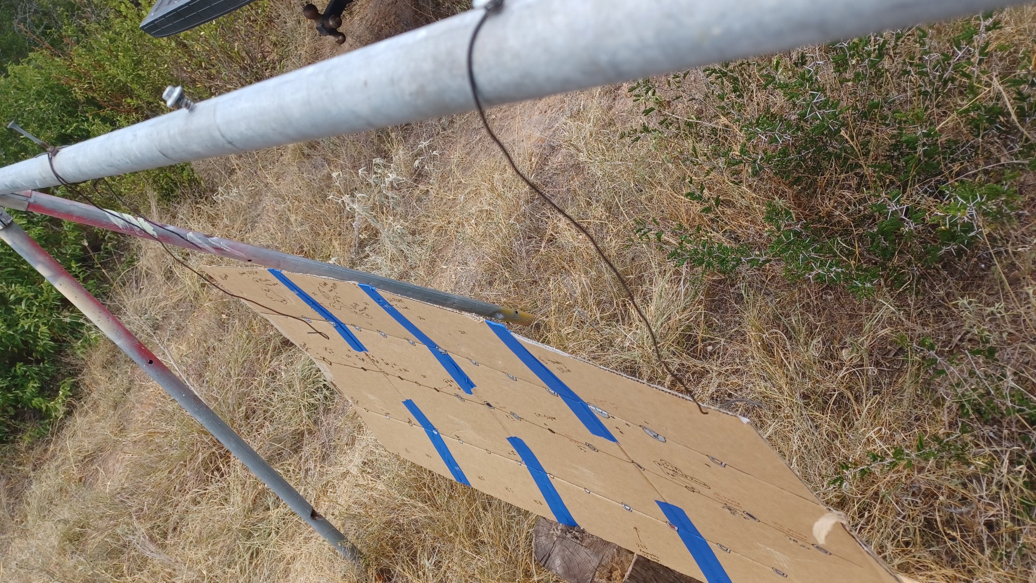

    The 223 shot amazingly well and I think is becoming my favorite riflrle. I had shot a 10 round group that looked alright. So I said "fuck it" and did a 20 round group right after. Both the barrel and can were HOT! Still managed to get a 10 shot group under an inch and a 20 shot group at just over an inch. With FACTORY mass produced ammo. 😎

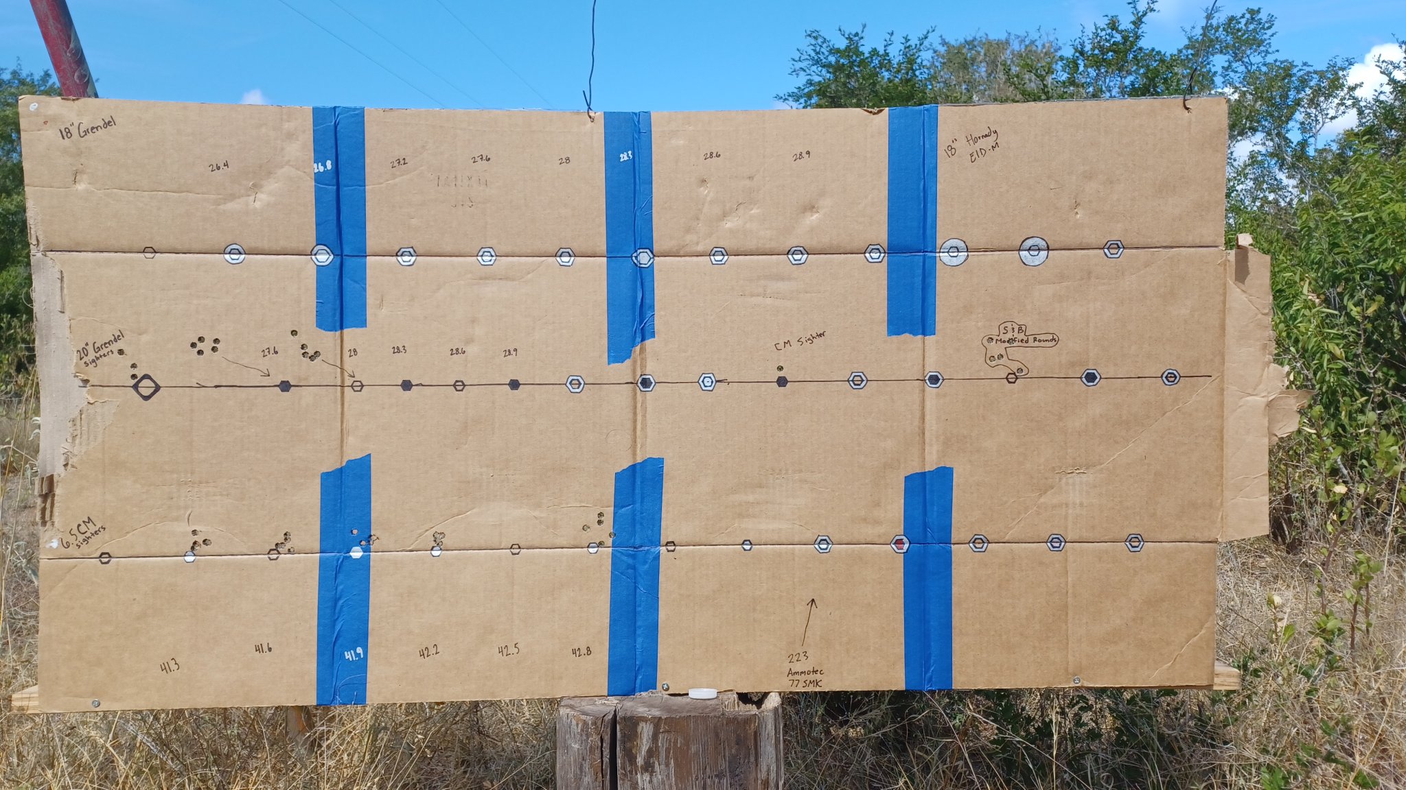

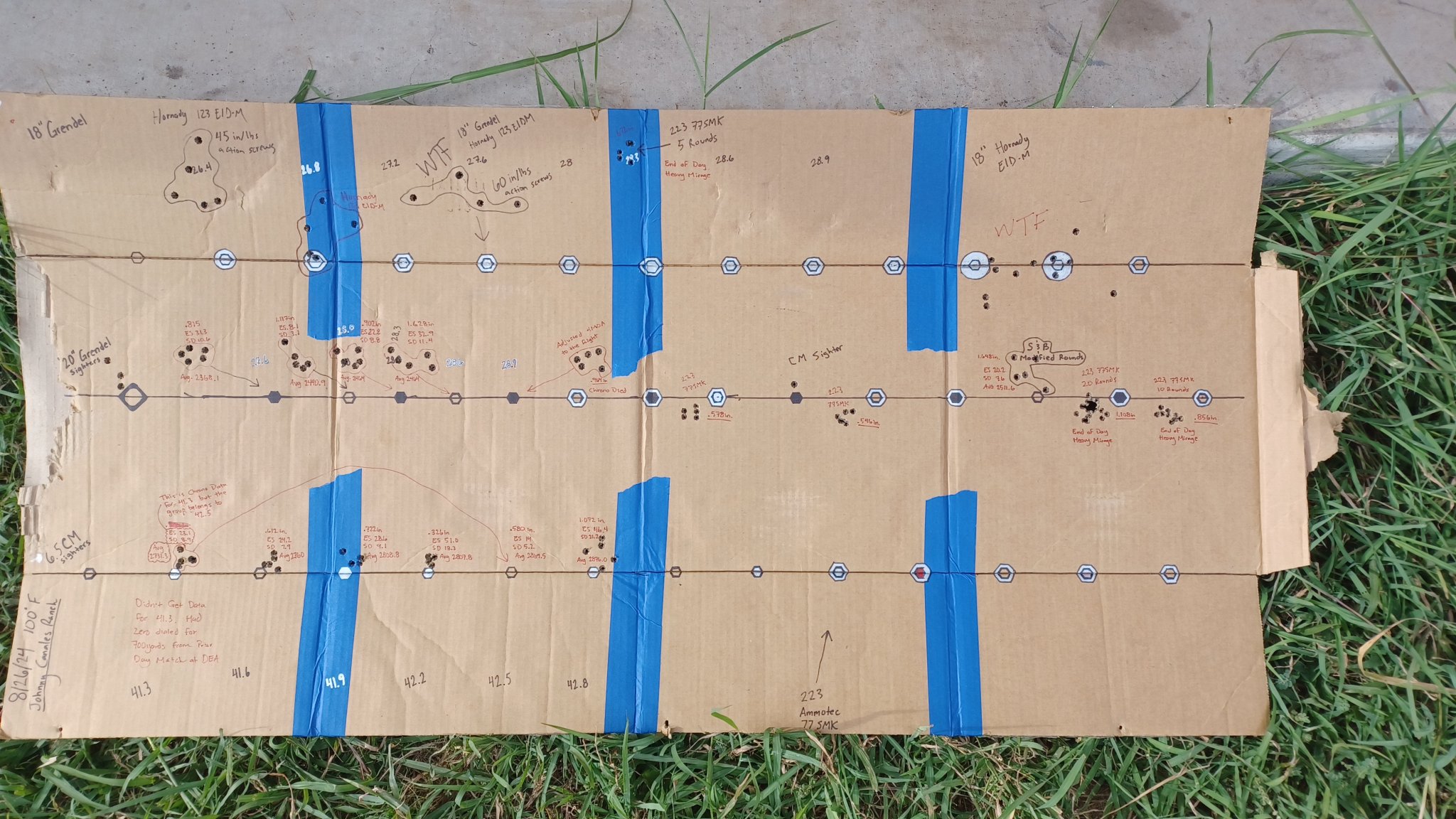

    Here are some pics
    I had a custom Taylor made target stand. 😂😂😂

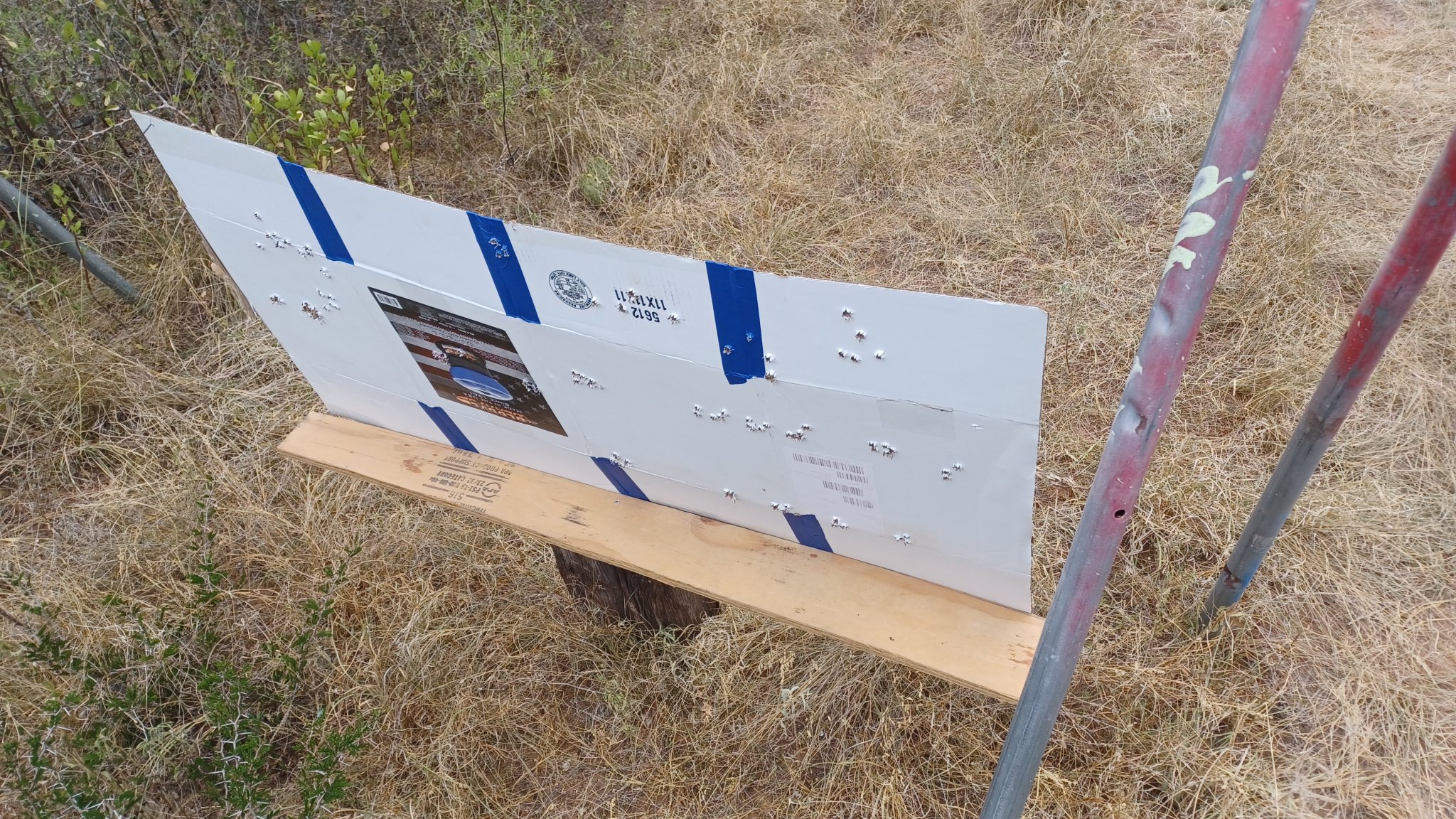

    None of my reloads had any sign of pressure. The factory grendel ammo I shot was a different story. Sticky bolt lifts and some primer flattening.
    The S&B modified ammo is sellier & ballot with 124s that I pulled and averaged out the charge weight to evenly distribute it across the rounds and seat the bullet 20 thou off the lands. The factory stuff jams.
    The 18" grendel I have never been able to get it to shoot. Hopefully once I shoot the reloads it proves me wrong.
    The 20" grendel had decent numbers but poor-ish group sizes.

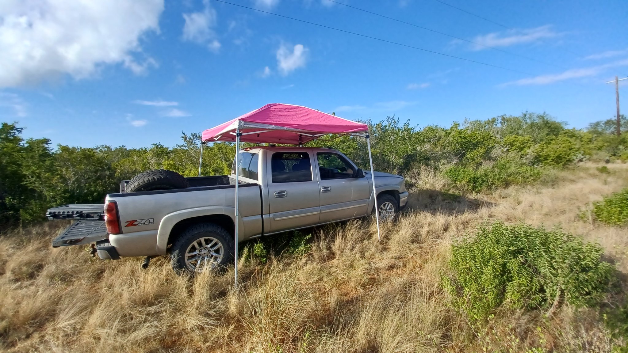

    Yes, I shot under a PINK tent! 😂😂😂
    Reactions: simonp
    Pink tent looks inclusive. Good call. You even used Mexican match ammo to really open things up. Impressive. Probably get 5 extra votes changed blue once they see your pics lol.

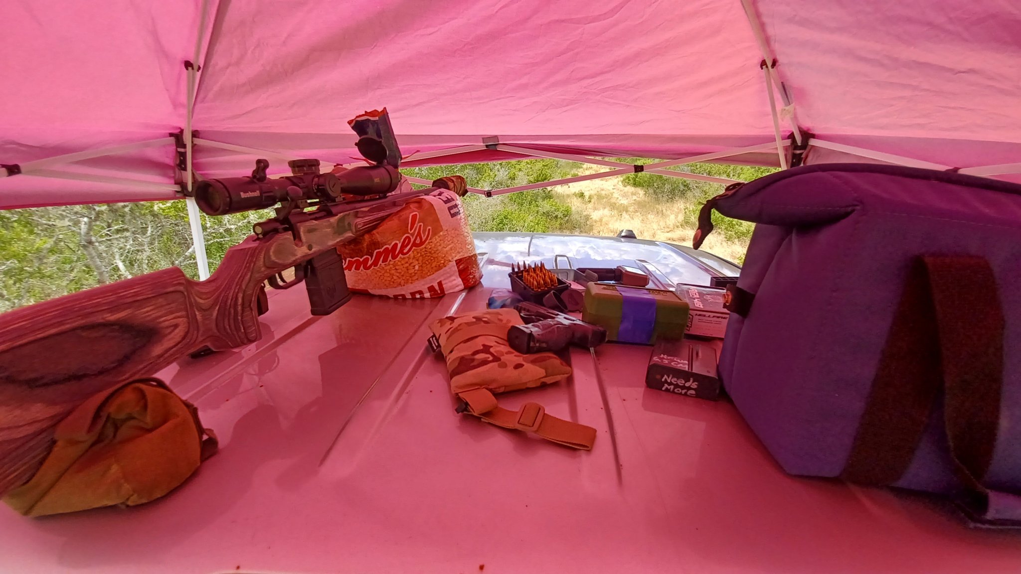

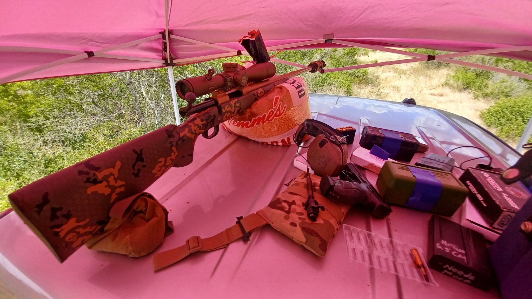

    Damn, that's pretty gangster shooting off the roof of your truck rested on a bag of deer corn! Like it!!

    Haha thanks. Over the years, I've realized that a corn bag works really really good. Being in the field sometimes you have to make it work with what you got. A few years agoI only had a bag of corn and it really stabilized my position. I even used it on my creedmoor with an atlas cal attached to it via arca on this outing. I decided the corn was better than the bipod. Seeing how I managed to get an inch-ish group with 20 rounds out of my 223 with a barrel and can hot AF and heavy mirage, I'd say the setup is doing alright.

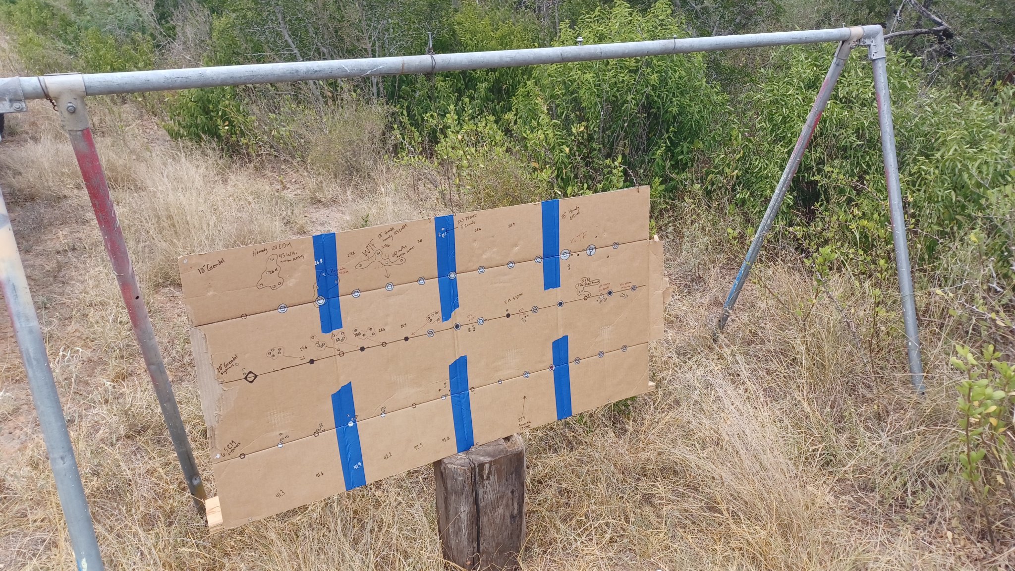

    This is also the grendel rifle that I simply cannot get to shoot. You'll see on the target picture, the above row, has factory hornady ammo all over the place. I even tried playing with torque value on the action screws.
    In the past, I've tried other factory ammo of different manufacturers and different bullet weights, nothing seems to work. I even took the scope off and made sure scope base, rings, and ring caps were not loose. This rifle shows no promise at all.
