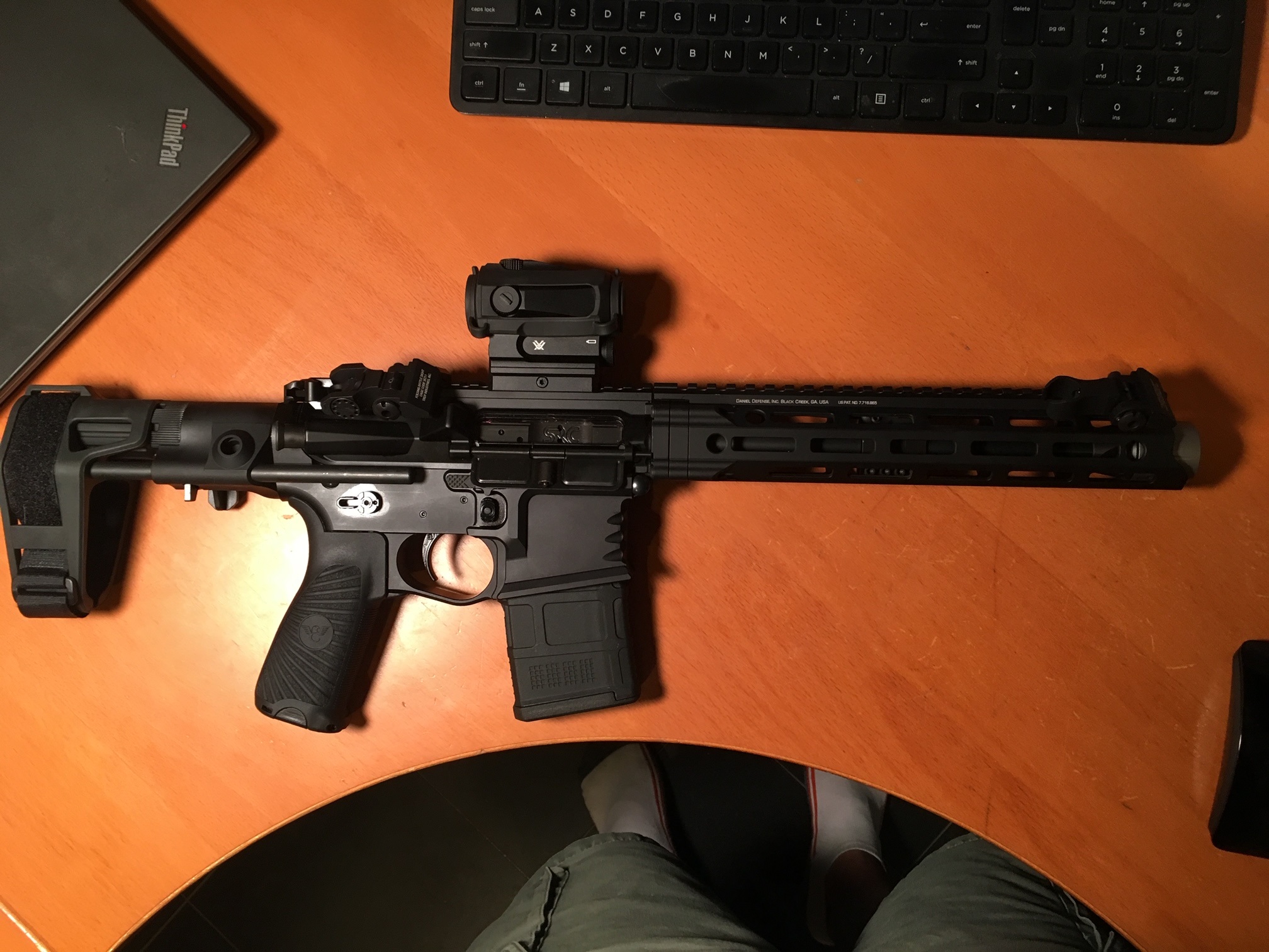

Here's a pick of the grip on a pistol. This shows the reduced angle better than link I posted.
Reactions: JS8588

what is this build going to be used for? What ammo are you wanting to run? do you want it to be a work horse that eats everything?
criterion makes a good CL barrel, just buy a matched bolt with it.
lets us know your goals and we can get you on the right path.
Range, class and possibly home defense. Will be running mostly 193 through it but at this point whatever i can find for a "reasonable" price. I want it to run most ammo but I am okay with it not running everything as I think overgassing the system for reliability makes shooting less enjoyable (looking at you DD). My factory built 11.5 is my shtf gun so everything i build will be used mostly at the range/classes.
I plan on sending criterion my bolt to be headspaced. I am still trying to decide between the core series vs hybrid from criterion. I get some weight savings from core but assuming more accuracy shift if doing string firing vs the hybrid.
If you haven’t bought the jp bcg hold off on it. Save the cash for the barrel, or other parts. Buy the bolt from the barrel manufacturer, they would have the best matched set for their barrels. If you must have a jp carrier, wait until they offer a sale.
Get a buffer that can be adjusted. This way if you need to add weight (h2) you can. I think it’s 10.00 for tungsten weights. I do like the geissele set up, that spring design has worked well for multiple firearms and in other forms.
i do like the criterion core barrel, but I am not sure how well it will hold groups together once it gets hot. A while back criterion put a “how to” video on youtube about upper barrel assembly. Their top builder showed how he installed barrels to uppers and it was very disappointing. With that being said, centerion arms offers a really nice CL barrel.
This is the video that bothered me. They are talking about accurizing the AR but when they trued the receiver face, he held the parts by hand and used a hand drill. You can not get an even amount of force when cutting this way, or have a consistent outcome . While this is such a small shortcut, it makes me wonder what else is cut short.
I am am buying the rubber city bcg/bolt (waiting on their bf sale) thanks to the recommendation in a previous post. Also buying the JP SCS kit (waiting for OP BF).
Most of their mass is in the rear on their core barrel so I would assume it would be okay. I am not beholden to their products they just seem to make the best (other peoples words) CL barrel, which is why I chose them. If their is a better or equal option with a 0.75" contour i would preferably pick that. I don't have the experience to know what is comparable.
Either way ill send the bolt in for headspacing with whatever companies barrel i buy.
I can't comment on the video but I can't imagine that is the correct method as you stated
Check out Black River Tactical. I use their gas blocks with their inserts. I’m going to purchase two SLR Ti gas blocks and see about installing BRT’s HD kit in them.
FWIW, they have .625” and .750” gas blocks with HD ports installed. Easy button for the 12.5” Core. Since it’s not a pin & weld build, you can adjust your gas ports to your liking by just installing a different port, once you get your suppressor.
You can even install the HD ports in FSB’s, existing gas blocks, etc. It’s suppressor tunable while being hard use, bet your life reliable. The tuning is just more involved and it’s set it and forget it.
For accuracy, a tack driver, I'd look at Krieger. I've used most of the high end makers and those are some of the best and they can deliver relatively fast. I used the Lilja Navy barrel and assembled a Recce rifle per USN specs and then built another one using the Krieger. The Krieger is more accurate and the mid gas makes it pretty soft too. I don't fuck with adjustable shit.
Noveske is my goto for SBR barrels and other short stuff. For 13" I'd get one of those. I don't expect to ever shoot them past 300 anyway.
JP FMOS is what I use to ensure reliability, the fucking things just work. If it gets enough gas, it'll do it's job. Many high end bbl. mfg.'s will use JP bolts to headspace their barrels and will include the bolt if you like. This isn't a bad option, especially if you need one.
Start with a standard buffer or go by the chart. I understand M4's currently use H2's and I probably need to change the ones in mine but those rifles are what a lot of you would call "overgassed" due to reliability concerns, ie, a little more is better than not enough.
A 3G trigger will make it a fast blaster but you won't be able to really set any shots or do much precision anything with it.
I'm a fan of the KAC URX4, it's one piece and if you bed the barrel it turns the upper into a singular and permanent upper/barrel unit.
IMO .300BLK makes a far better suppressed SBR option. That said, all my 5.56 shit is suppressed but it's also restricted to between 10.5 and 16". Shorter is anemic and longer is well, long for a high speed bb gun.
Personally, I like the DD 1:7 Govt Profile chrome lined barrels with the .750 gas tenon... I have one right now on my go to AR and its a hammer with 55 vmax. Today, I would say buy what you can find, because its slim pickens out there for 10.5-12.5" AR barrels and may be for a while...
Here's some 5 shot group load development (seating depth test) with 55VMAX and H4895 out of my DD chrome lined 1:7
You can see the bottom row, 77CC/8208XBR didnt shoot bad either..
