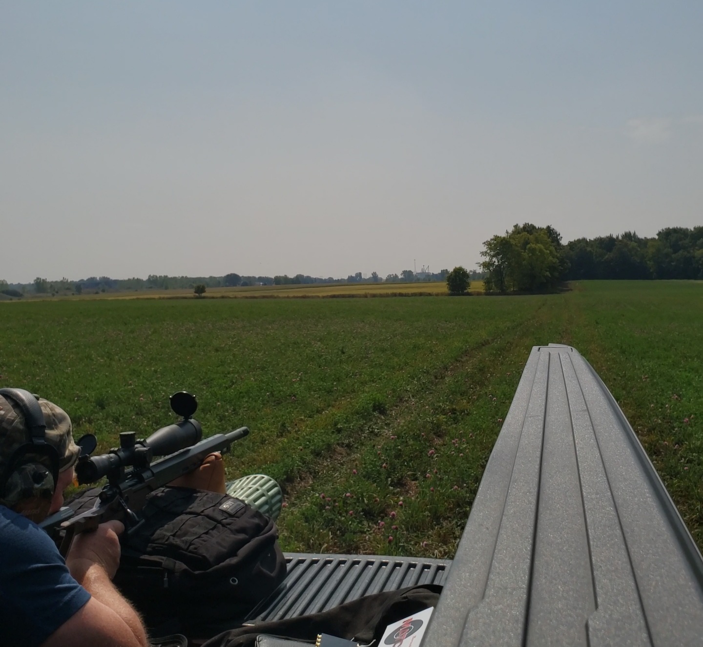

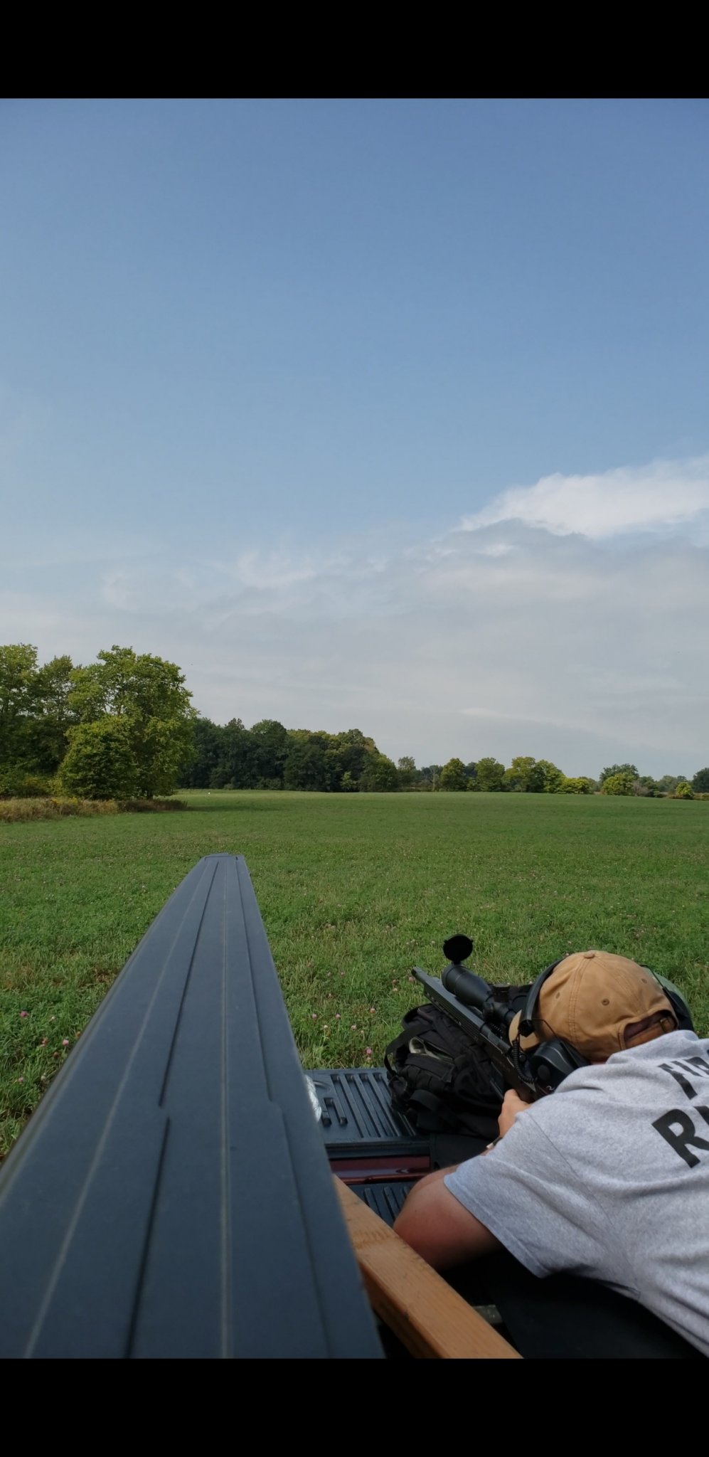

Hey! first post on the forum here so please let me know if im missing some decorum....
I recently traded for a Christensen MPR and as such dont have anywhere close to retail in it...that said here are my thoughts on the gun itself...
-Looks: The rifle is awesome astheticly. The build look and visual quality is great. mine is their bronze/FDE and the colors match and look very snazzy. the carbon has the right amount of carbon sheen, and sparkle. (minimal, and is muted, but it is CF and looks the part).
-Feel: The rifle feels great, and handles well. I personally dont notice the weight savings comparted to similar length 700's, 10's or Ruger's ive owned but it is lighter than say a 700 in an AI style chassis. Also in the 'feel' department, 22" w a Brake in 6.5CM the recoil is neglible. Again this is to me.
I do have a few gripes in the feel dept however...The rifle ships with a magpul K grip. the bevel on the grip is not flush with the rifle. for a $2k+ gun, this annoys me. Also a gripe, the cheek rest and buttstock adjustments are NOT tool less. I set it up how i THOUGHT i wanted it, but it was a little off when i actually hit the range. I forgot the specific allen key, and thus had to live with it as is. Last, the cheekrest is not ambi. Im a lefty and it works for me, but i wish it could be switched.
-Function: The rifle functions as expected, but does NOT feel like an action that belongs on a $2k plus gun. The action feels sloppy and...open? loose?...its a little odd to describe. Compared to a R700, Savage 10, 110 (older ones) or a ruger M77 the MPR leaves alot to be desired. The folding stock mechanism is great, SOLID lock up both folded and not. The trigger is great, it is a flat break with no creep or movement. I prefer a curve, but am starting to like the flat face.

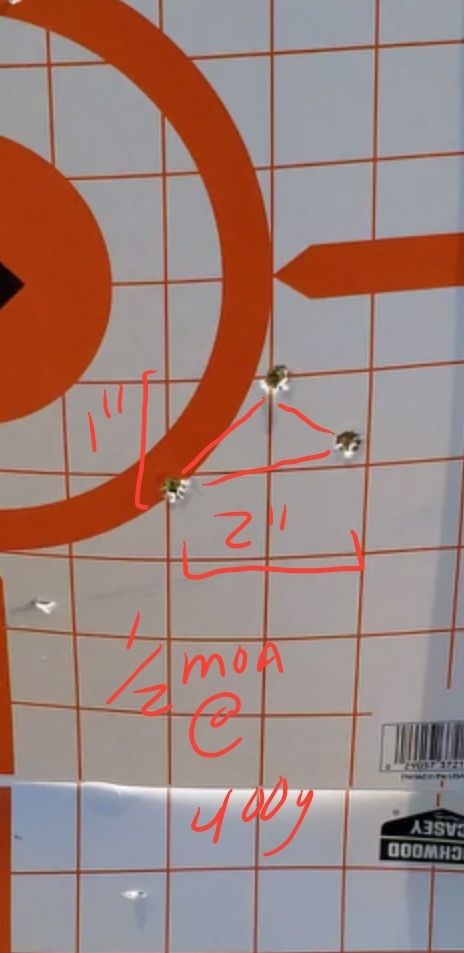

-Accuracy: This rifle was used when i got it, and i belive had already had about 150-175 rounds fired. I cannot verify if the break in was done properly, but based on my interatcions with the previous owner, it probably was. That said i sighted in with Hornady whitetail at 25 and 100y out of the bed of a truck. Optic is a sightron SIII mil hash, 6-24 ffp. I was getting about 1" two shot groups (i know thats not a group) then adjusting in an effort to conserve ammo. Next I went out to 300 yards, used strelock to give me a rough estimate on where rounds should land. Using hold over only (Mil hash scope) i got 5/5 hits on steel (18x12). Then 4/4 hits on 6" round. The two other shooters with me also scored hits, with one miss out of 10 rounds, while shooting at a swinging 6" plate.
Next was 400y steel and paper, switching to hornady match VLD rounds. At 400y i got 3/3 hits on steel, then transitioned to paper. scoring a 3 shot grouping of 1" tall, by 2" wide. Im newer to long range shooting , but i think im allowed to call that 1/2 MOA grouping.
In my opinion, for my use...the gun is plenty accurate. In all we shot 58 rounds with only 4 misses with 3 shooters (not counting sight in). The half MOA grouping was more than acceptable to me, and if extrapolated to 1000 yards would be exellent *IMO
But to others and your question....i dont think id pay 2249, or whatever they are asking for it these days. I would get a savage model 10, or rem 700, toss a reputabule chassis and spend a little more on glass. Or more likely Just get great glass and put a better stock or chassis later.
