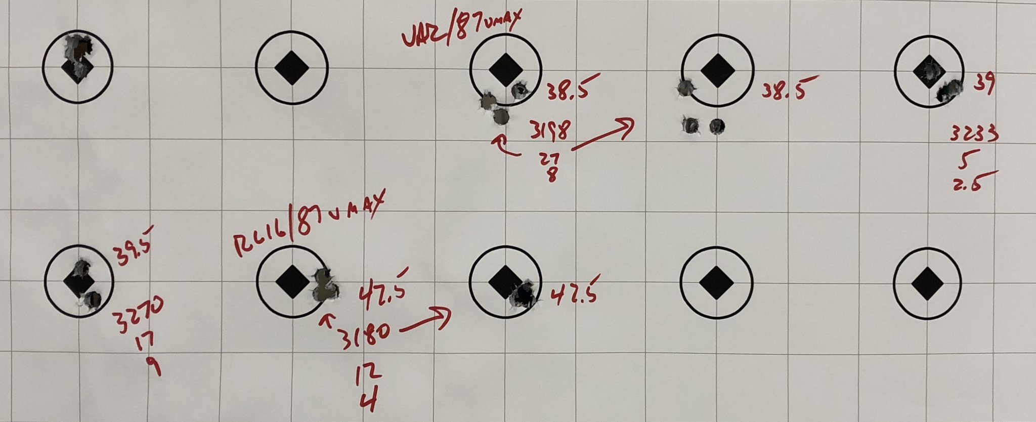

Just went through this today. Tested some Varget, which I’d never shot in this particular combo before, then switched to RL16, which is a known good load. No change.
Here’s the target. Fired left to right, top to bottom, ignore the upper left, that’s a different gun. The first two Varget loads are zeroing, and I left the sights after the upper right group. The bottom right two are RL16, with no foulers in between. I’ve noted this with h4350/RL16 a number of times. This is the first time with Varget.
Not really, I fire a 5 round group of X ammo, switch to Y ammo and the first round is 1-2” away from the next 4, then to Z ammo and first round a good bit away from the next four as well. Generally with Ammo that doesn’t group the best in the rifle though. But still the first round of each string is the loan “flyer” most every time.
