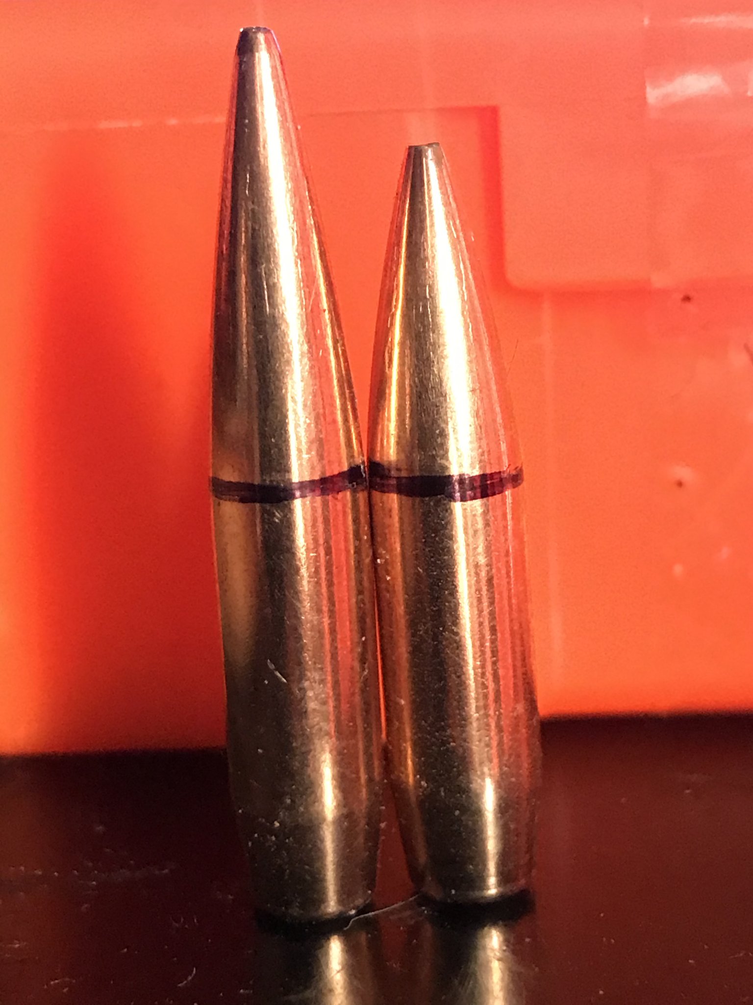

    Holy crap. I never considered how different the bullet shapes would be. Thanks for that insight.
    190 on the left and 168 on the right
    The mark is beginning of ogive.
    Good illustration. To get the BC higher, the bullet is made longer, and the place that gets stretched is the nose. Its the difference in nose shape: Secant vs. Tangent ogive. And, when you jump up 22 grains, you can't make the bullet fatter so it has to get 22 grains worth longer as well. That is what goes into the nose.
