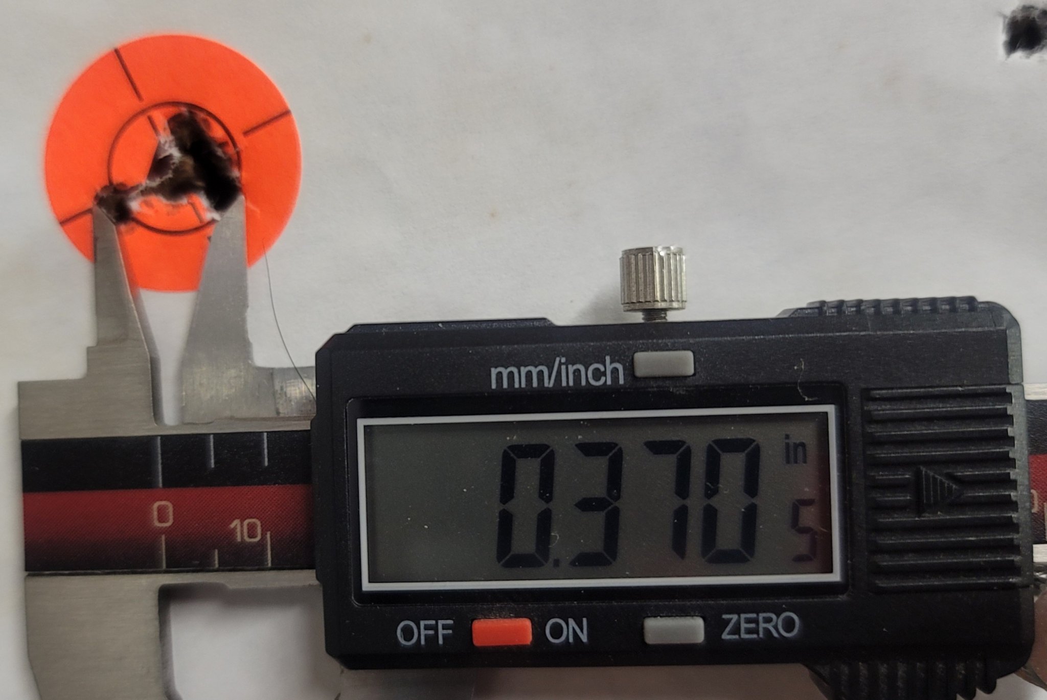

My rifle consistently has 1st shot fliers with a cold bore. At 100 yards it could be close to 3" off from the rest of the group. Does anyone else have this issue. It doesn't seem to matter which ammo I'm shooting. Curious what could cause this. Is it the lube from the bullets in the cold bore??
Pretty normal, but 3" seems a little much.
So maybe more like 2-1/4"

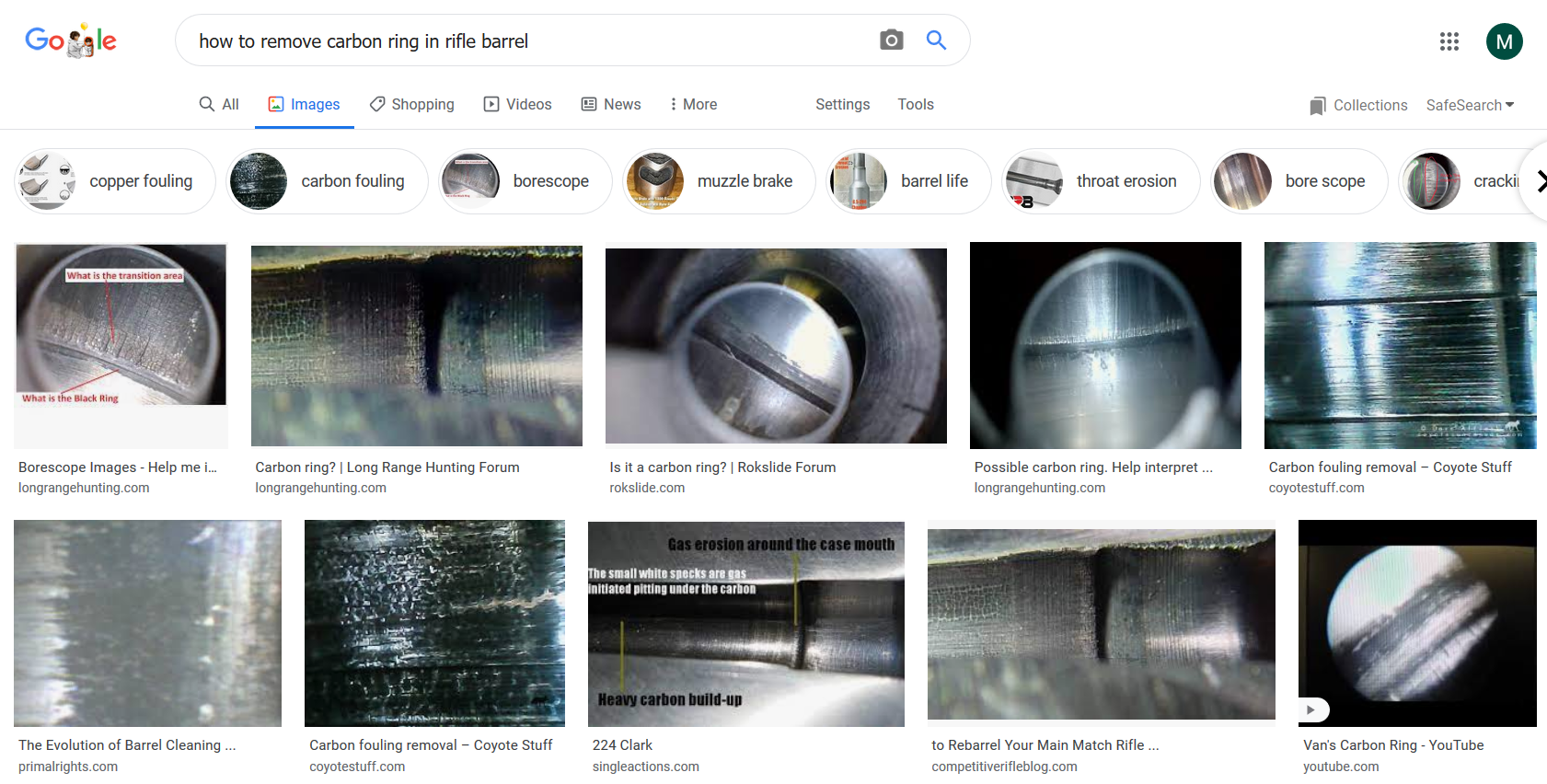

Carbon ring is what causes first round flyers. Carbon ring forms right where the bullet leaves the case. Over time this builds up and becomes thick. When you haven't shot the rifle a bit it will harden so the first round shot when it's harden will have a POI shift. After the first round is shot, this carbon is heated up / softens so the other rounds will all have the same POI.
For my Vudoo this develops after about 500-700 rounds, I do a thorough scrubbing of the chamber/ring area and soaking with Boretech C4 Carbon Remover and then I'll be good with no more cold round flyers for another 500 or so rounds.

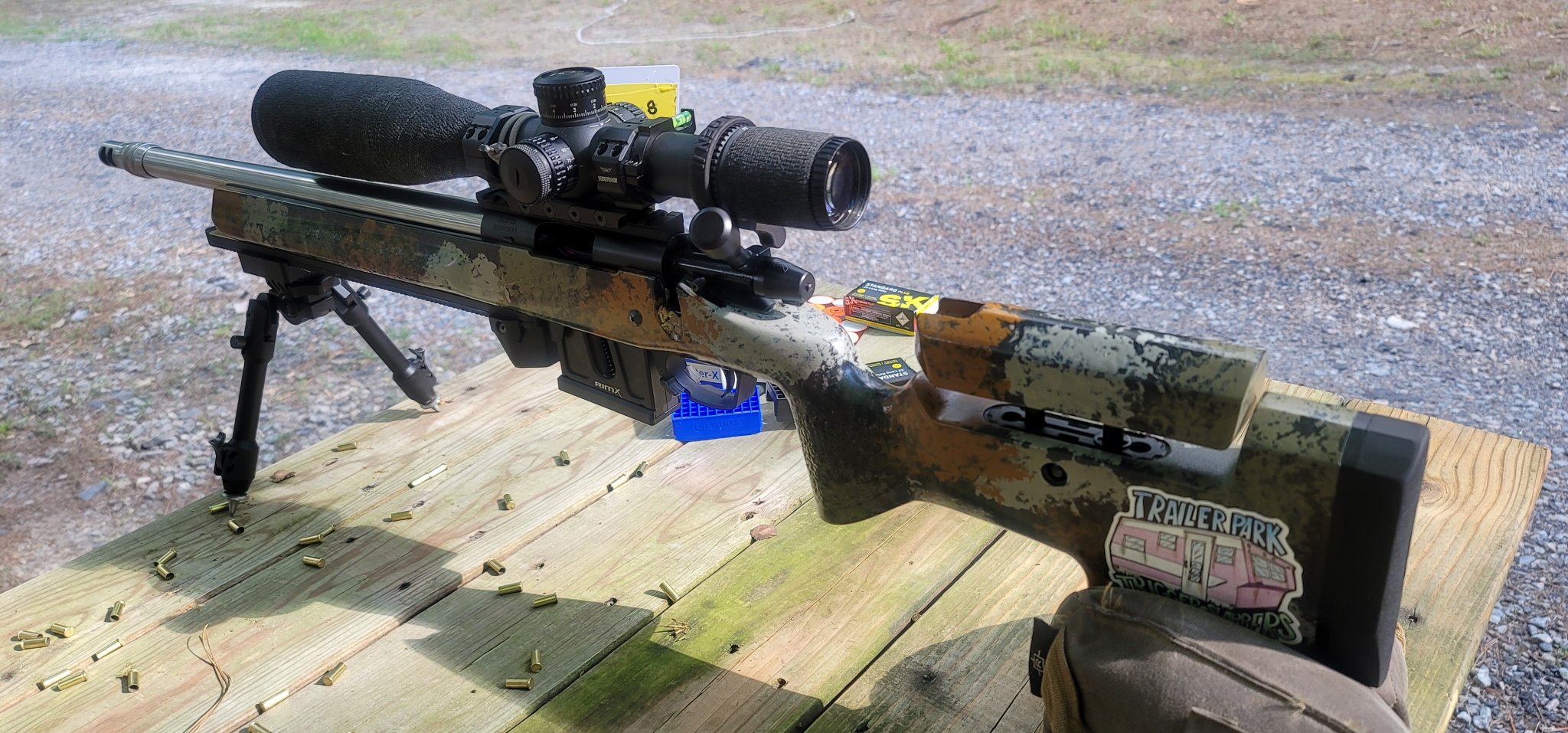

What kind of rifle are you having this problem with?
It's a Rim-X that has a Straight Jacket Armory barrel. Here is one of the 100 yard groups it shot yesterday after the barrel had a few rounds through it.

As @littlepod stated that erratic flyer is most likely a carbon ring formation in the chamber in your barrel. With my barrel clean but seasoned, I get a predictatble cold bore shot which is about 0.25 inches high and slightly left of POA. Then I start getting the same phenomenon with erratic first shot flyers about 500-700 round range as well. I run a RimX with a 18 inch Proof Competition Contour barrel. Most don't realize how difficult a carbon ring is to remove unless you borescope the barrel.
