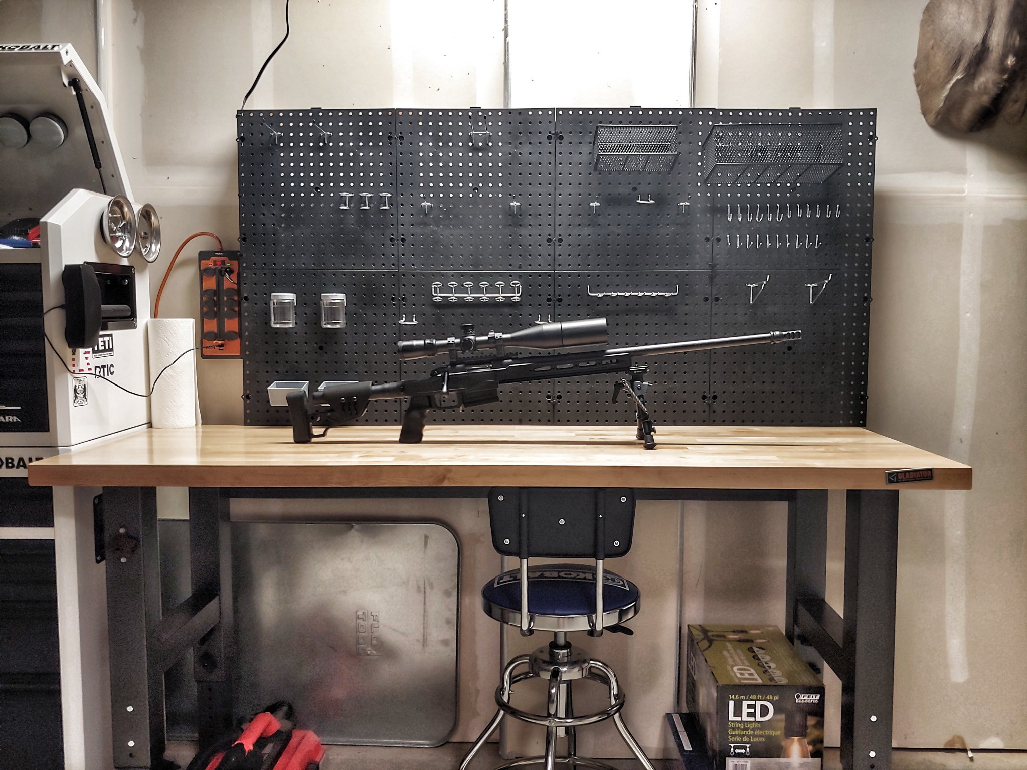

Like the title says, this is my very first time entering this realm and it's something that Ive wanted to do for a very long time. Well the time is here and I wanted to reach out in this forum for any glaring needs in my kit.
I will be loading 6.5 Creedmoor and just yesterday I purchased what I need, my question is that is there anything that I may be missing that I MUST have in order to reload? I know there are a plethora of things that I will likely need at some point but I'm more interested in the things I absolutely must have before starting.
This is what I bought:
Lyman Victory Single Stage kit
Forster benchrest die set
LE Wilson Case Gage
Hodgdon H4350 1lb
Hornady 140g ELDM bullets 100
CCI #250 primers
Starline brass (brand new) 100 cases
It will all be set up in the workbench station I built in the photo. Thanks for your time and go easy on the new kid!

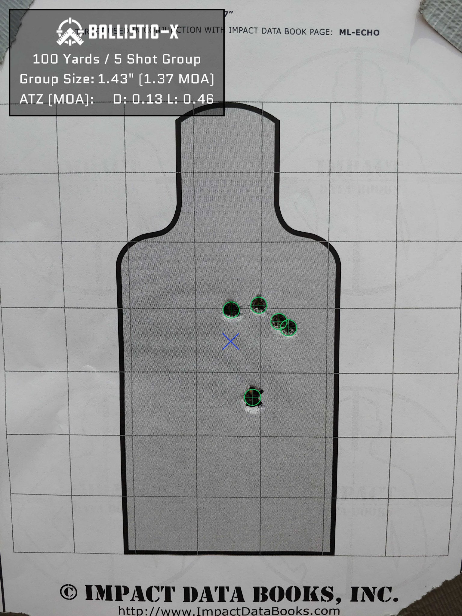

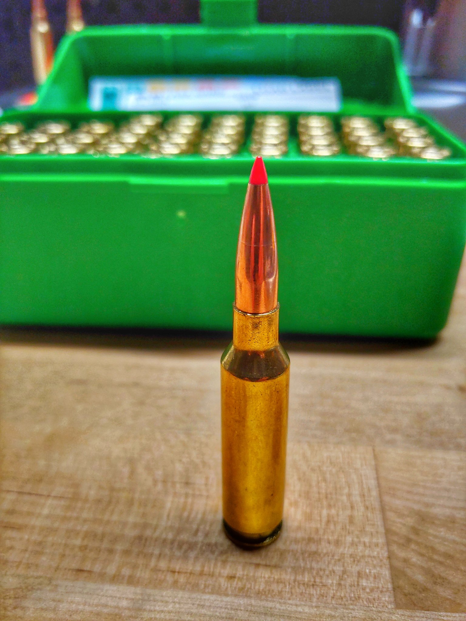

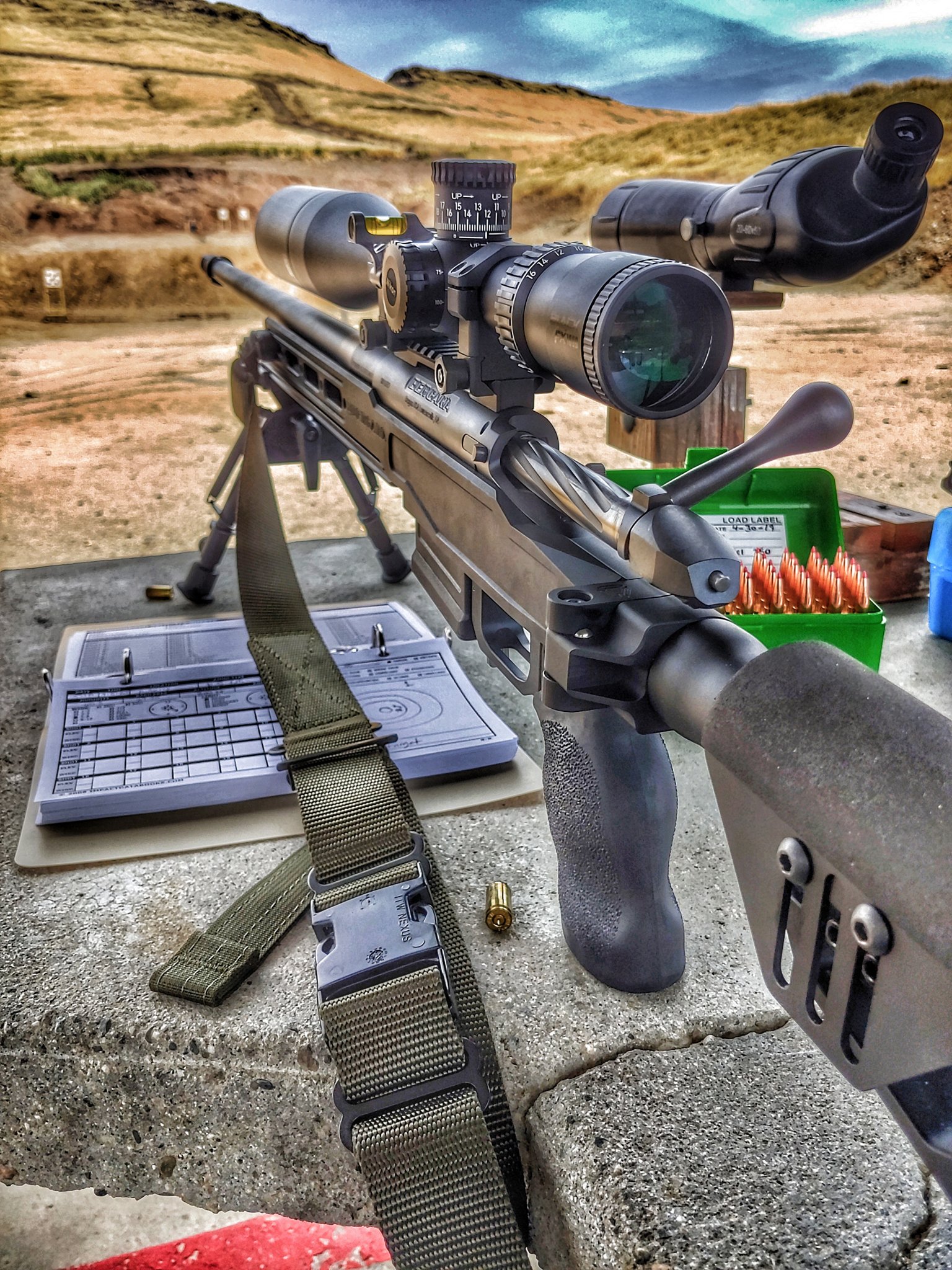

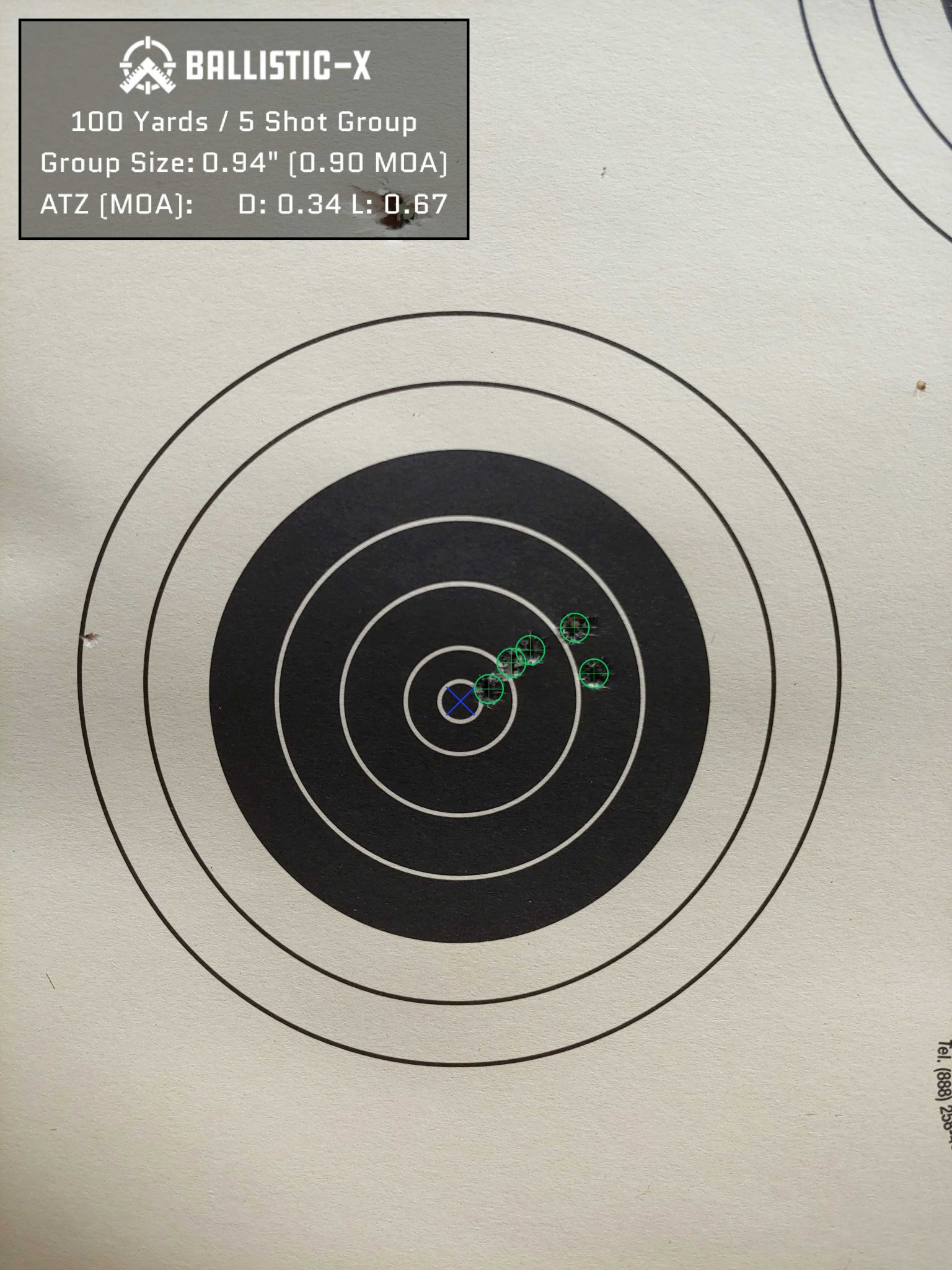

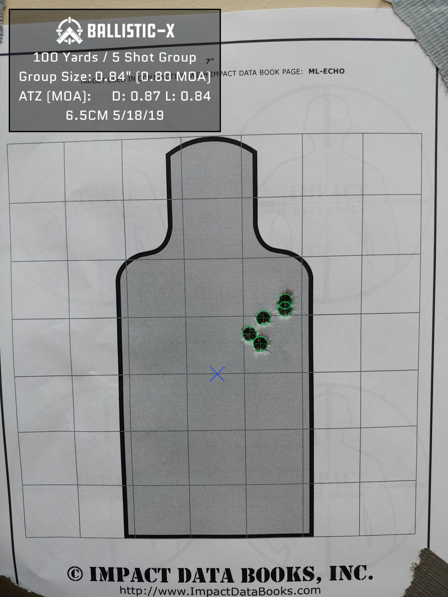

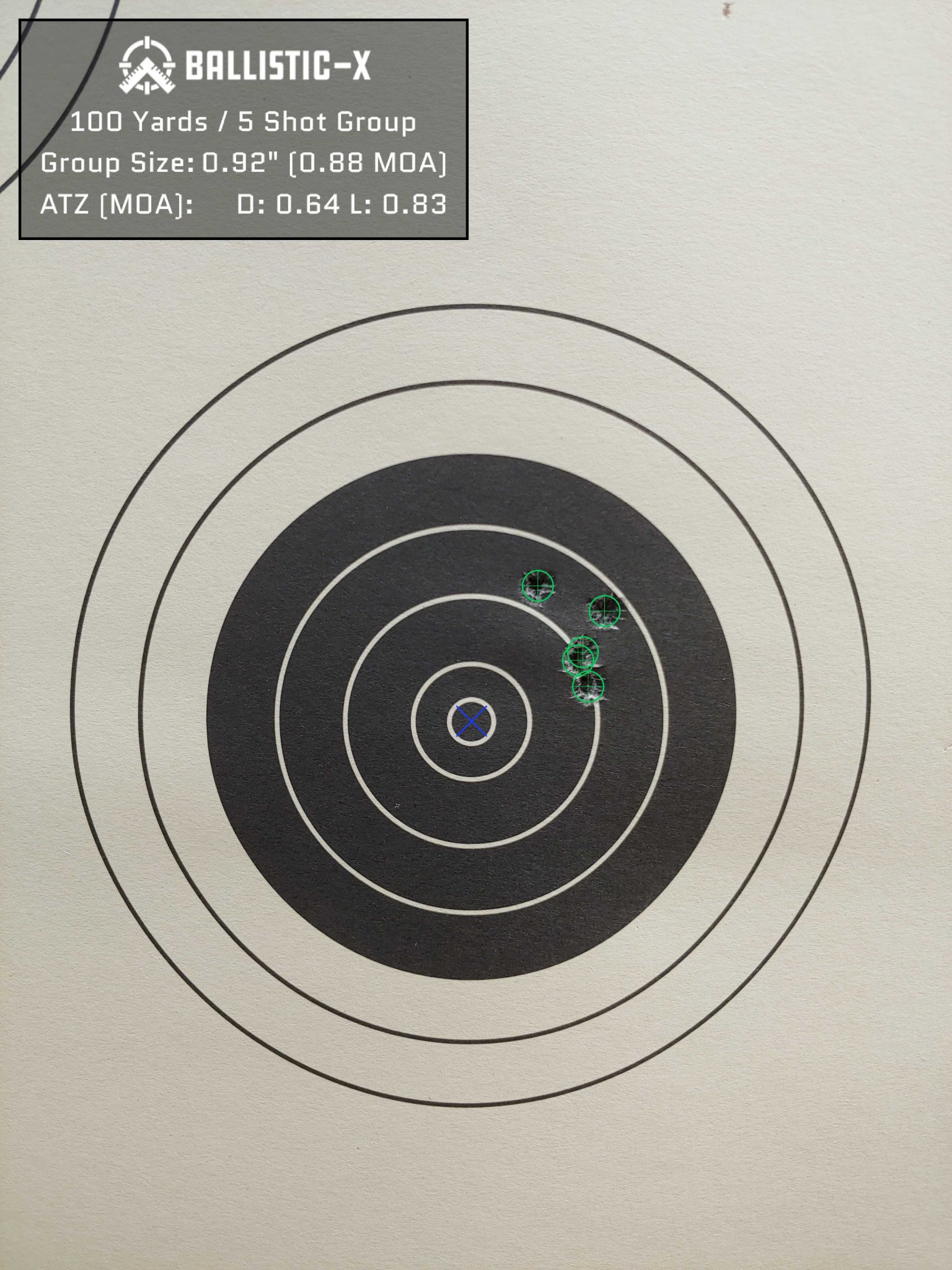

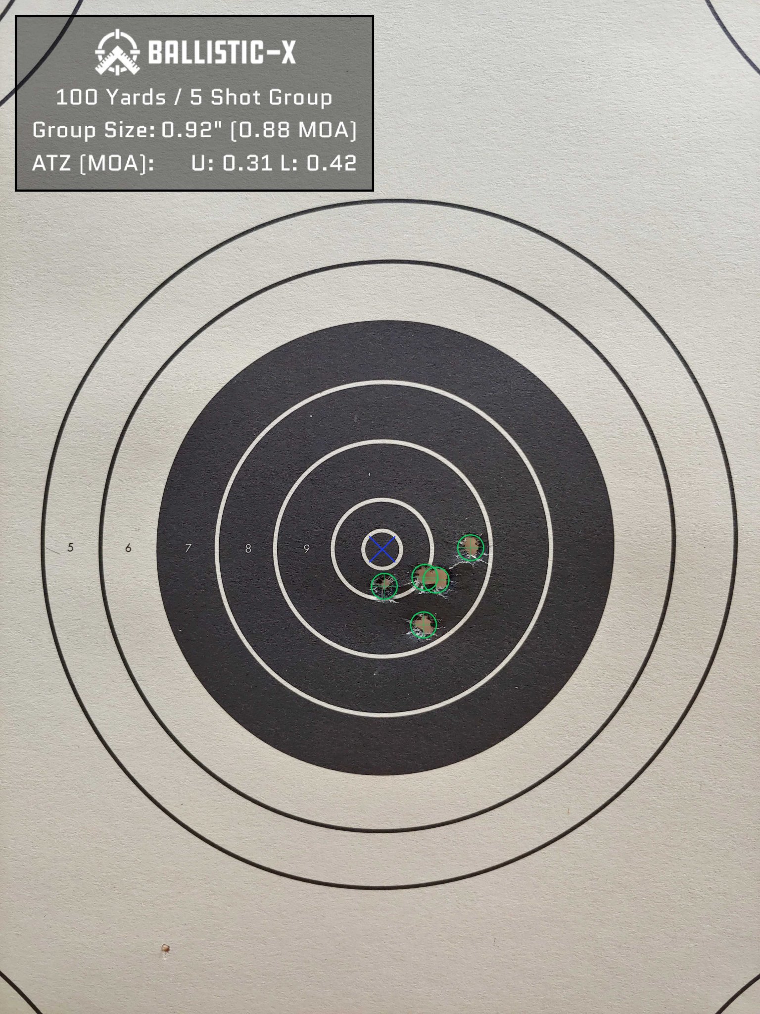

First range day today, Zeroed in the rifle and am happy with it's performance.
All of my reloads worked perfect and was impressed with the accuracy right away. Was zeroed in 3 rds. It was a pretty windy day but the scope needs some minor adjustments as a lot of the groups were high and right by less than an inch. But really overall am happy.
I don't have a Chrono yet so I couldn't get much info but I noted down all I could with what I had.
Now to start with load development.
