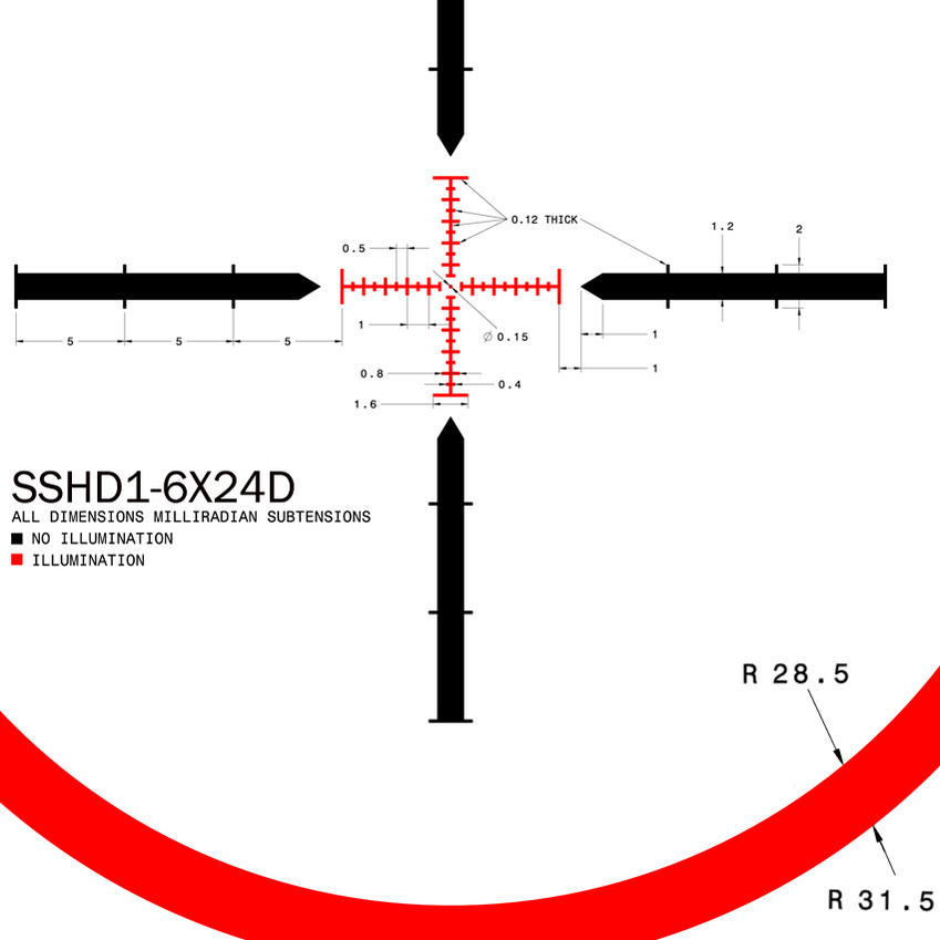

I am confused about some of the measurements on the SWFA 1-6 reticle shown below. At the top of the reticle, it shows the hash marks being .12 mills thick, then on the bottom it shows them .8 and .4 mills thick. Am i missing something or did they make the hash marks different thicknesses? Also the 2 on the far right of the image, what is it pointing to? Is there a faq that explains mil/mil reticles/turret scopes.
