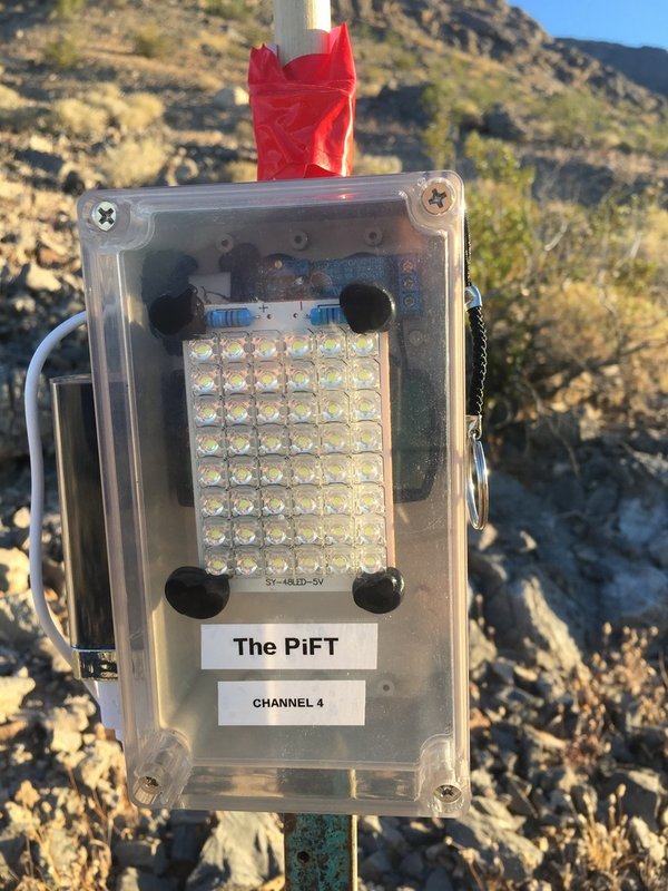

I have an email address for the creator of the "Pi-ft" system. He said to use it for ordering through paypal. The units are $125 each + $15 shipping
[email protected]
Haven't been able to try these units in the field yet, between high winds and current fire restrictions (firearm restrictions) at our ELR site, no joy on shooting with them yet.

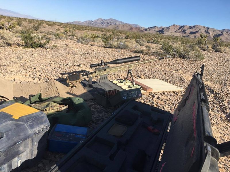

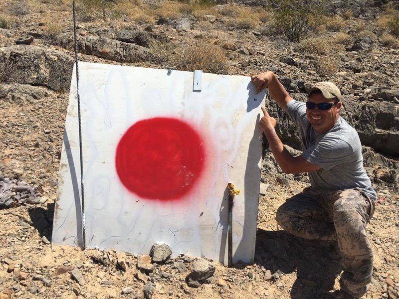

2%20MILE%20SHOT%202_zpsirm7bhwk.jpg2%20MILE%20SHOT_zpsavnckpoz.jpg I have the PiFt units. $125 ish each. Impacted 2 miles a few weeks back, flash was clearly visible both to myself and to my spotters.
Excellent! Thanks for the field report. As I suspected & looking forward to using ours. BTW, the link you posted does not work, says "forbidden access to the server".
