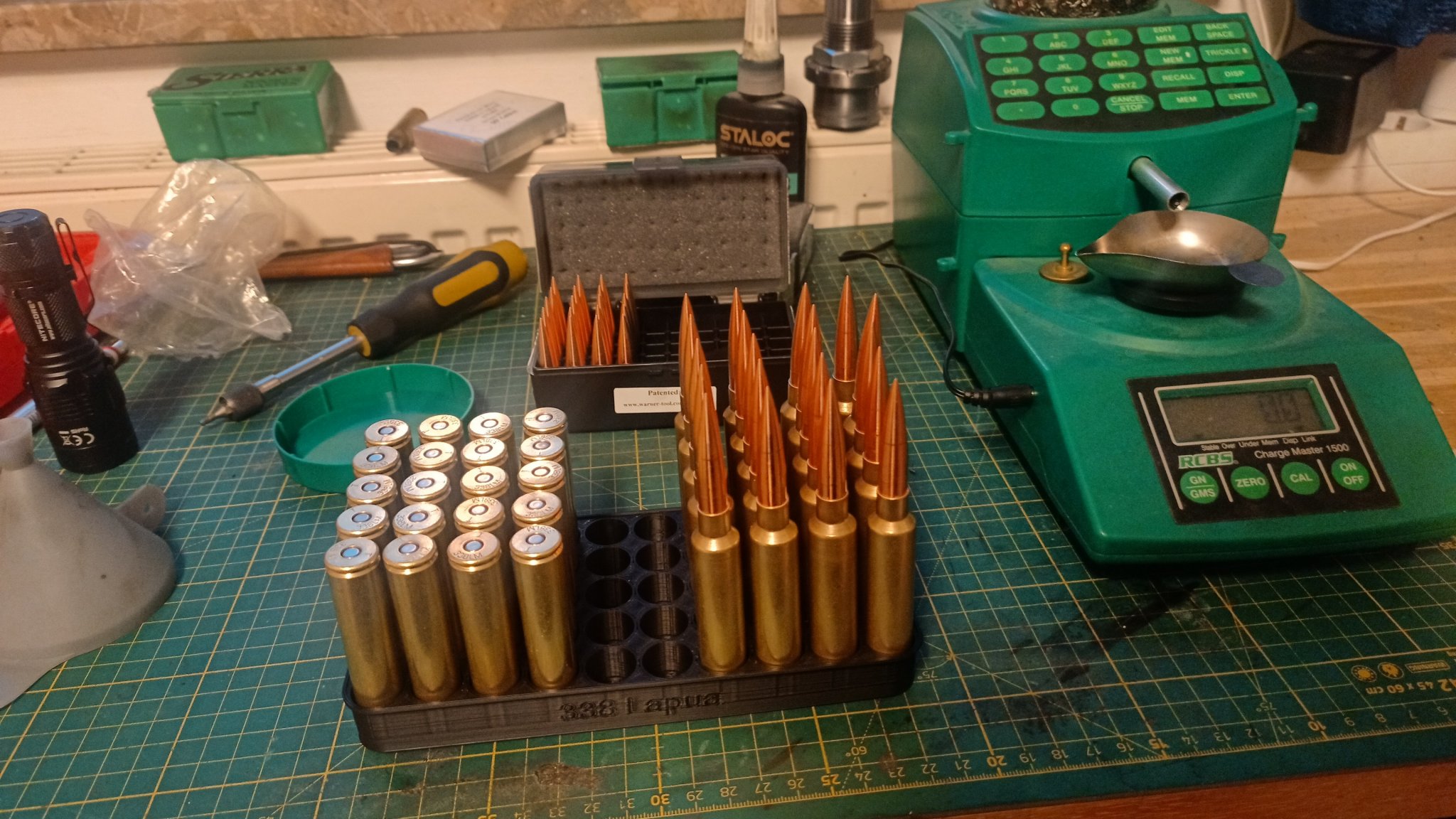

Flatline bullets .338 285gr
JakobHellman
Jul 27, 2021
4
3
Sweden

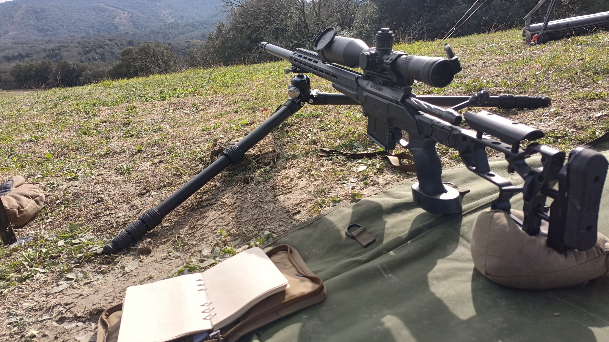

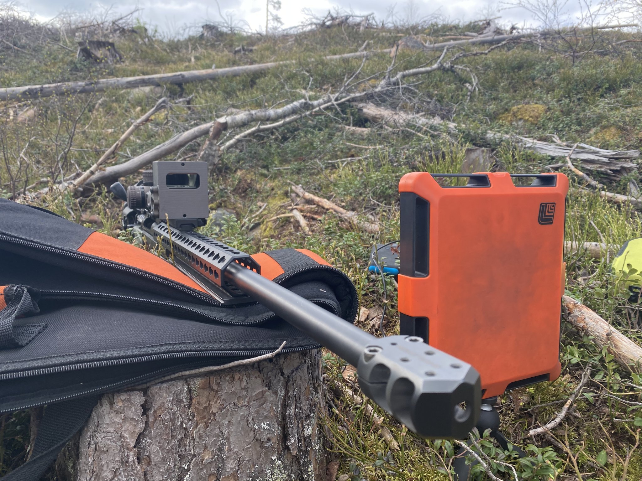

Have you try this bullets for ELR? I will make a new 33” barrel in 1:8 with a throat for this bullets. I just wondering if I will us N570,N565 or N560? I want high speed and low es.
I use today a 1:10 barrel and use scenar 300gr and 285gr eld with N570

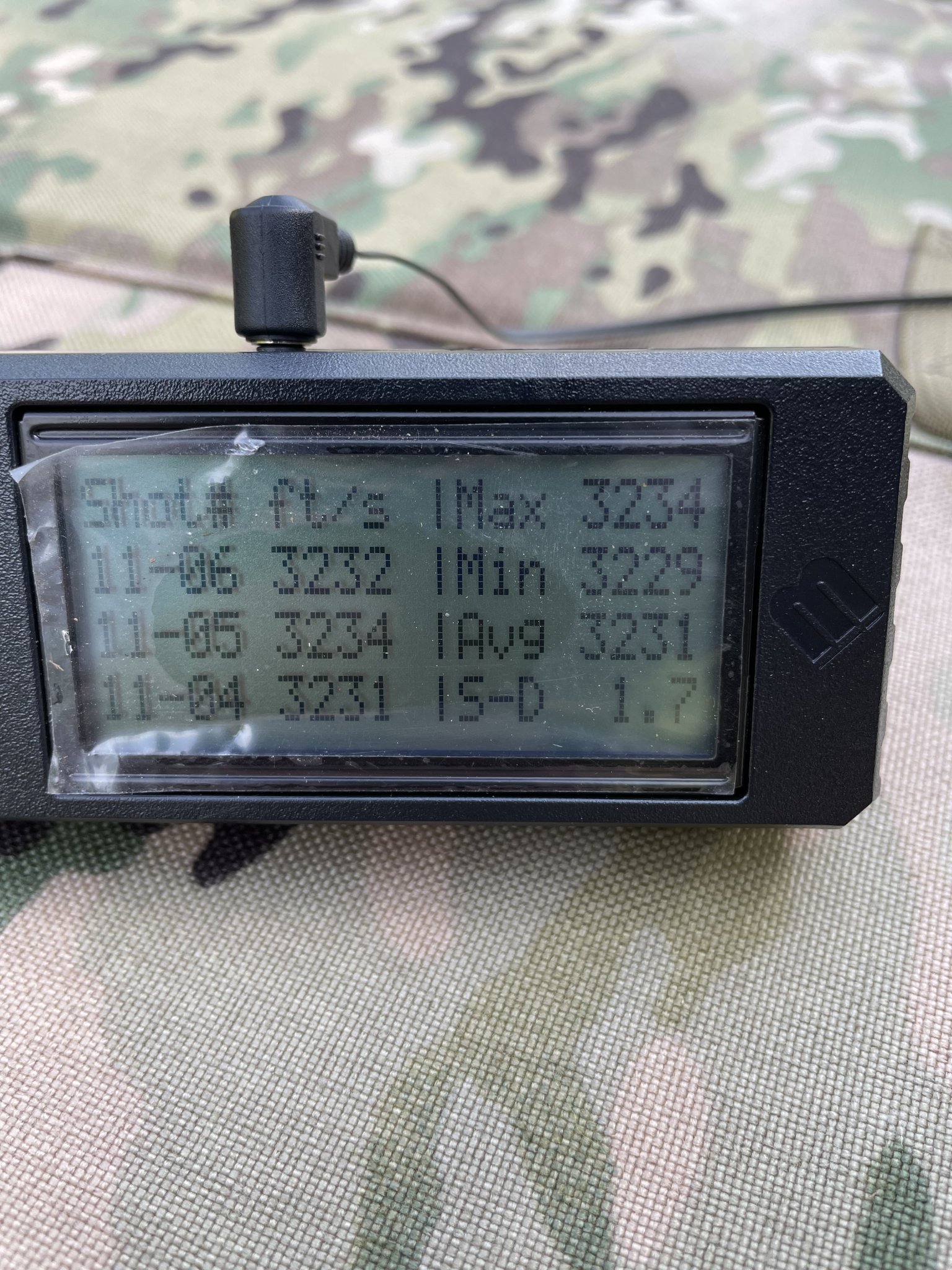

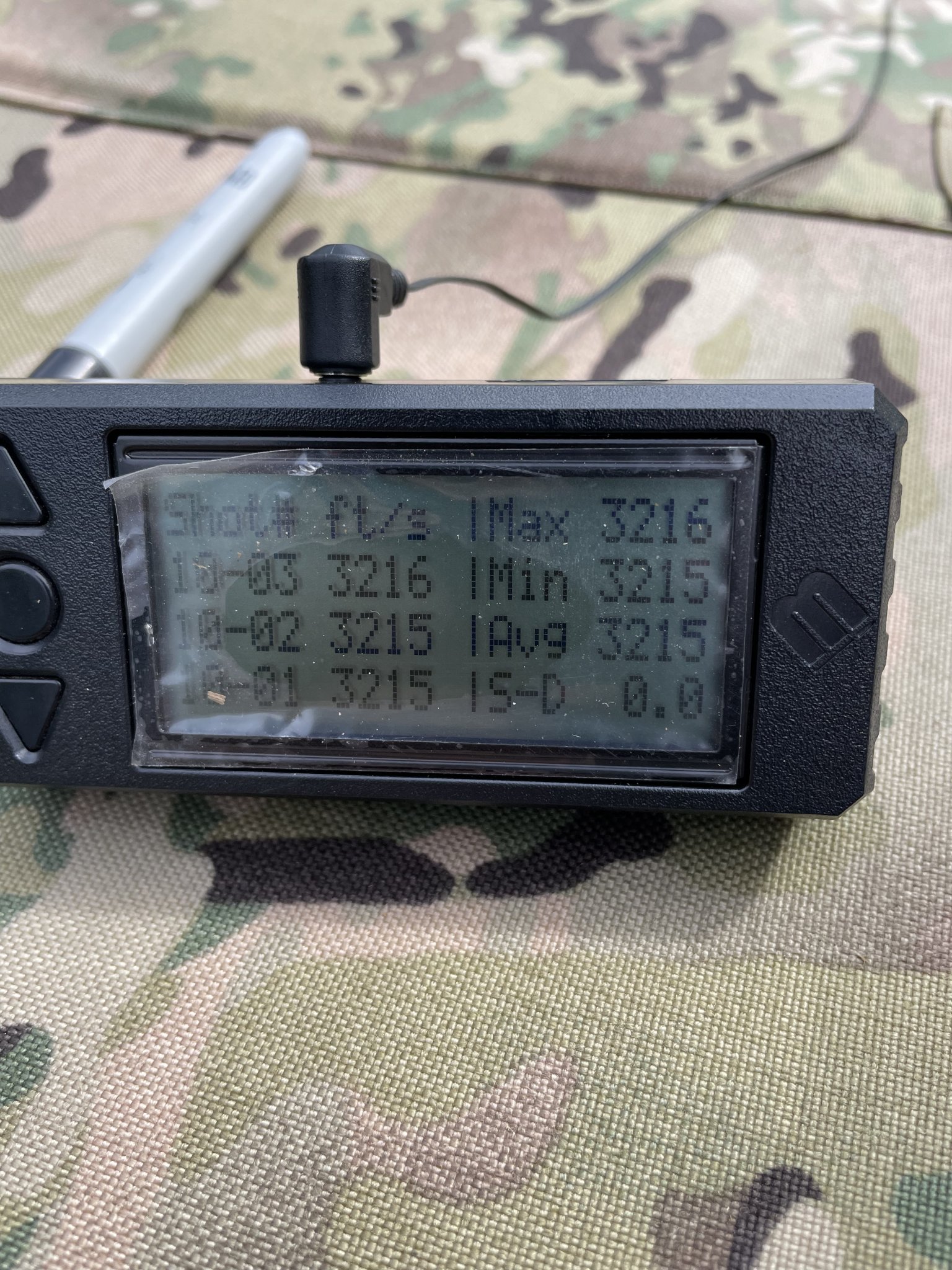

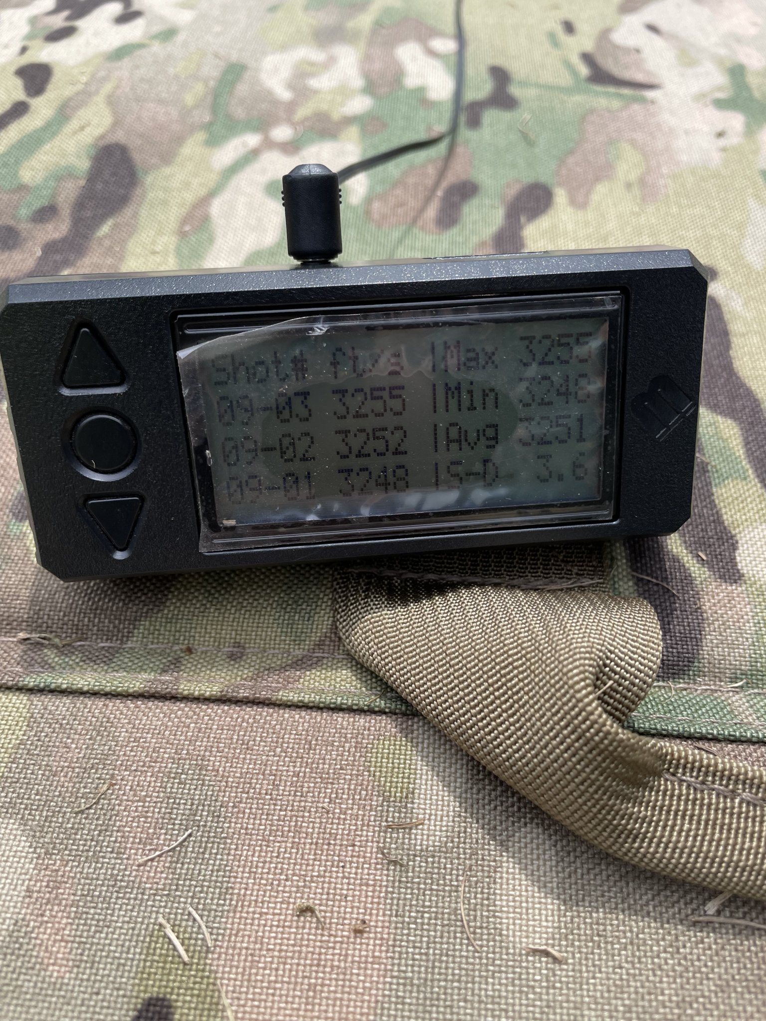

I use them in a .338LM Improved 40. The normal go-to powders for that cartridge (N570 & RL33) are a bit slow for this bullet, so I use N565. Unfortunately, I've haven't had enough opportunities this year to take them beyond a mile to see how well they handle beyond the 2000m mark.
According to the QuickLoad data Warner sent me…N570 and RL-33 are the top performers w the 338 LM AI and 285 FL! I hit 3350 FPS w the 256 Flatlines and N570 in a 30 inch 1-9 twist. Waiting to chamber up the 1-8 before I play w the 285 Flatlines.
Reactions: 338dude

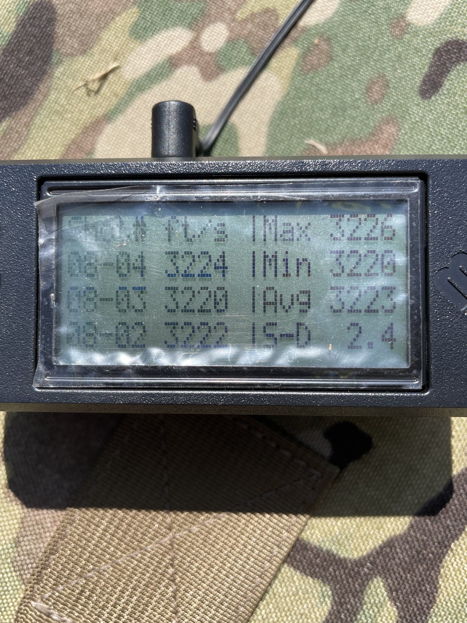

I use them and 265’s in my 1-8 338 edge.
I’d recommend a twist of at least 1-8 for them.
With N570 I can safely get a bit over 3000 with the 285.
Had them to just under 2 miles so far and they did well.
The 265 is an excellent option as well.
Be careful with the Warner data with the 285 badlands because for me it’s the hot ticket to a sticky bolt.

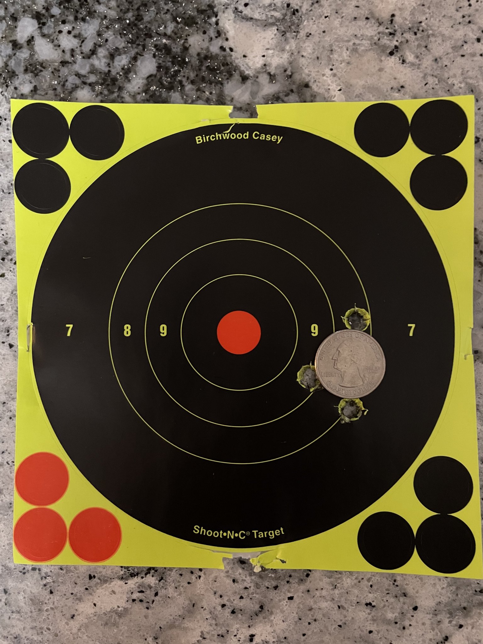

33XC Warner 285 FL w n570 tested up into pressure. Started at 338 LM AI charge and ran up just shy of 3300 fps (to hot in my rifle). Going to fine tune this load around 3200 fps (safe load) Odd that 10 gr swing in powder charge weight shot a .5 inch 6 shot group at 100. This barrel/bullet likes the same jump I use In my 338 LM Ackley Improved.
Sorry to Hijack a bit but out of curiosity how does your guys charge weight change from going to a solid vs cup and core, like say you went to a 285gr ELDM could you use similar charge weight or would it differ significantly?
Reactions: 338dude

finally it was time to do some long range shooting.
Spent the last 3 days on the "skiritai legacy" range in Italy (about 9hours drive from home) and tested the 338 LM AI with the Flatliner and Hornady ELD M out to 2200m 2400yards.
first time ever to shoot her beyond 100yard.
Wind was a pain in the a§§. strong winds and big gusts all the time. There were moments we had to hold the tents down...
But she performed waay better than expected!
285 WTC FL ELD-M
1680m (1837y) 14.7mil 19.3mil
1765m (1930y) 16.0mil 21.2mil
2010m (2198y) 20.0mil ------
2200m (2405y) 24.5mil ------
the eld-m were loaded a bit slower to 2952fps the Flatlines ran 3097fps at about 10°C (50F). The wind was soo bad i had to dial 6,5mil left at 2200m and still had to hold between 0.5R to 1L... Also shooting over that valley made it tough to read wind. the 2200m targert was way higher than the firing position so the bullet traveld quite far up and winds there were bad but not possible to read.
