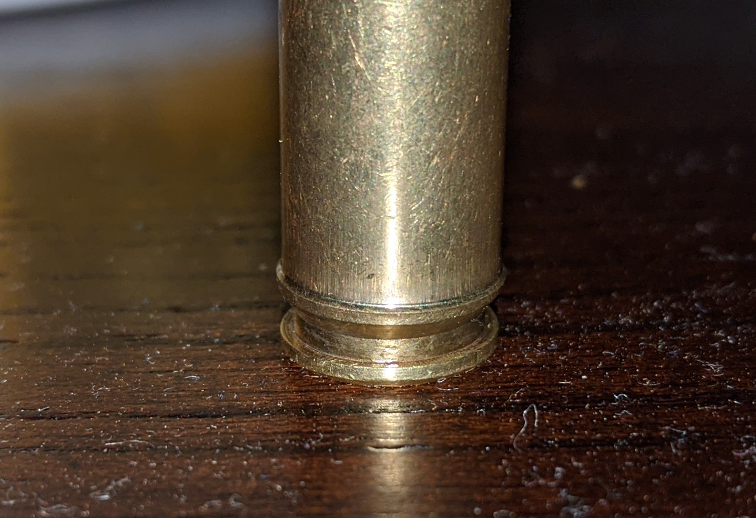

FLSizing 308 problem
1jonathan1994
Feb 21, 2018
263
27
Laurel, MS
I'm using one shot as my lubricant. This is 308 zqi brass from a semi and going to another semi. Bulk ammo not precision.
spraying the one shot on with the brass laid flat in a plastic pan letting it dry. Then shake it up and give another shot or two. I'm not actually standing the shells up in a loading block to spray the one shot. Letting it all dry at least 5 minutes after spraying. About 1 in 10 looking like the picture. Bases start about .472 and the successful cases finish about .470".
Bad cases are way over .480" and about 0.005" long to the datum
What's going on here?
Too much lube?
Not enough lube?
Cheap brass?
Taking too much in one bite?
Dillon 750 with case feeder.
In the past I used a Forster will lanolin lube but... slow. And have to clean it off.
Also, are these cases scrap?
"And thats how belted magnums are made kids" lol.... j/k

That doesn’t look like excessive lube ,I’ve never seen a belt get created by over applying lube something else is going on with those cases ....shit can them & use another head stamp brass .
Reactions: Snuby642
I am shocked you sized multiples like that and didn't stick a case. Not even mad, just impressed.
Are you using a small base die, by chance? What are your unsized cases starting at? It looks like a loose chamber resized with a die that's too small, pushing a bunch of material to the case head.
I'd def shitcan the deformed brass. The ones that sized properly are probably ok if they pass a visual inspection, they just probably wont last very long repeatedly sizing them like that.
Cases are scrap.
If you are correctly measuring the base and getting .480+ something is very wrong.

That is very impressive. I probably would not shoot that case. I would section it and a good case and start measuring - maybe something to learn there.
The SAAMI drawing says that the max chamber diameter is .4738 + 0.002. As noted above, +0.200 from the bolt fact, the max is .4174 + 0.002. If you have brass that is .480, then it is 0.005 larger than "max chamber plus the tolerance".
If you want to save the brass, you might try lubing with Imperial sizing wax. I have never dented a shoulder with it. Yes, you have to tumble it off later.

Id consider going to a lanolin/alcohol based lube....
Not that your lube is what caused that but because its often found "One Shot" will stick a rifle case.
Ive used "One Shot" for pistol but for rifle I use Dillon case lube.
Good luck with this problem. Almost would suggest die is out of spec.
Is this a Dillon die? They chamfer their opening to help with the progressive operation.
My usual concern is that the bottom of the case does not size enough where the chamfer of the die does not touch the brass.
I would say this is good proof that one shot will lubricate cases sufficiently...

My anecdotal experience is of regular dies, sizing as expected using "One Shot" and having a case bind......it has a nickname even "One Stuck".

I'm really surprised you could do that to a piece of brass and not get it stuck. Is this nato brass, I stopped using one shot on anything other than 5.56 brass. In truth the price drove me away all together. Been using Unique case lube the last few years. I have stuck a couple of .308 cases with one shot.
I thought tat too at first. But I had a rifle that really stretched the brass at the web because of a bad chamber and the die would always squish (technical term) it back to shape with a shiny rub area there.
Agreed fired in an oversized chamber. Metal fatigue is real thing and not something to mess with. I’d scrap it but I’m also not going through my first components shortage.
Been using One-Shot for ten years. If you don't angle the nozzle correctly, and spray from both sides to be sure you're getting it into the necks, it'll stick. Clearly, the OP's issue has nothing to do with case lube tho.

Thanks for the responses and help. I trashed the “belted cases”. A lot of my problem is trying to short cut things to one brass prep pass on the RL750 vs multi passes through a Forster single stage.

Well that's complicated. Greatly simplifying your post, I think you are trying to make bulk 308 ammo that fits all your guns. But you have all sorts of chamber sizes and brass in various conditions and you are trying lots of approaches in order to reach your goal. If I understand the requirement, I have a suggestion. There is a nice man in Oregon, JGS, buy a 308 reamer and a headspace gauge. Buy new barrels for everything (or, failing that, as you retire barrels or set them back) rechamber using that reamer and gauge. If you do it right, chambers and headspace will all be the same. If the chamber is standard size, most decent brass (that is, non-machine gun stuff) will fit - the brass that doesn't fit probably shouldn't be used. I suppose that I am wasting electrons here but that's the solution.

Red Flag. It should be just as smooth sizing on the 750 as anything else, there should not be any popping and jerking. That usually indicates a lube issue.
Also, not sure how taking three passes on the forster didn't tip you off that something was out of spec, or thinking that somehow the 750 would be able to muscle four passes worth of work in one shot. You need to stop sizing like this and figure out what is going on and either load differently for your blown out chamber or just stop picking up brass out of that gun.

Major update.
First item
I found that my #1 shell plate was out of kilter somewhere. Brand new it dragged in one location and I had to set shell plate tension based on that spot. That problem never went away. I was getting 0.015 variation in final sizing (with good brass) and noticed about 1 out of 5 was shorter than the rest by at least 0.005”. changed to the #1 shell plate from my 45 conversion kit and all was good with no tight spot either.
Second item
I tried the IMI brass from the JP gun with Dillon spray lube and 90% came in measurement the first time with no headaches – smooth running. The rest I put back in the hopper and a second pass fixed most with only a few needing a final finesse. SWEEET!!!
So that had me thinking it was just the ZQI (MKE 14) brass and/or One Shot and the rest should be a breeze with Dillon spray lube.
NOPE!!!!
I throw everything else in the hopper and break pins, hearts, spirits, etc…IT WAS HORRIBLE. Even a stuck case. I got about a third through my 308 brass collection and then I just backed the die out 1/4 turn and run them all…eventually…painfully…
Some would slide in and were obviously barely touched. Others nearly stuck and I had to work the handle a bit. Of course nothing was usable and 1/4 turn out, just hit once to get the bodies and necks close.
Then I spent HOURS sorting by headstamp. Unfortunately this seems key to bulk and range sourced 308 even though most of it was from the same gun.
Finally, I turned the die to the desired height and started with the commercial Hornady and Federal brass. Both these went pretty good. I ended up pulling everything from station 4 and measuring it. If it passed, I put it back in 4 so the .306 turning mandrels could finish them in station 5. If not, put them aside. Then turned the die down and bit and re-ran the rest. Not bad. The Federal brass actually measured out more consistent than Hornady.
Much of the other headstamps were massive headaches. DEFINITELY, different brands needed the die set to different heights. So each headstamp was like a new set up. LC was pretty hard. Some Range pick up MEN 16 was very easy. Measuring every case sucks. Measuring the trouble cases 2 or 3 or even 5 times sucks.
End result I have about:
300 cases ready for bulk bullets and minimum charges.
just over 100 each of Hornady and Federal cases for some full pressure hunting ammo (125 Nosler Accubonds for deer and 125 Speer TNT for coyotes/piggys).
300 ZQI cases that will ONLY fit my 308 with headspace issues.
The IMI I have 100 resized and another 900 new in box. Might just save them and try to extinct the bulk brass first.
I ended up throwing away about 50 berden primed cases.
Also trashed about 20 cases that ballooned out at the very back of the case to where they would not fit in a hornady case gage. This is what the ZQI brass did, but the ZQI was worse.
I just put the cases into a towel on the floor and rubbed the lube off. I’m sure the necks still have some lube and the bodies don’t feel bone dry, but good enough for 3 gun ammo. Still better than having to clean corn cob media from flash holes and primer pockets.
Now I have another late night in front of the Frankford Arsenal prep station trimming brass to length before I can get the powder out.
