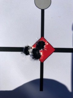

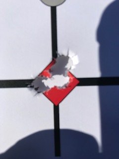

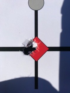

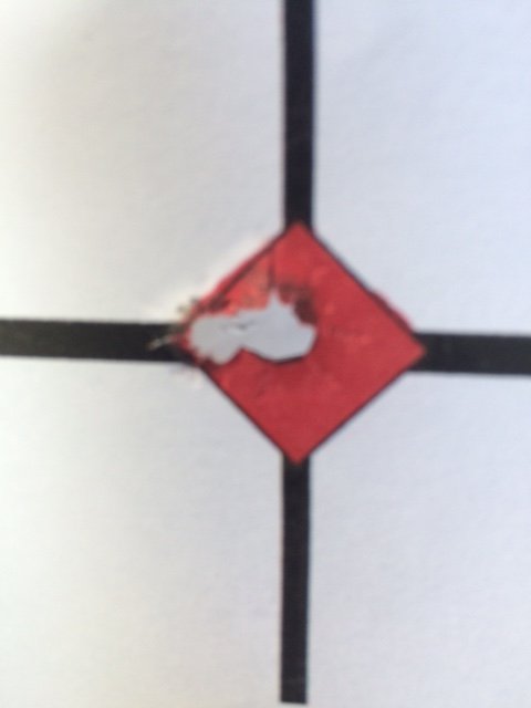

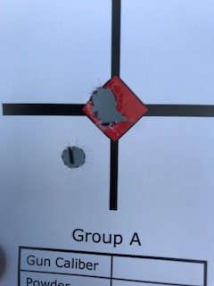

Dam mirage was terrible when I was at the range but here are some groups I shot.
