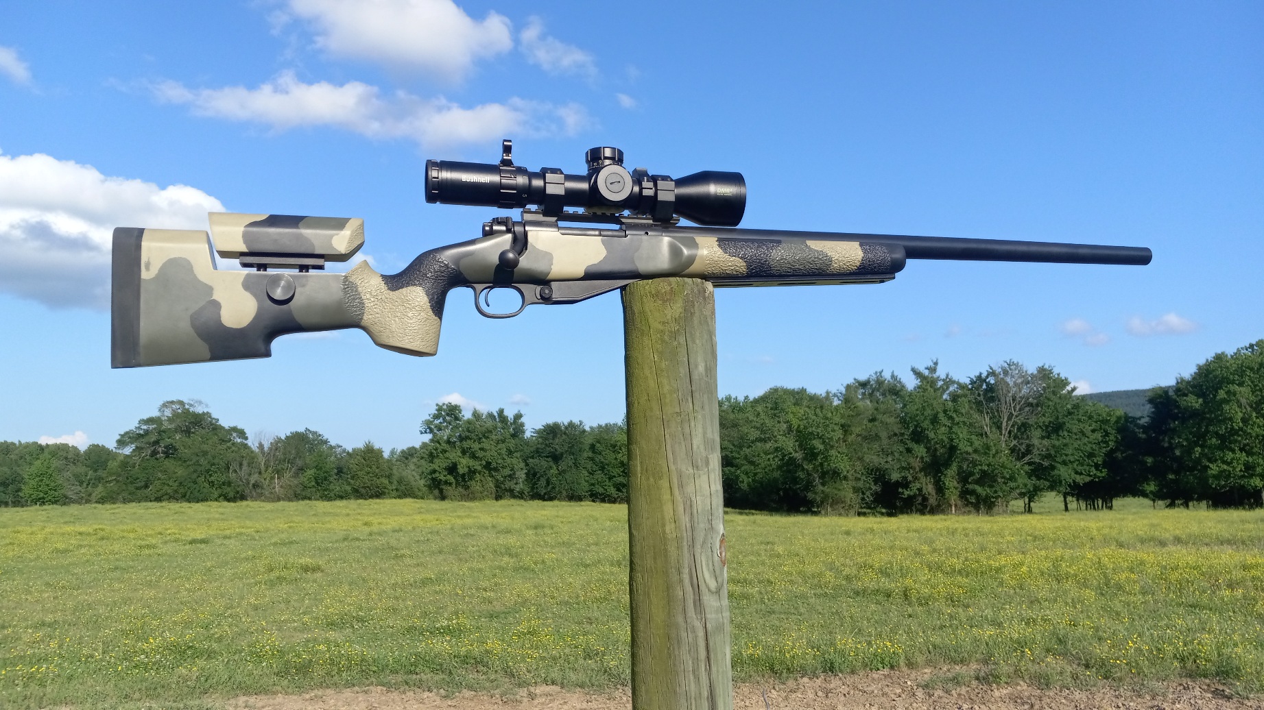

My McM A5 for the FN SPR with TBM in GAP camo just came in today.
Just be aware that the good people at McMillan have turned over enough that they aren't as familiar with the FN SPR as back when McMillan made all the stocks for them.
Fit and finish with this one is top notch. It is already pretty snug, and I'll not have to use much bedding compound at all.
Don't quote me, but I think McM is down to just offering the A5 and HTG these days for the SPR.
