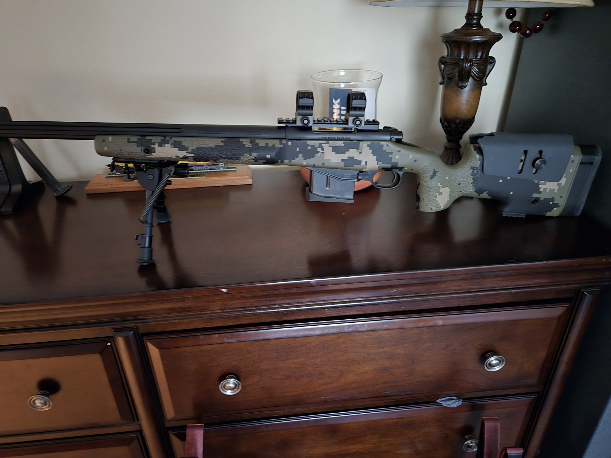

I currently am getting a FN spr a5m, Wondering what improvements can be made to squeeze every ounce of accuracy out of this fine rifle.

Thanks all found 3- 10 rounder!

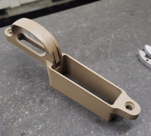

Supposedly Chad @LRI Was coming up with an Aics for m70 rifles. I'm not sure if that will come to fruition or just a myth.
This is real life now... I know you know this @stello1001, but for those who don't:
