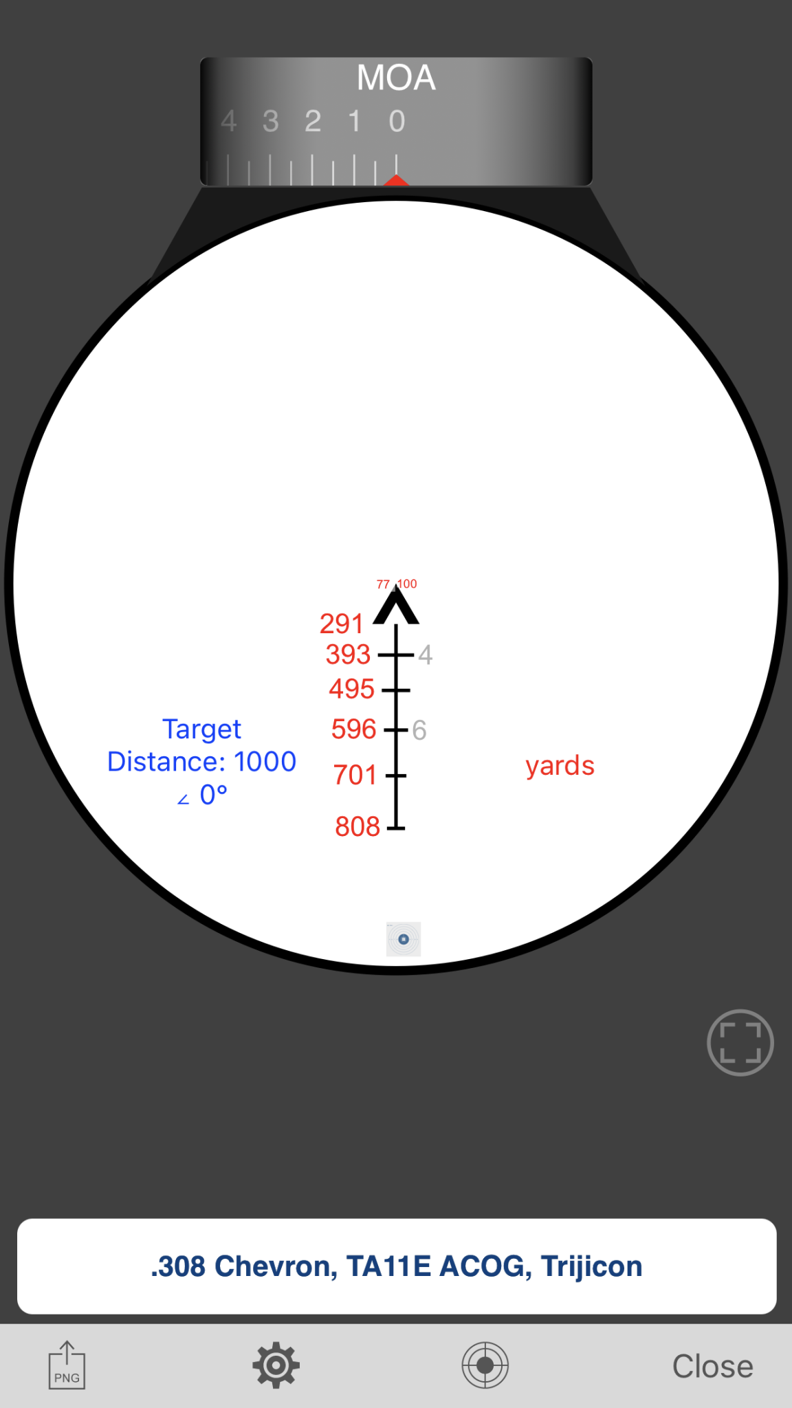

It’s not that hard to hit steels at 1000 yards. How big of a target 2-4 moa ? Do you have someone spotting you ? Had no issues hitting 1000 with a 16” 308 with factory FGMM SMK 175 at 2450 FPS.
Your bottleneck is obviously going to be that acog. This is where you’d have to aim for 1000 at 4500 DA SMK 2450 FPS.
Also if you can see your splashes, depending on the weather and terrain, it’ll make a big difference.
But yeah, slap a Razor 1-10 on that bad boy and 1000 yards becomes pretty easy.
