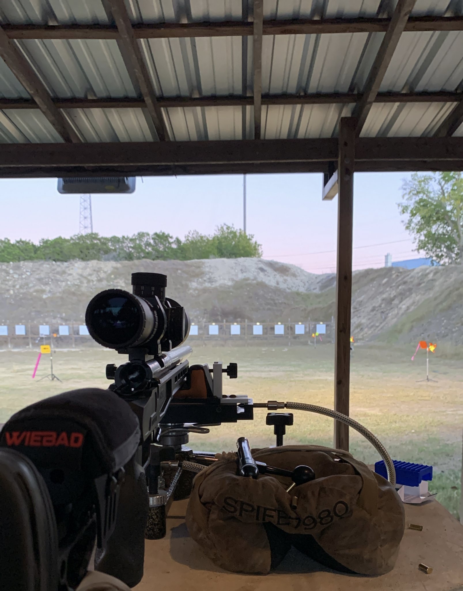

You can see my 22 chassis in my 3” bag is maxed out in pinch but the bottom is still flat and it tracks straight enough as a… 22

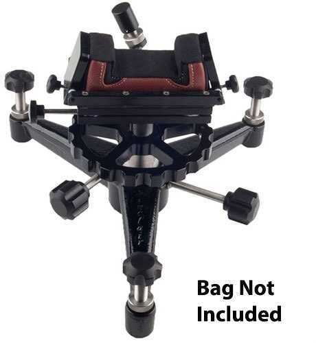

I surprised to see a Bald Eagle rest with the cable windage still intact. I quickly did the mod to remove the cable and was much happier

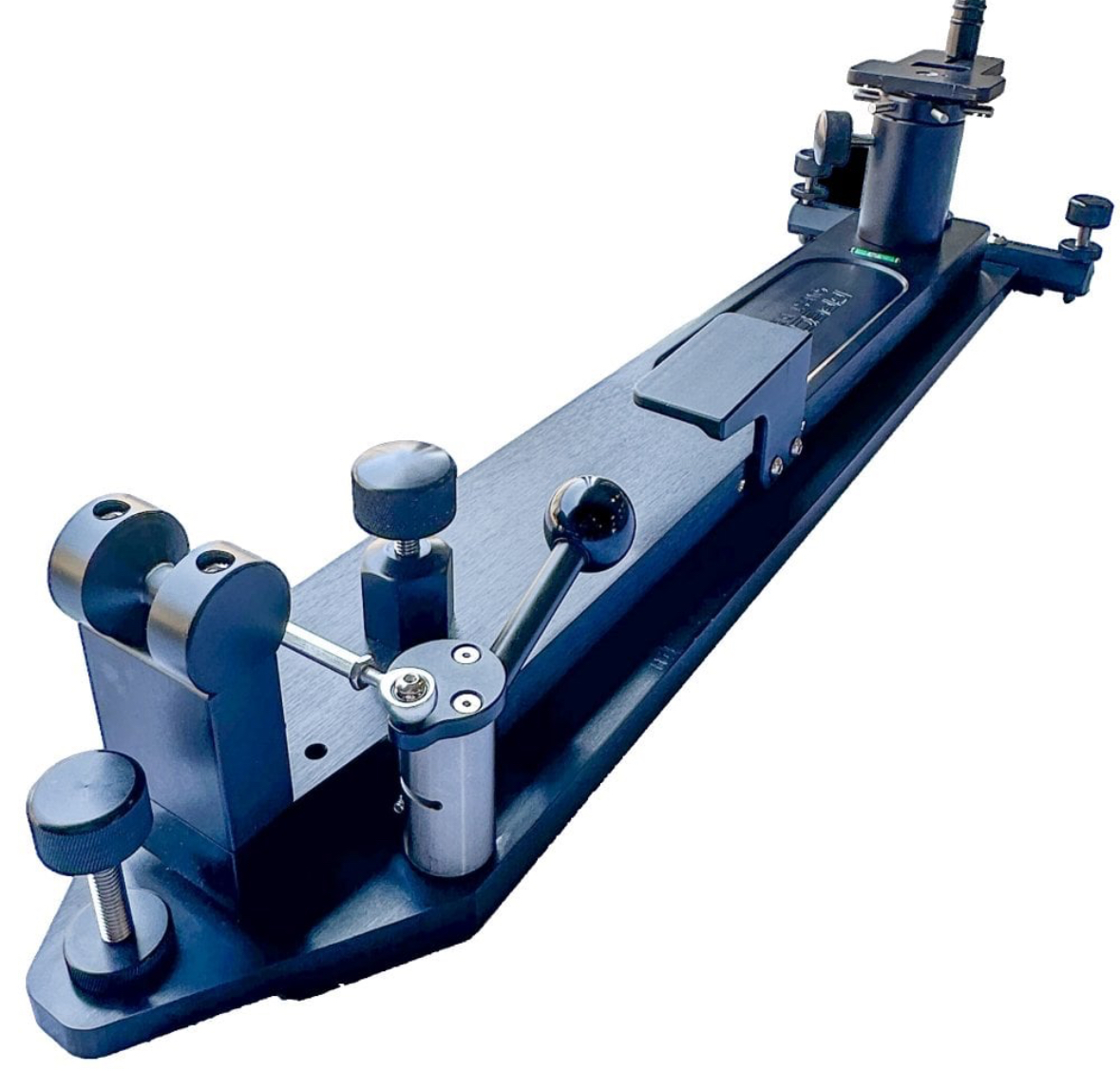

For reference, by “front bag,” the OP is referring to this:
Not a forend rest bag on a machine rest.

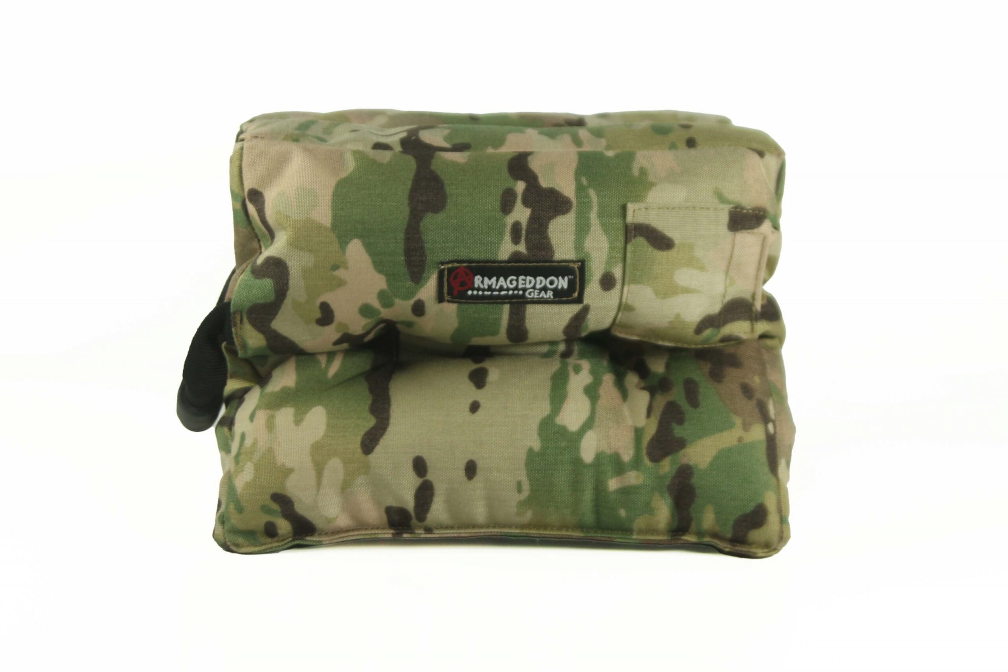

Then I suggest the reincarnation of the USA made Dog Gone Good bags made by Armageddon Gear. They took over production after the DGG bag guy retired. Still USA made.
The medium DGG one I have is way, way, way tougher than the cheapies out there. IMHO the medium is the way to go, but I shoot only up to 308.
Look like they currently make slightly smaller versions of both the medium and large bags.
DGG made a bunch of bags, including a monster large one and window versions for shooting out of a truck.
Armageddon medium (black, camo, tan)
DGG medium

I would never use sand in a bag like this. Way too heavy. Not sure what material AG uses to fill them.
Mine is factory filled with poly regrind from DGG and it’s awesome. Locks the gun in. Keep in mind the AG bags are slightly smaller so may weight a bit less when filled.
If you value your time or sanity at all, have AG fill the bag for you and pay extra for shipping. Seriously.

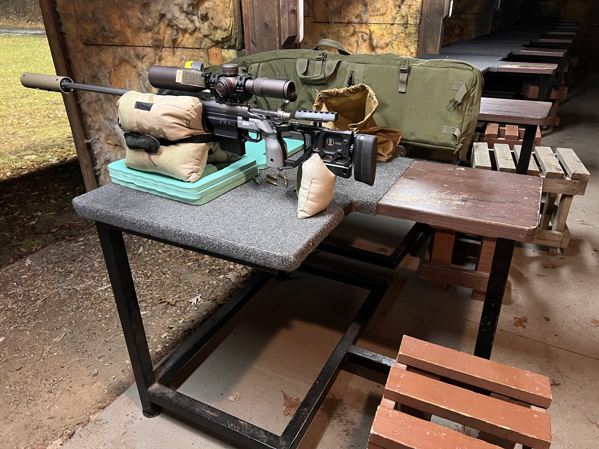

Pro tip: if you need the bag higher on the bench, a lightweight but stable solution is to use those hard-ish firm knee pad rectangles for gardeners. Here are mine I use. The pad handles are nice to grab to slide the rifle & pads around as one unit. I use from 2 to 4 pads on my setups.
My setup. I’m not a free recoil sort of shooter and want the gun locked in. The DGG bag is peeled open and the gun is snugged into the X. Push it down and the thing turns into one unit…bag and rifle. Solid!
Initially I used 3/4” slabs of maple for spacers. FUCK that got heavy shlepping around!

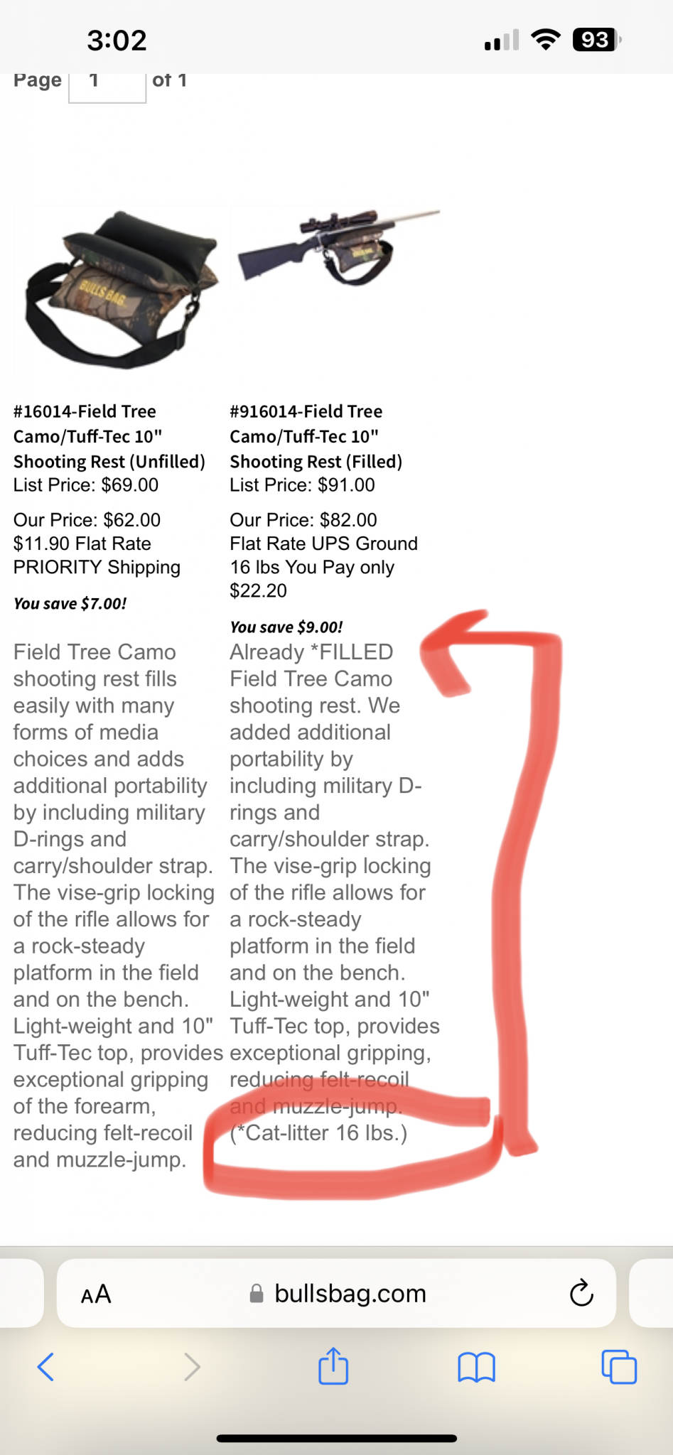

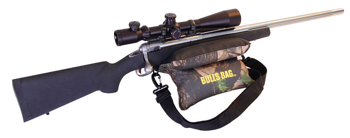

And if that's what he's talking about, frak Caldwell and get a Bullsbag and follow the directions which are to push the lower legs in a bit, drop your rifle into the top of the X bag, then pull the bottom wider until you have the amount of grip you want on it (personal preference).
Ah...how could you tell that from the OP?
That Bulls Bag looks wide open like a well-used hooker lol. My bag has the grip of a virgin butt.
Do you have a Bulls Bag?
Yes. I don't use it much as I mostly shoot off of a bipod and rear bag but its a wonderful product, very well made, and is the original X bag.
I have a 10" but they make a 15" "bench" version also.
You fill it yourself with what you want (owner recommended kitty litter and I used it and it works very well....don't think you want to get it wet, however! haha) and you can easily vary the amount of fill to suit your preferences.

An actual bench rest. Can be anything from
to
Reactions: carbonbased

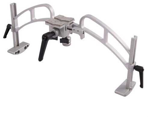

what exactly is meant by the term " machine rest "?
A mechanically elevated rest like the Rock JR you mentioned elsewhere. The Bald Eagle and Sinclair rests are fantastic for the money, with less lash than the Caldwells, and greatly improved windage control. The Rock JR you had was about as basic as a machine rest can get, and the bag that comes on it, plus the inability to compress the bag with the top, just doesn't really support the rifle for tracking the way you want.

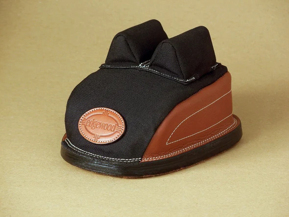

Here's one of the Sinclair models, I have - I have a couple of Protektor bags to mount to this rest which lock onto my rifle forends, but pictured here is an Edgewood rest bag (fairly certain).

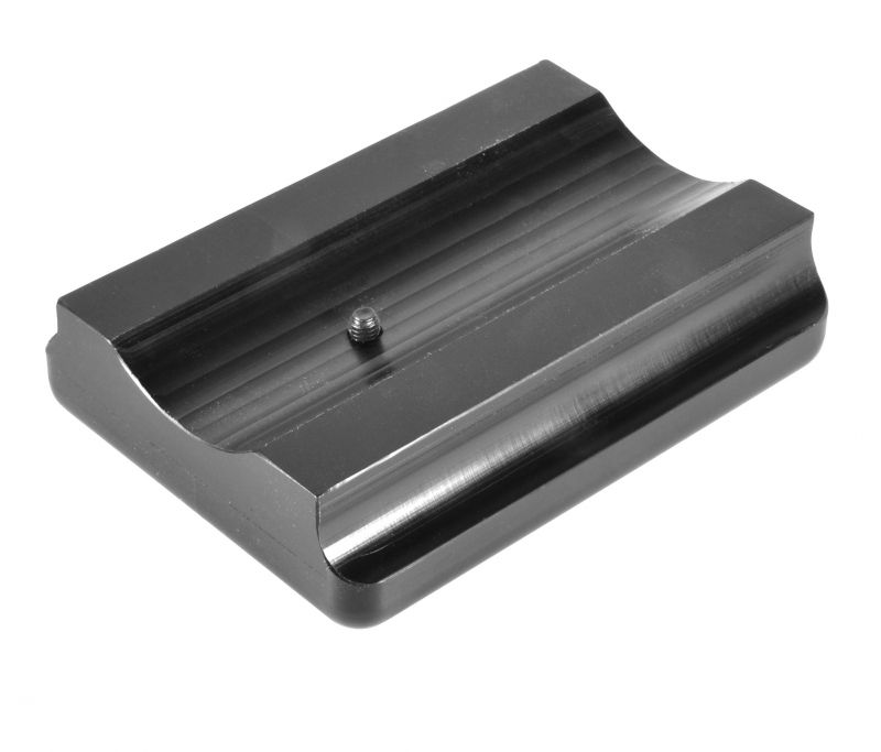

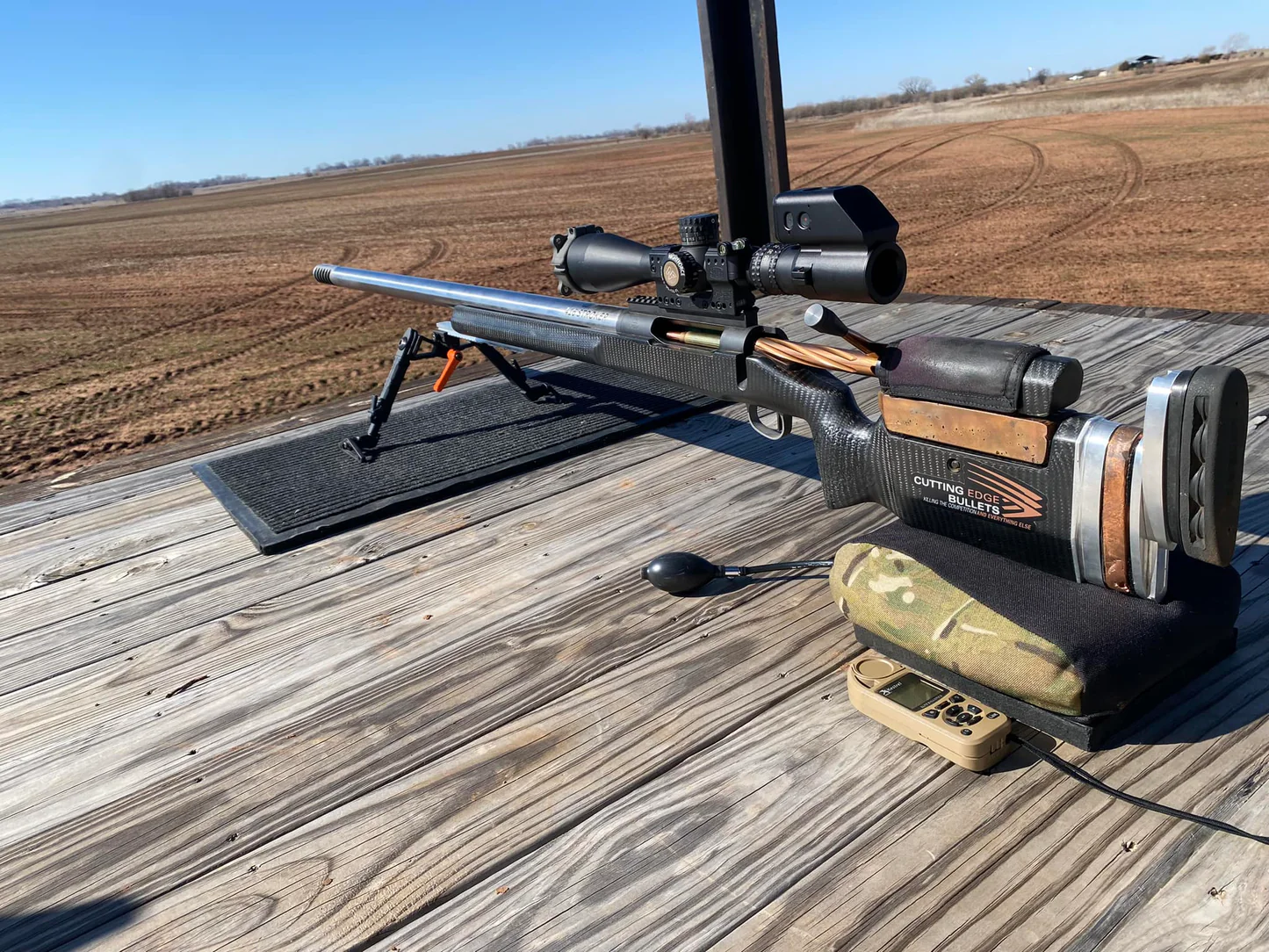

For a rounded sporter forend, stick one of these cheap EGW forend bag riders out front and party on.
You get much, much improved tracking and better rifle stability by squeezing a square forend like this bag rider block between the sides of a bag like the one pictured above. Comparing this to the Rock BR, you can see how the forend would be better supported and can ride the front bag like it's on rails - truly tracking straight into and out of the target.
These will be a dramatic improvement to your forward end support to stay true on target from the bench.
For the tail end, a bunny ear bag is almost impossible to beat for tracking on target. This is a great, inexpensive edgewood model. I prefer leather tops, then I powder and burnish the heck out of them to let the riflestock slide between the ears.
