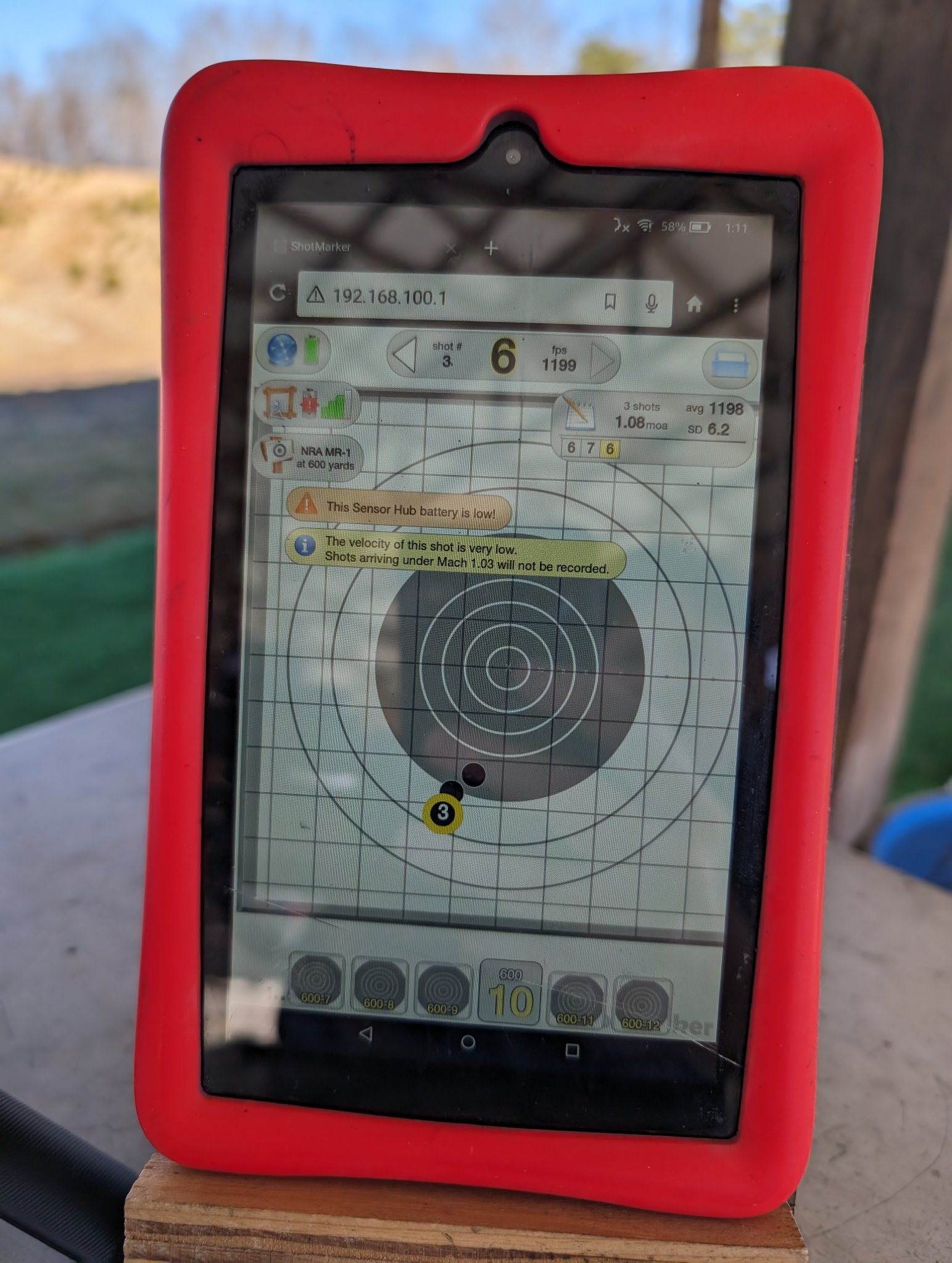

    How do you "back into" the proper BC/DOPE/VELOCITY, however you want to do it with AB? With Strelok it was fairly easy.
    I went to the range yesterday using AB data from my known muzzle velocity from my 13.7" .223 running 73 ELDMs (2354 fps avg). Everything was good out to 300y, then I made a jump to 600 and was low:
    I used the SWARO EL Range app to plug in my MV and my actual velocity at 300 yards (1708 fps) to "true" up the ballistics, pushed it to the binos and it gave me the proper extra half MIL:
    What I don't know is how to "true up" AB with this same info so that they match. There is a little over a 100 fps difference in what AB has as my 300 yards velocity and the actual velocity. Any help is appreciated.
    I must say, I REALLY like these Swaro EL Ranges. They have been spot on. Just wish I could view its data in a table....
