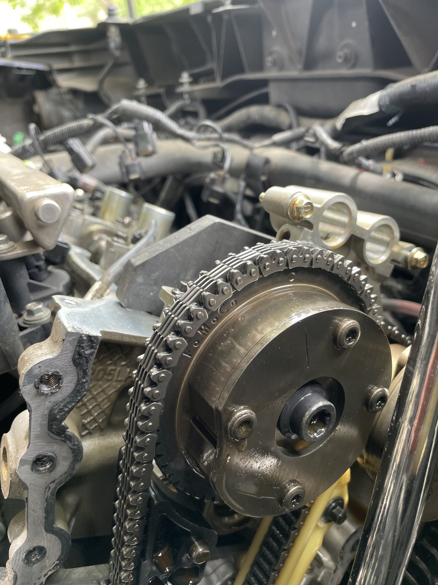

    I replaced the water pump and all the timing chains/tensioners last fall on my ‘13 Explorer xlt. Last week it started hesitating and was very underpowered on my way home and the next day it progressed to not starting at all. I spent the next day fumbling around trying to figure it out but I don’t have the proper diag tools/info in my garage so I towed it to a shop. They said it definitely wasn’t fuel related and said they thought the timing was off. I have the timing cover off, camshafts in position, & the proper locking plates on so the upper end is timed correctly. The crank sprocket, however, is waaaay off. Pictures attached below. There’s nothing broke and I can’t see anything “wrong”, like some parts that I did/didn’t install properly/improperly.
    Any ideas how/why this happened?
    Should I replace anything before I put this back together? Tensioners?
    Would the camshaft adjusters fail somehow to make this happen?
    I’m aggravated and desperate. Please help

    I’m pretty sure I found the problem. I hope… I was just messing around with all of this mess and was able to push the chain tensioner plunger/guide back into the tensioner housing a bit more than I think is normal. I really hope this is it

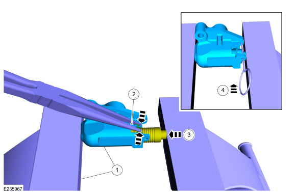

    1. Reset the primary timing chain tensioner.
      • Release the ratchet detent.
      • Using a soft-jawed vise, compress the ratchet plunger.
      • Align the hole in the ratchet plunger with the hole in the tensioner housing.
      • Install a suitable lockpin.

    The ratchet detent keeps the tensioner from being pushed back in. If it pushes back it is broken
    Bingo bango, this is it. I was able to push it in pretty far. Once I get this fucking bucket of bolts back together I’ll take a quick video of it. Fucking fuck, I hate situations like this. As soon as we pay off this shit in the credit card and get the savings back up a bit I’m buying a third car so I don’t have to freak out about trying to make one car work for everything

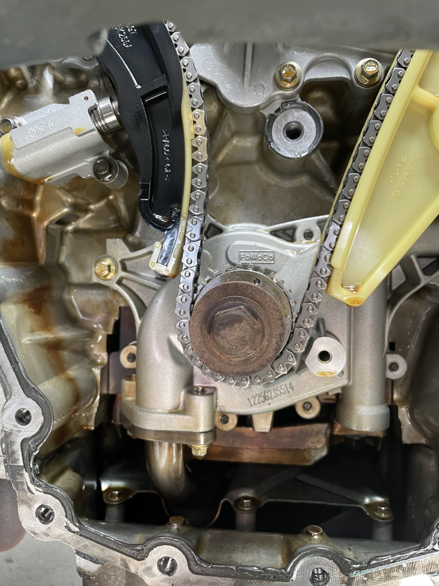

    Looking at your second picture, it looks like you have the newer style tensioner. Also the numbers look funny. Aftermarket parts?
    Yes, a lot from Napa that I’m pretty sure is a re-branded Cloyes kit
    Is the front passengers side cylinder, cylinder #1? And if that’s at tdc with the dot at approximately 4 o’clock, the crank is in the correct position? I’ve been looking at YouTube videos but everything is assuming the crank wasn’t turned when the cam plates were put on
    Transverse engine, firewall side is bank 1, cylinder 1 in front, so yes.
    One colored link on each cam sprocket marking. Two colored marks on the crankshaft mark.

    Awesome, thanks. I just need the crank position then I’m going to start ripping it apart and putting my new box of parts on. After this, all of the timing shit(except the cams themselves) will be new.

    They have that ratcheting mechanism so the tensioner holds when there is no oil pressure.
    Imma bet the plunger didn't hold and there was mad slack in the chain when you went to start it.....have we checked to see if it's an interference engine yet ?
