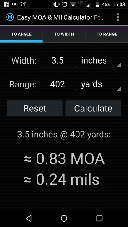

There is a good app to use and learn with:
"Easy MOA & MIL Calculator"
But as others have said, don't think, "I'm 3.5" high", measure it with the reticle, in this case you're 0.2-mils high.
