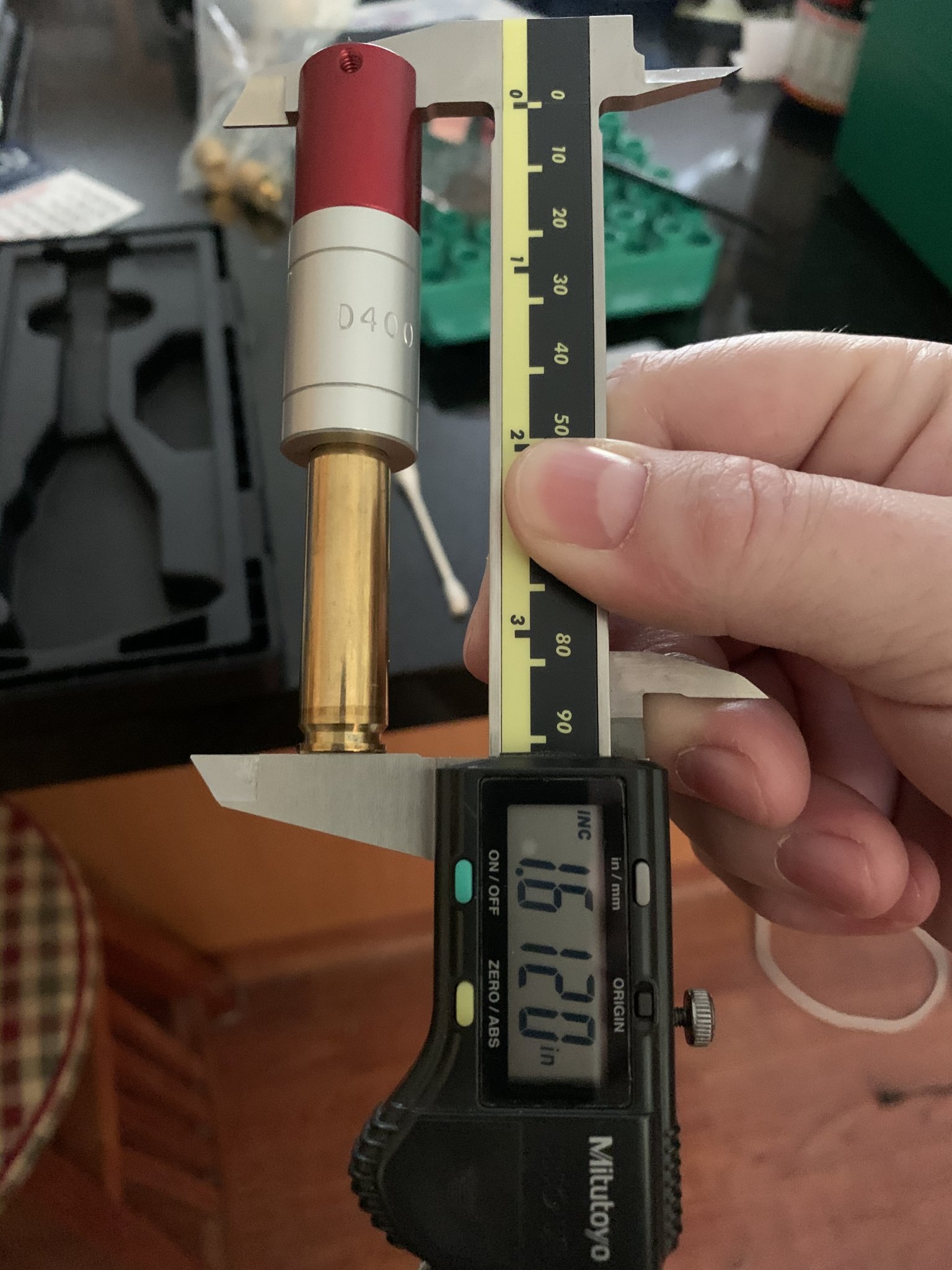

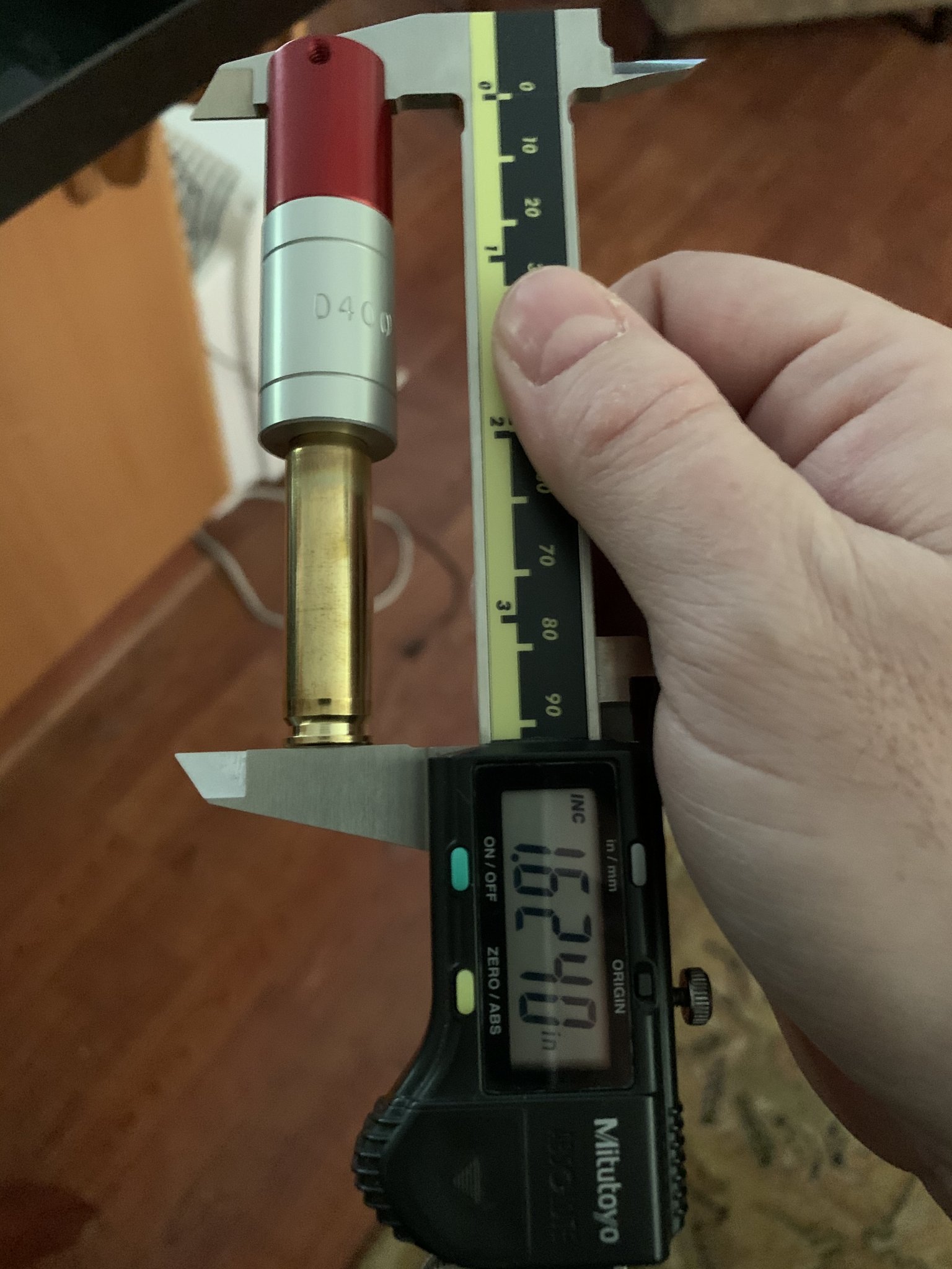

chamber is too short? Help me understand this better please. If factory ammo is SAAMI spec and measures as such in my Whidden gauge. What is the acceptable amount of change in shoulder after being fired? It looks like my brass changed about 6 thousandths which I was under the understanding that was good. Meaning a tight or well cut chamber? That if it changed too much that was an indication the chamber was too big? Shouldn’t the sizing die take brass back to SAAMI ? Which it doesn’t change the shoulder measurement at all almost like it doesn’t make contact with the shoulder at all. Again just trying to understand but I don’t see how that translates to too small of a chamber? Hoping to learn.
You assume factory ammo shoulder is saami spec. Alot of times factory ammo and new component brass has a shoulder farther back than spec. Generally speaking, the dimension that is important to a reloader is shoulder length and diameter at case web. If you are bumping shoulder back .001-.002", from fired length, that is plenty. If it is still hard to chamber than look at case web diameter, is it changing from fired to resized?

Well after some more testing I am sure it is the die. Tried it in three different presses now with the same result of no shoulder bump back. Used a friends RCBS sizing die tonight on his press and mine and was able to size the brass no problem. On the Coax I was easily able to size the shoulder back .003-.004. So will be contacting Forster again to have them correct the issue. Tested the seater die as well and found it works well with only a slight ring in the bullet with no dimple. Think that can just be polished out of the seater die. Would prefer to stick with the Forster does if I can but we will see how this plays out.

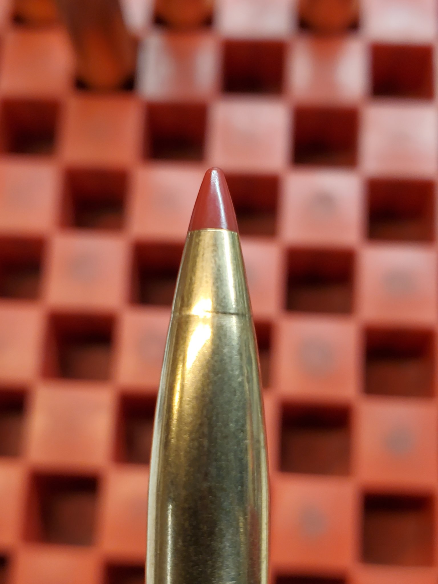

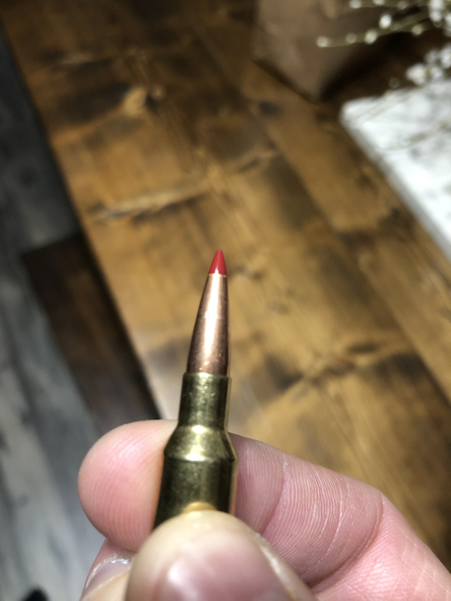

After all the advice and tracking this issue down I think I am going to return these dies and do something else. I am just not satisfied with the sizing die nor the seater which leaves indented rings in the ELD bullets. So will be looking at other options.
Like this?
Check your neck tension and or get the right seating stem for the bullets.
For me anything over .003 creates a ring.
Like this?
I use the stem that came with the Forster & it doesn’t make any marks on the eld, tmk, or hybrid. I usually debur & polish the stems a little, no matter what stem or brand. When loads are compressed it will make a mark even with lighter neck tension but polishing the stem helps to not make marks too bad. The Forster expander Ball usually gives .002 so it’s pretty good. Sometimes I use an expander mandrel & sometimes I just leave the expander ball in, the Forster sizing dies make concentric ammo either way with consistent neck tightness. The Redding small base die I have also is consistent .002 tightness. Occasionally some semi autos need a small base die but most of the time the Forster works on semis too.
