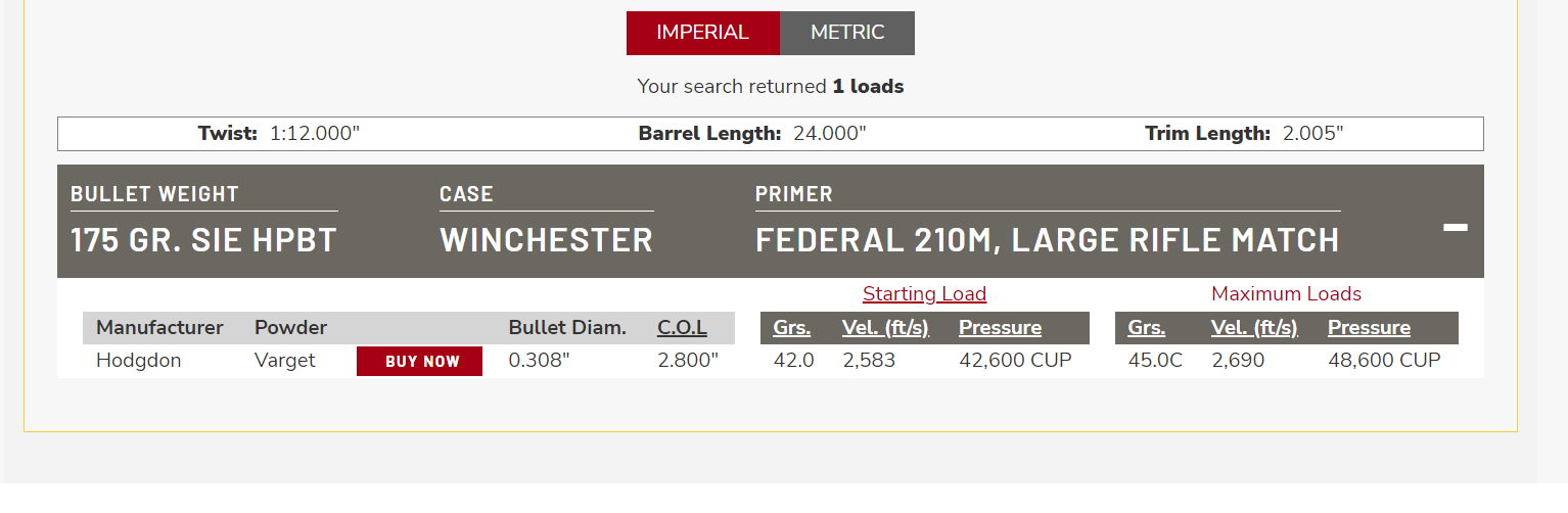

I have done a bunch of digging and found that while many loads would be light with 42gr my 175 SMK are over max per Sierra. There is a lot of conflicting info between manuals. I was using charge weights from a Hornady manual wrongfully thinking the 175 SMK would be similar to 178 ELD.

I think Hodgdon starts their load hotter than Sierra Max load .

Those Hodgdon numbers are what I have always used. Most of my loads with 168-178 bullets is around 44grns of Varget. Never used LC brass but used a lot of Hornady and Lapua. Never an issue. I use Fed 210 primers though and also haven’t used a factory barrel in a long time so thinking it’s got to be something between the primers and barrel/chamber in the rifle. If you can only load lighter than just do it to be safe and just find an accurate load in the lower charge.
