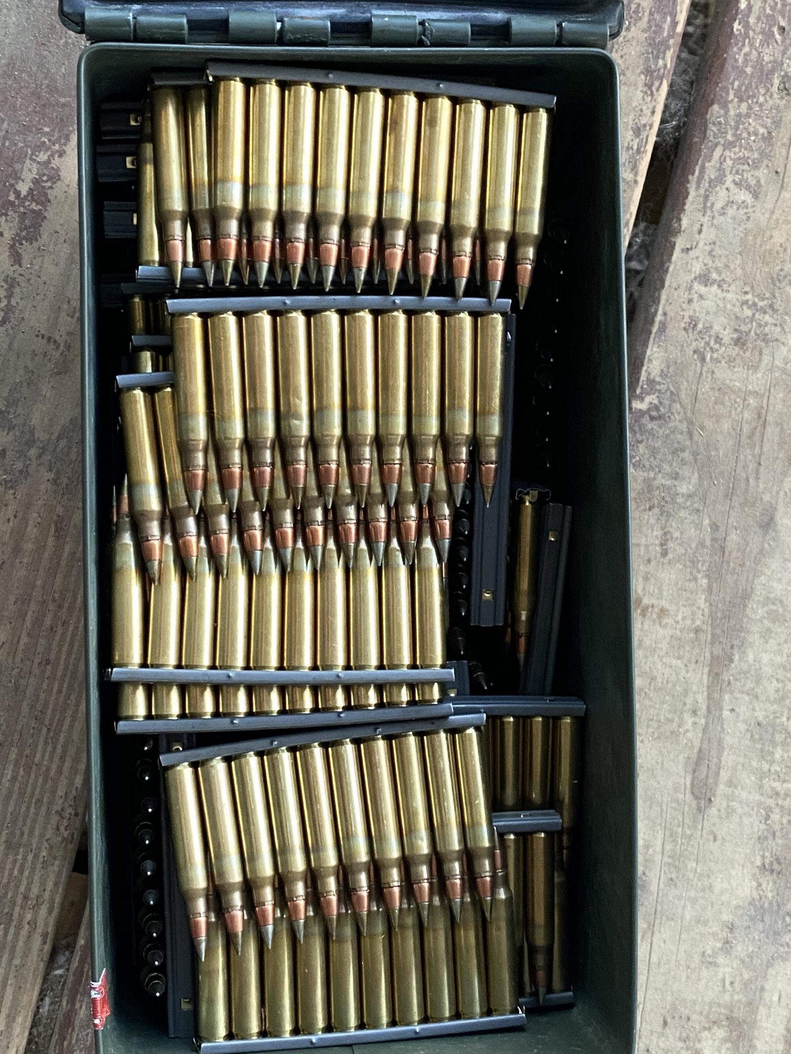

That looks to be Winchester loaded due to the collet crimp. I found some of that and it was more accurate than LC load in my informal testing.
100% concur. I’ve tested both and the Win/crimped stuff is easily 1+ MOA tighter. I have about 2K of that and 4-5K of the LC.
Much prefer the Winchester/Olin. Clear improvement, but not nearly as much out there.
