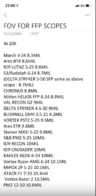

If you are a rifle scope enthousiast, you probably understand the importance of FOV. Either you're a hunter or a PRS guy, it helps you spot animal in the field, targets in your competition, spot your misses and impacts… It also reduces the need to zoom back a bit, clearly it helps you see better! That spec on a rifle scope is often underestimated, and I made that mistake in the past.
So lately, I found that list made by Richard Uting (YouTube, Sharp shooting UK) that I keep as a reference sheet… And would like to share with you today. Mainly, it shows the half FOV of some FFP scopes at 20X in mils. (Note: multiply the numbers by 2 to get the real numbers)

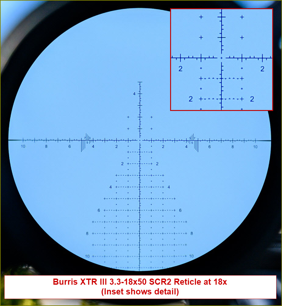

ILya has said the new March 4.5-28x52 High Master is getting 23 mils FOV at 20x, but this is a concept scope that hopefully will be executed extremely well and be a top alpha option when it is released. March is using new wide angle eyepieces in their recently released 5-42x56 High Master scope and this new 4.5-28x52. Outside of that, the NF NX8 2.5-20x50 and Burris XTR III 3.3-18x50 both have very impressive FOV, so does the Schmidt & Bender 3-20 scopes. I can't really recommend the NX8 2.5-20 because it has considerable edge distortion which IMO limits the usefulness of its FOV, but the XTR III has impressive edge to edge sharpness for a scope at its price.
Here's a pic of the XTR III at 18x, it looks to be about 11.3 x2 = 22.6 mils FOV at 18x, very impressive!
I like what I see so far! The picture talks by itself! Thanks! The reticle is slim and well graduated. FOV is in the alpha territory. I'll put that one on my check list.
