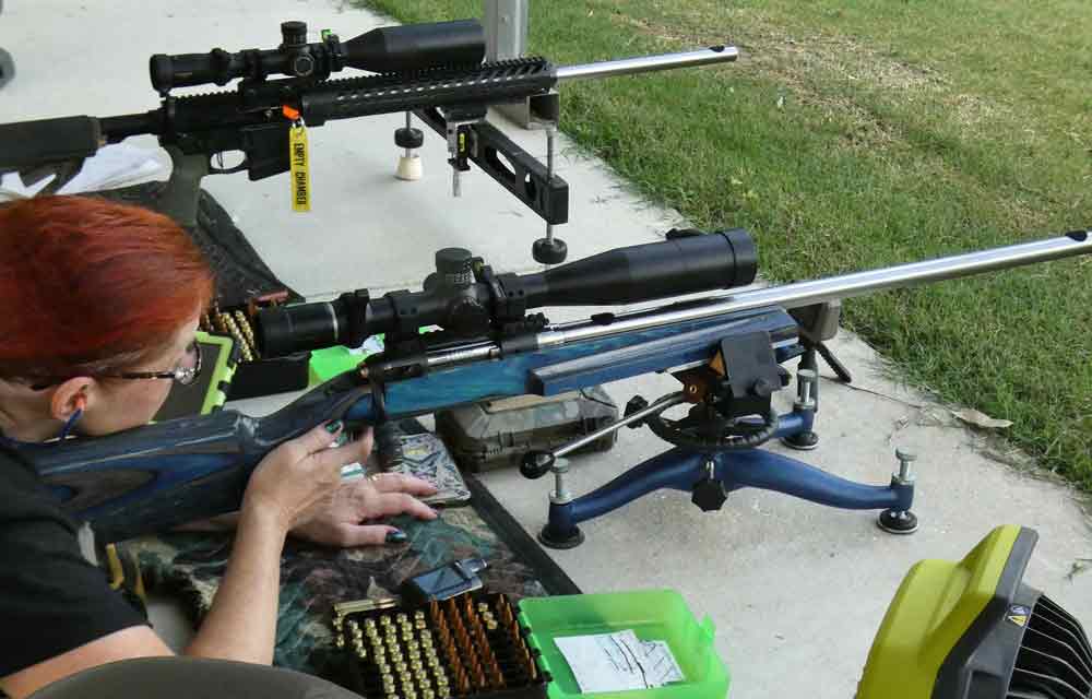

I am debating about putting a Shadetree top on a Caldwell Rock BR. I already have the Caldwell, so the additional cost would be approx $425.
Is there a better, cost efficient way that I can go with other than the Shadetree, whether it's just a top on Caldwell or an entirely new rest?
It needs to have a joystick and the intent is F-Open. I am aware about the variations of SEB but there are super over the budget.
Thank you
Same setup for the wife's gun.
ShadeTree top on a Caldwell base.

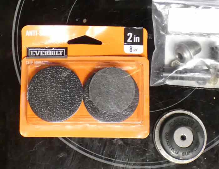

One issue my wife had with the Caldwell rest was when returning to battery she would push the rest forward a fraction on an inch.
If she was close to the edge of the concrete "round down" she would have to readjust elevation.
I used a black marker as a monitor to show her. If she pays attention and returns the rifle to the stop, OK. Set up a little further back on the concrete, OK.
I epoxied steel fender washers to the feet then applied stick on antislip pads (HomeDepot). FIXED.
