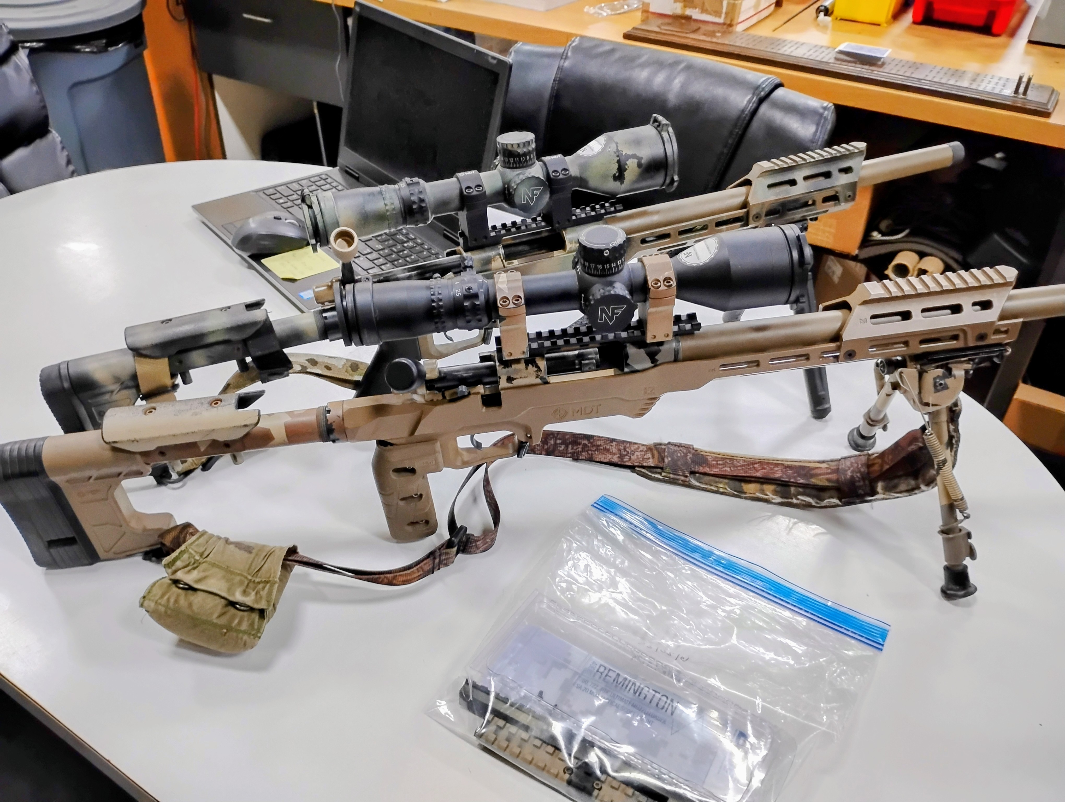

FUBAR times 6!

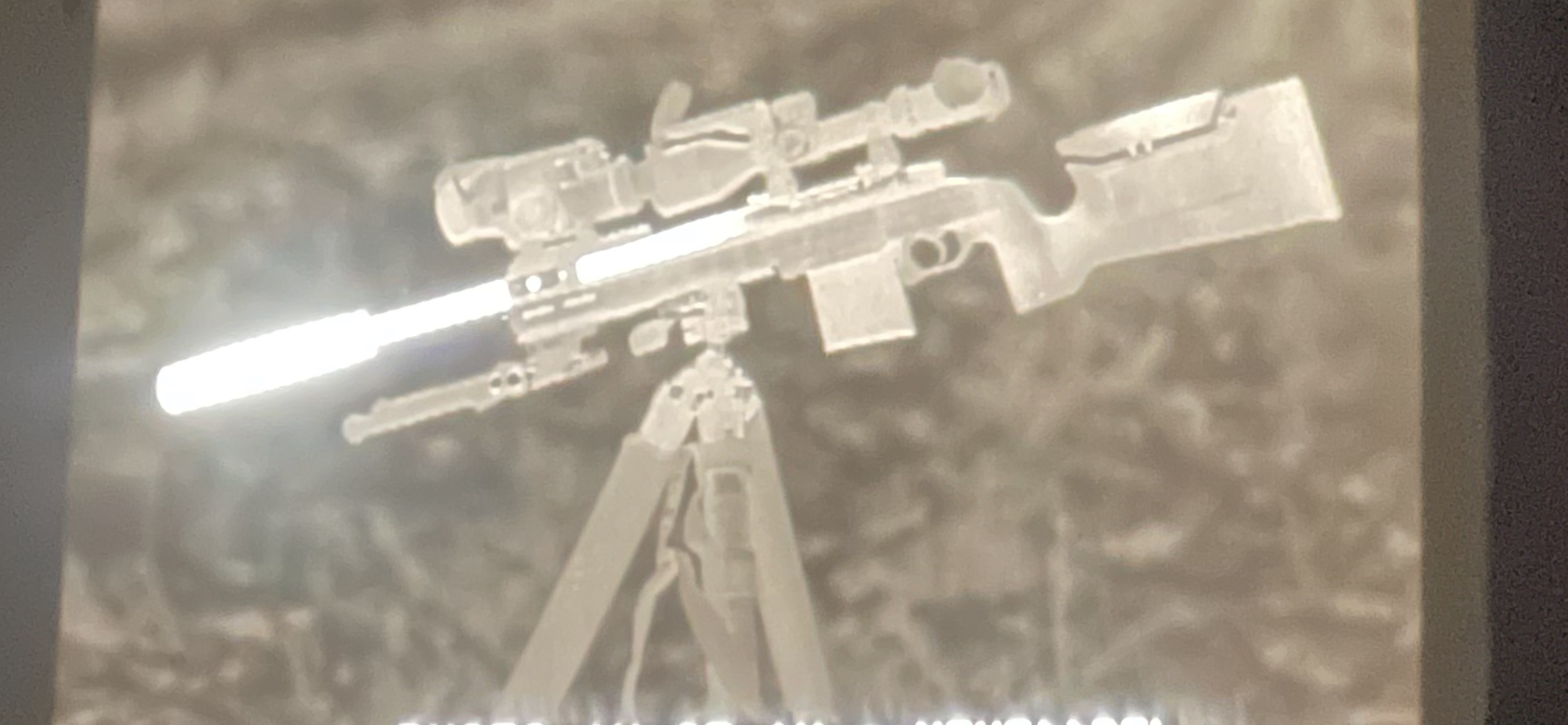

NV mounts installed backwards (yes doesn't effect accuracy but it's attn. to detail is my bitch there)

Most forward mounts are designed to reverse the top hemisphere if needed to close the gap between the day optic. That being said if the barrel contour is barely clearing, flipping the bridge will result in the damned thing conflicting with the barrel due to the increased taper diameter upstream from the mount. Maybe that's what was happening with the awesome lightning sticks mentioned above.
The KMW MUNSter is designed to do that and a bunch are ran in a reversed fashion with shorter scopes.

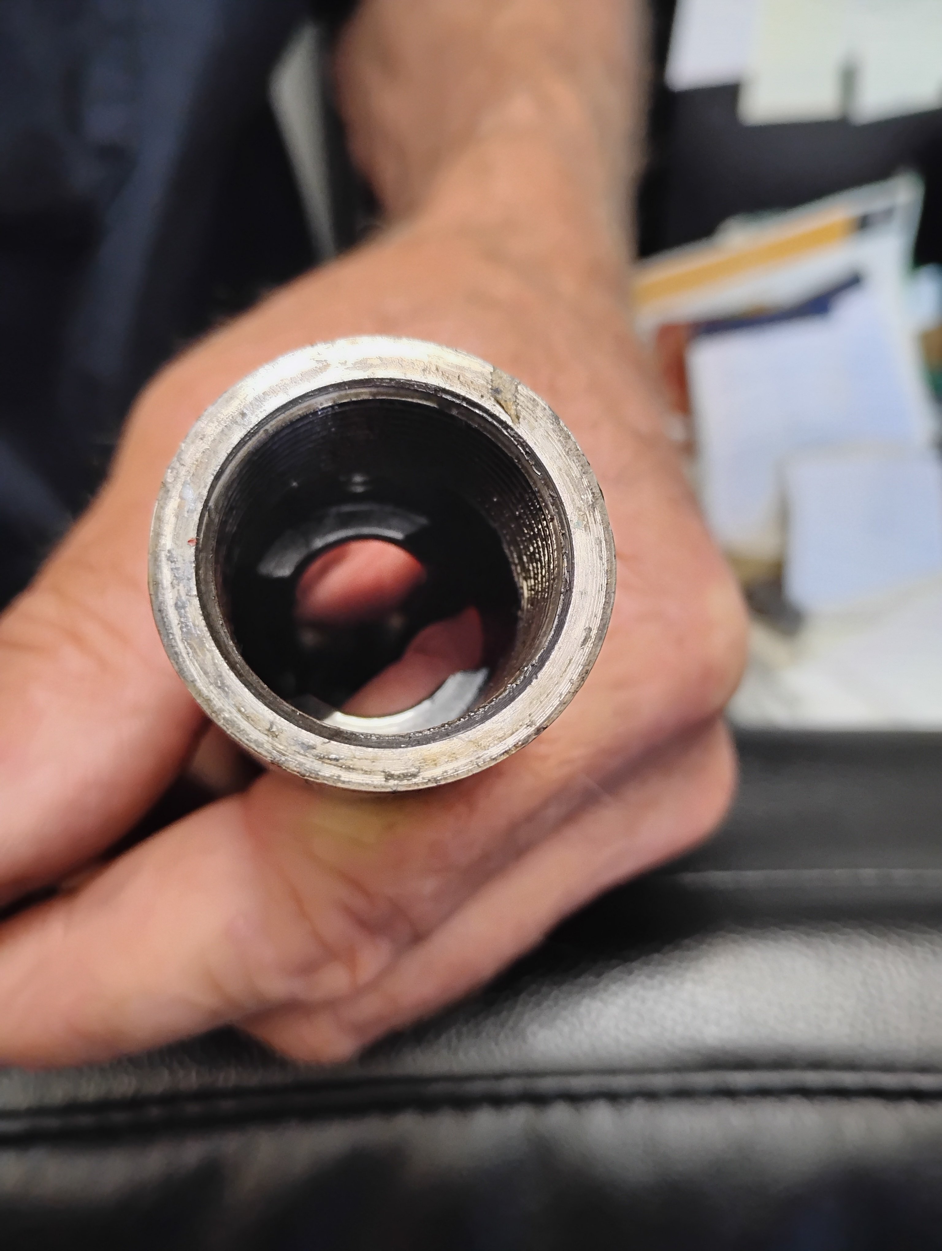

It's that mark/indentation up at 1 o'clock position. I knew I took a picture of it. LOL!
That's a new feature. You can easily adjust the headspace by changing the amount and thickness of the chips and have all the peace of mind of a shouldered and torqued barrel without having to resort to a barrel nut.
You can even compensate for that reverse canted scope mount by putting additional/thicker chips at the 6 o'clock position on the receiver face to push the muzzle up.

One of the 4 guns we actually cut some of it off. It was hitting the receiver when you closed the bolt and didn't want it interfering at all with the bolt closing.
So yes... we're watching all the little stuff as well.
