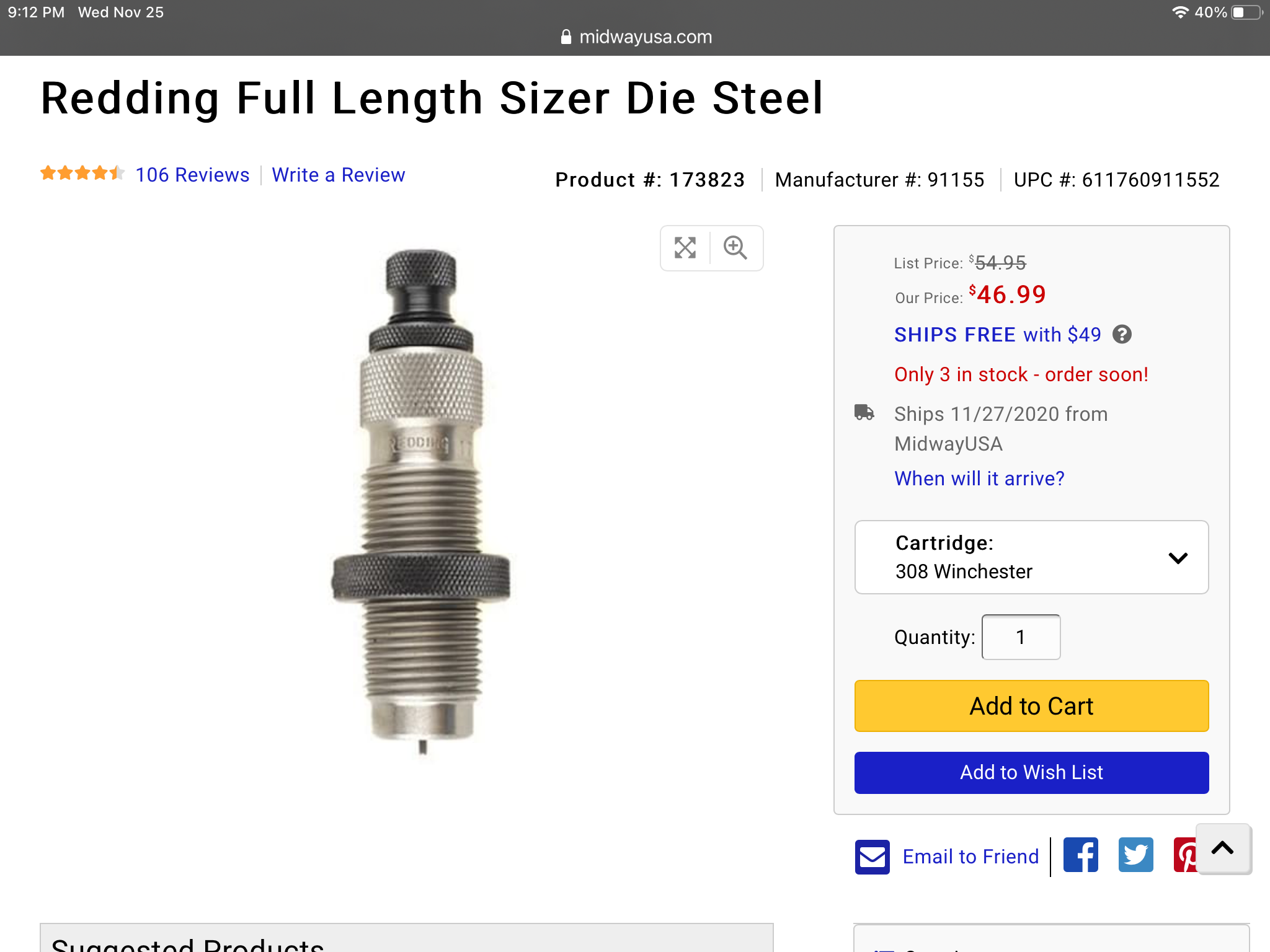

For recreational AR 308, Redding full length should you very well.
on the economy end:

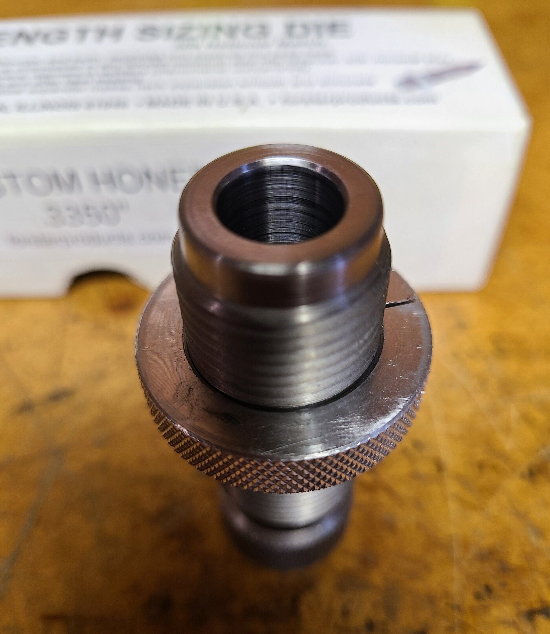

AS far as MA or SAC dies sometimes you DO get what you pay for.
It seems that demand for Forster dies seems to have overwhelmed their production capacity and decreased their quality.
I bought this Forster 308 NM die die from an online retailer then sent it to Forster to get honed, so they let it slip by when they made it then again when they honed it. Guess it meets their finish specifications.
I never looked at it before sending for honing but that is a poor finish.
